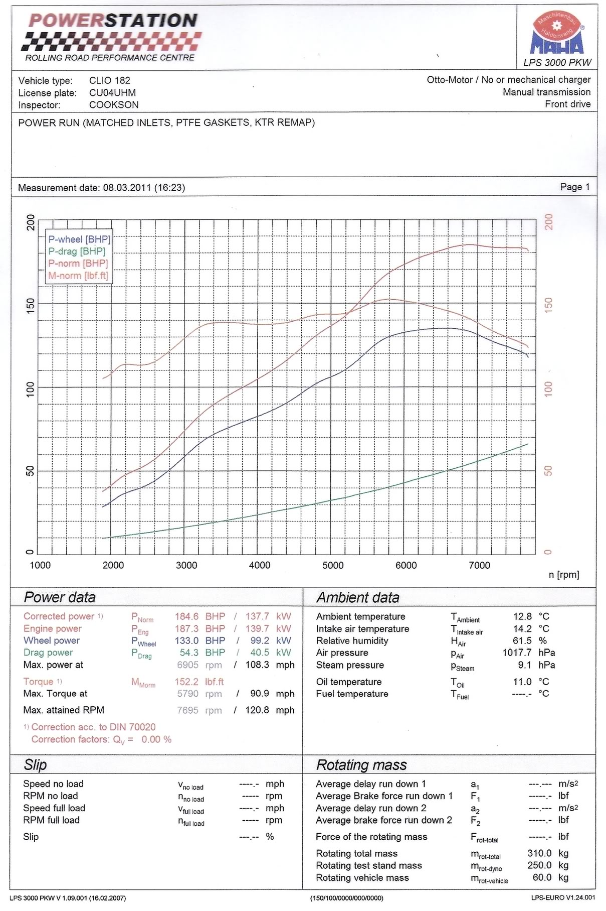

im going for 428's and a custom map at tour de force 1st feb so will post my results up this is mine at the moment with a ktec map on matched inlets

powerstation's RR, they always show HUGE losses through the trans, is that just a MAHA thing?
Agreed, my mates escort lost over 200bhp in the transmission when run up there, LOL
Would f**king melt the cogs if it was losign that much heat in the box and diffs I would think!

ive always used power station for all my cars i do trust there rolling road

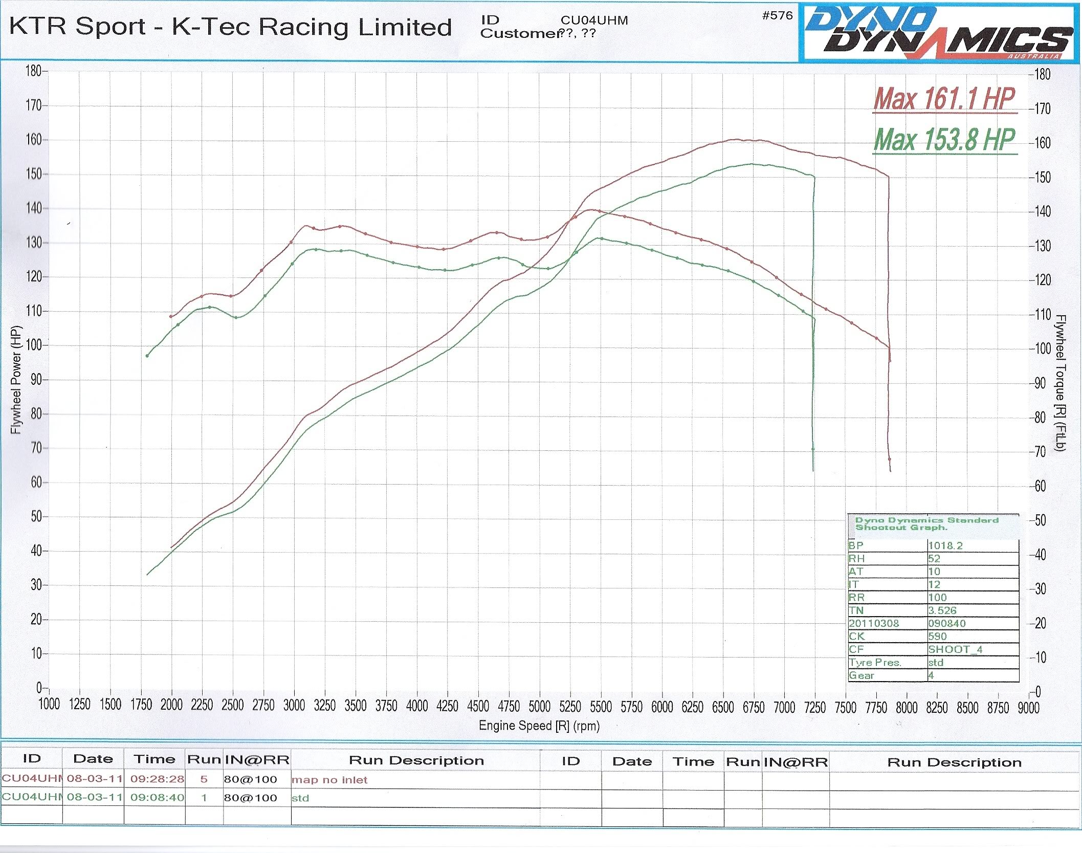

this is ktec's print out on there old rolling road

Ktec seem to have a nack for getting very low "before" figures, 153 and only just over 130lbft, did they not remember to go to full throttle? lol
Was the cam timing out or something?

Weirdly their flyhweel figures seem to come out about right, so it seems like their at the wheels roller figures are out by a similar percentage to the ridiculous transmission losses!

i had a proper falling out with ktec they never gave me the print out after the matched inlets was fitted they mapped my clio before fitting the matched inlets and they never gave me the final result andy cutlaw promised me a free remap when they had there new rolling road installed but it never happened after spending £700 in one day so much for customer service will never go back there again

Thats not good to hear and why on earth would they spend time mapping the car before it's had the mod its gone in for! I don't blame you for not wanting to return mate. I'm sure TDF will look after you you will get an accurate RR figure before and after which you can use as a comparison rather than a before from one RR and then the after from another. Good luck with it anyway and let us know how you get on :)

It is a MAHA thing, Fred. I use PowerStation as my local dyno for gauging effectiveness of mod's and enquired as to why the apparent huge losses. I cannot recall the technical reason behind it off the top of my head but it does make sense and the readout suggesting the huge losses should not be interpreted as perhaps would be on, say, a Dyno Dynamics. If I can find the literature I'll post it up sometime.
The only thing I found with PowerStation is that the rollers were a little on the generous side but they seem very consistent. I just wish you and TDF were a little closer to Wales... *sigh*
