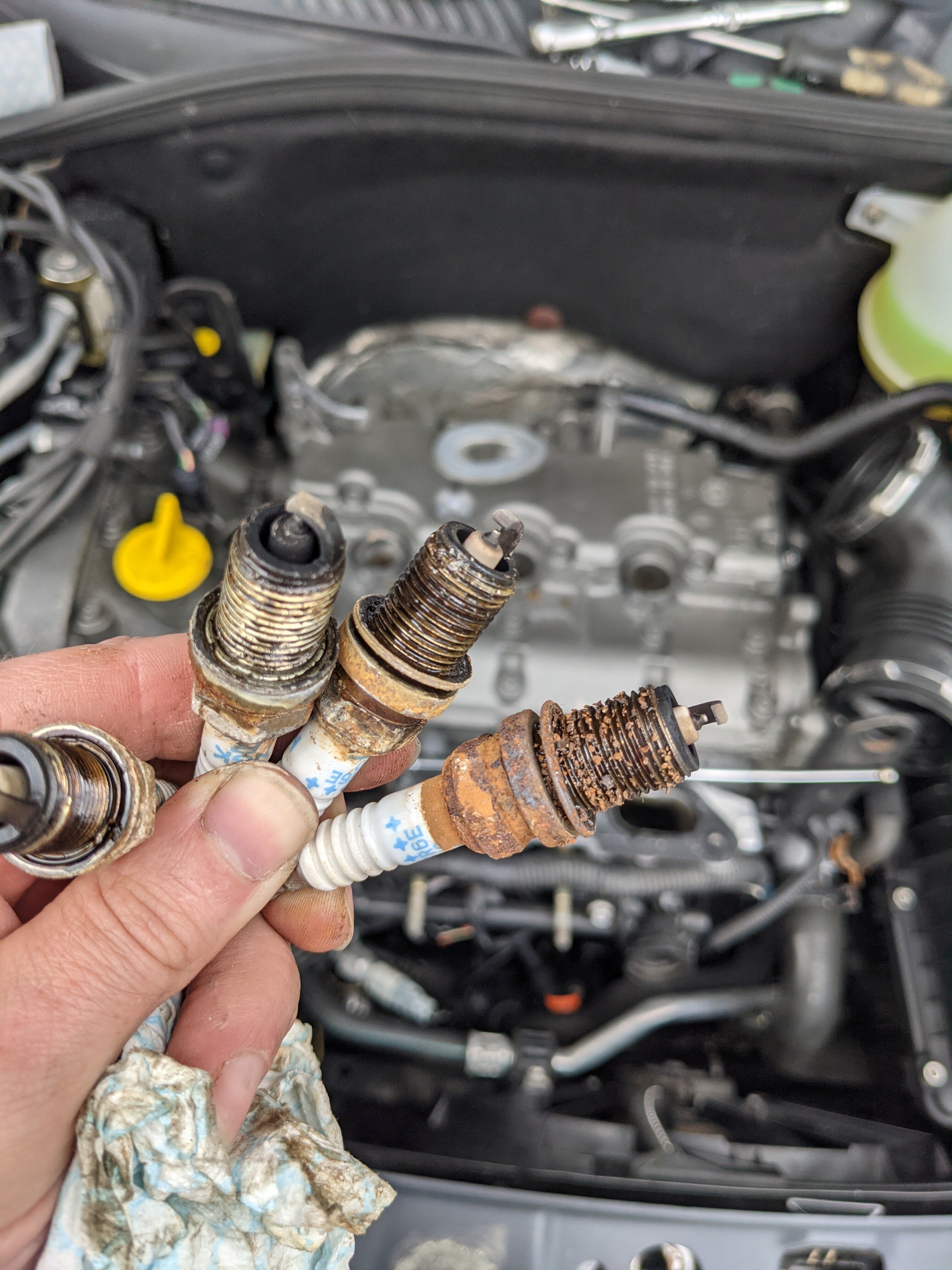

Thanks for your help guys! Started up the car this morning and light is still on but running normal. I’ve ordered up new NGK plugs and will fit this weekend 👍🏻
Robbie Corbett
I went through this last weekend. Was slightly damp down plug holes.
Inlet is under 10mins to remove. Don't leave it even if no miss as the plugs rot, so the next time you remove them all the s**t shale falls into cylinders.
I've washed bay twice, plugs were 6months old, took ages with a dyson and neo yo get all the crap out.
Robbie Corbett
Also - in the future if you have a missfire like this and absolutely HAVE to drive the car go round unplugging the injectors one by one until you find the missing cylinder, then leave it unplugged for the journey.
For 100miles you would have had petrol going into one cylinder and not firing doing nothing but send the fuel trims mad and washing all the oil off that bore.
