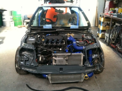

You unplug each injector on the injector.
Crap picture but you can see under the top plenum the little circle which is on the end of the fuel rail (it won't be on ph2's) but this is where you unplug the injectors.
