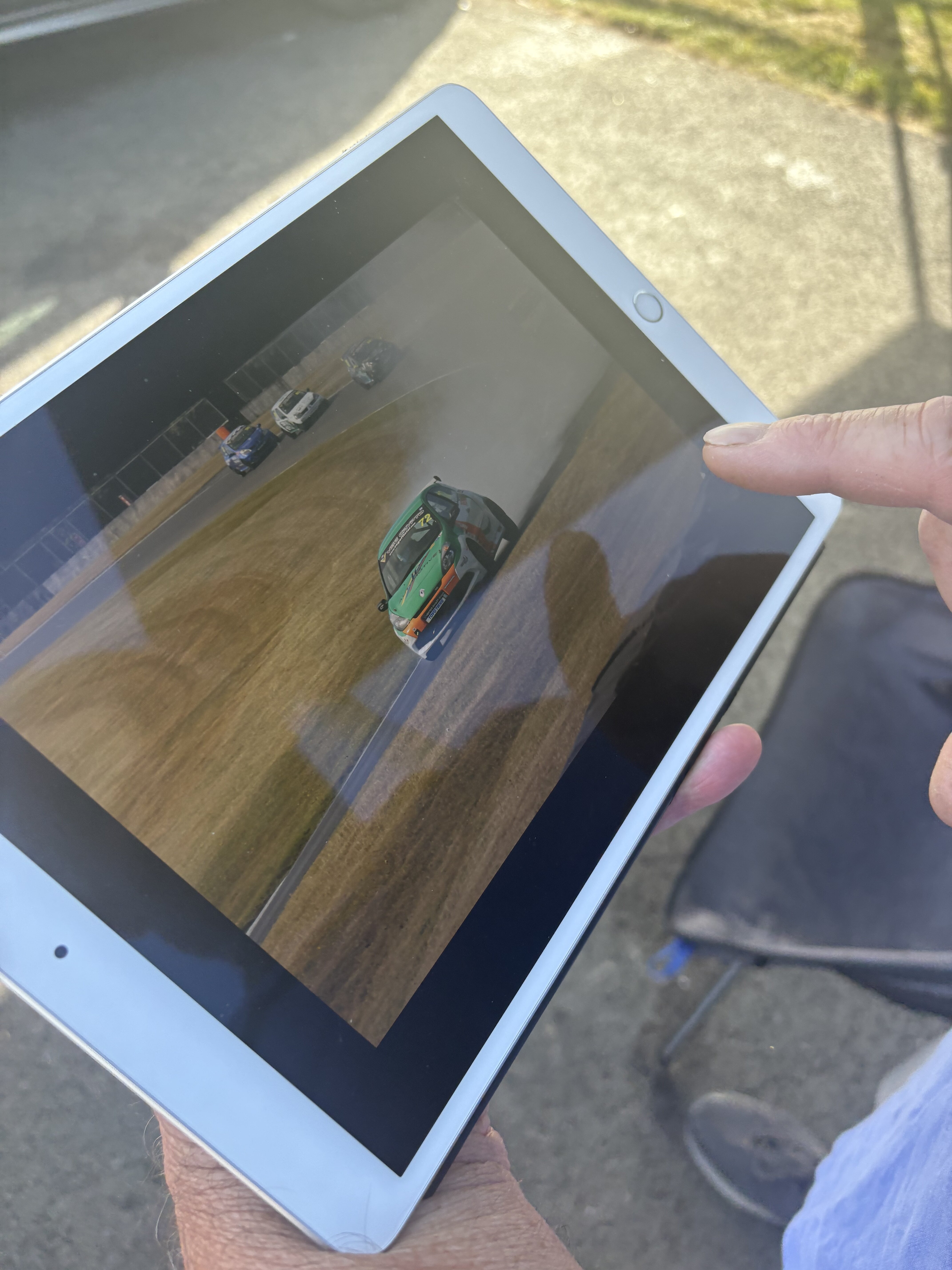

I have a Clio 200 which i race in the Clio sport championship. They are basically standard cars with race pads, cage, spax dampers and a black line diff. Everything else is standard
My car is a 53k motor and had arp Conrod bolts at the start of the season with the oil changed after every meeting. I am running millers oil 5w-40 + nt
Unfortunately the engine decided to go bang with white smoke on Saturday whilst leading. It’s blown a rod out of the bottom end..Not ideal..
So will bolt in a spare motor but just thinking is the oil too thin when everything gets so hot especially with the summer temps this weekend..
So interested to find out what other oil people have run and why please?
Onboard from Saturday if you want to see it explode in real time Race 1 onboard
