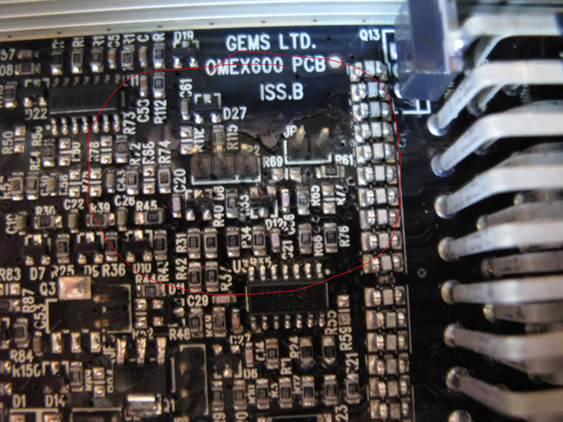

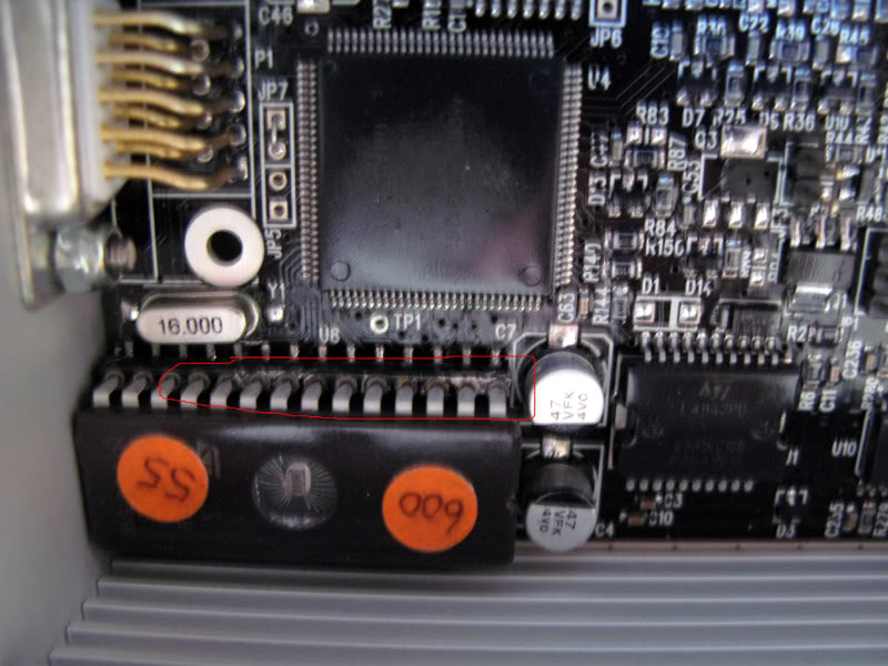

Regarding the damp etc. I'm suprised Omex don't use a conformal coating to protect the board?
where the hell is it mounted to get like that?
cant say ive ever had water inside my engine bay in any car ive owned to cause damage like that, id be a little concerned as to how the water is getting in and why
