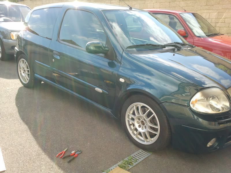

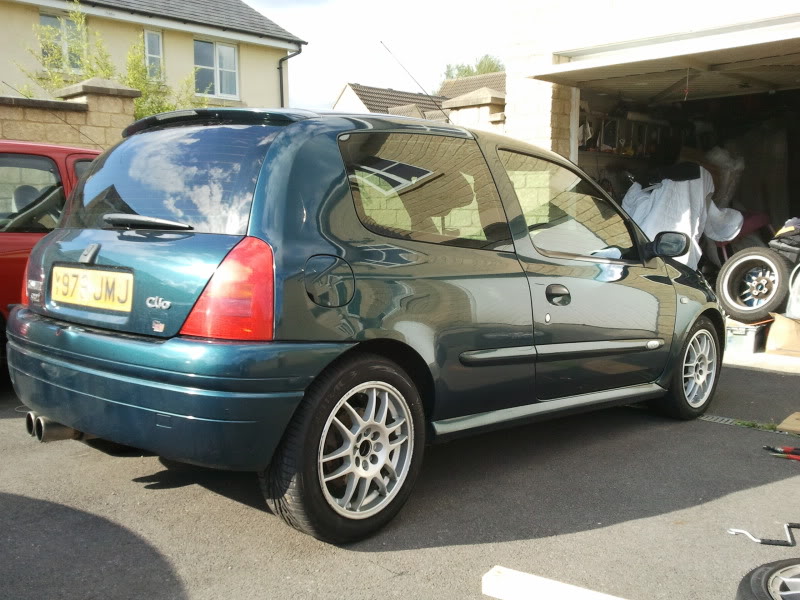

Small update, got my wheels on :)
Still a bit high at the back, but it has helper blacks on the rear springs, so need to pop them out and have a look at some point

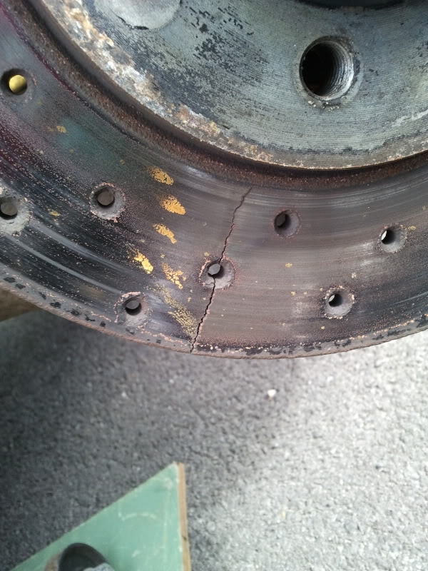

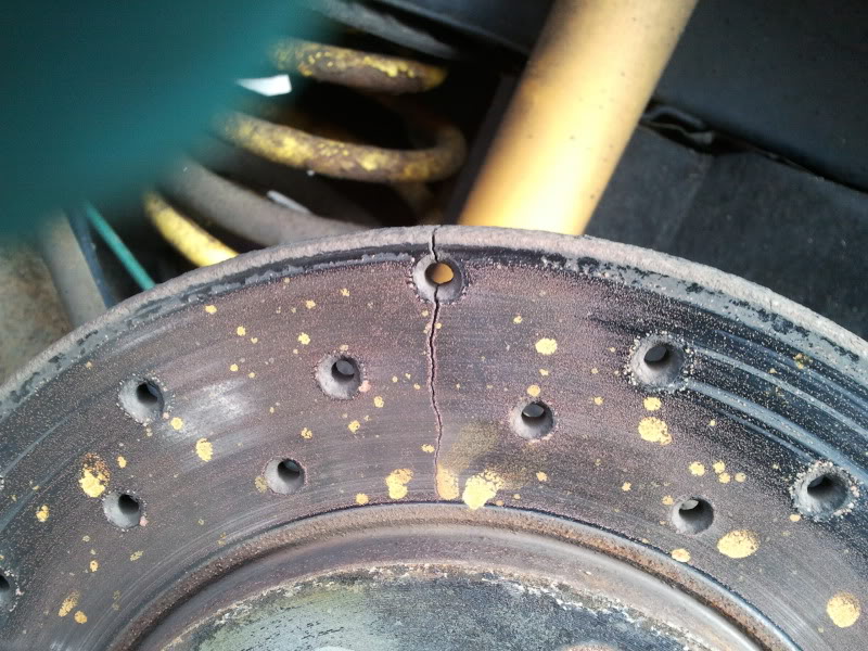

Knew about one crack, but didn't know about the other!

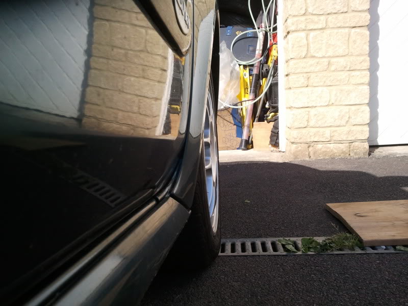

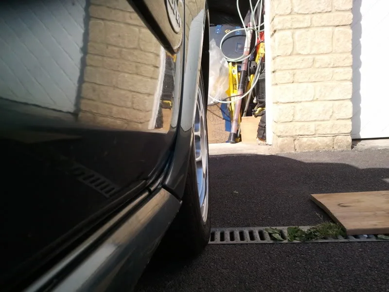

Nice camber at the front now, not over the top:

Agreed Danny, I have to say I prefere grooved over drilled, though a standard set will be going on the back now, iv never felt the need to go uprated on the back :)
  Evo 5 RS
eek, I had 3 sets of those that did this, although it was marginally down to it sticking slightly.
Like Danny says though they're just gash! No point what-so-ever drilling discs that skinny! Car looks a lot minter on the f1s

How much camber is that Russ?
Currently running about 2.3 on mine so going to wind some off this week front tyres were trashed in less than 10k!
Not sure mate, ran out of time today lol

Wheels make the car look so much better than before. I bet it drives a bit nicer too?
Lovely disks;) I thought cracked disks normally refer to a hairline crack running across them, you could get a screw driver in that and prise it open:) good excuse as any to get some standard items back on there.

New ones on the way, don't worry chaps ;)

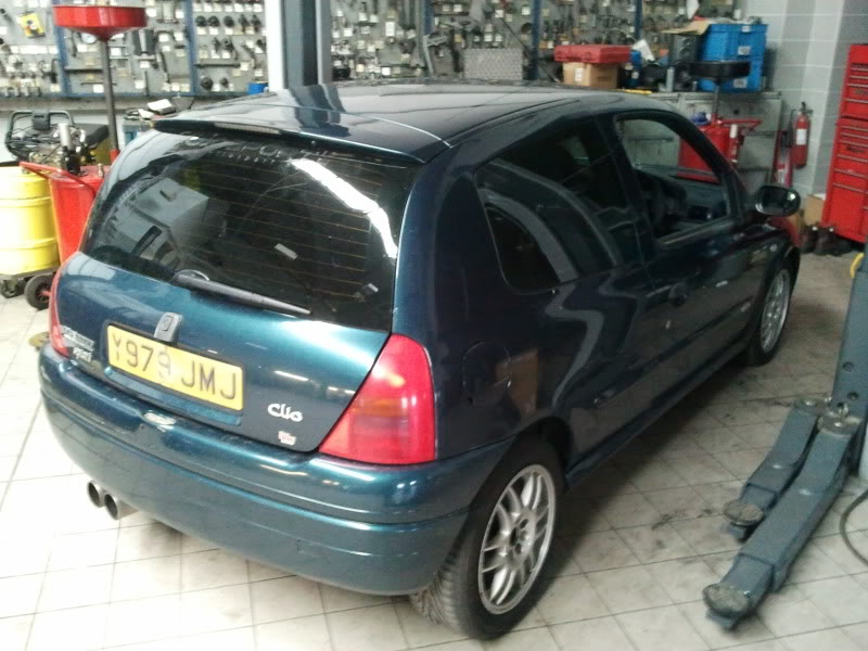

Well had the Clio on the rollers this morning, made good power but low torque (185bhp / 153 lb ft torque) which I think it down to the map - AFR's were all over the shop so will get that sorted soon.
Popped over to work to change the rear discs and pads, and the threads pulled out the drivers side rear caliper (The lower hole where the slider bolts to the caliper) so looking out getting a new caliper now, so I chucked the wheel back on so i can wheel it out the workshop on Tuesday, but gor now I left it there:
