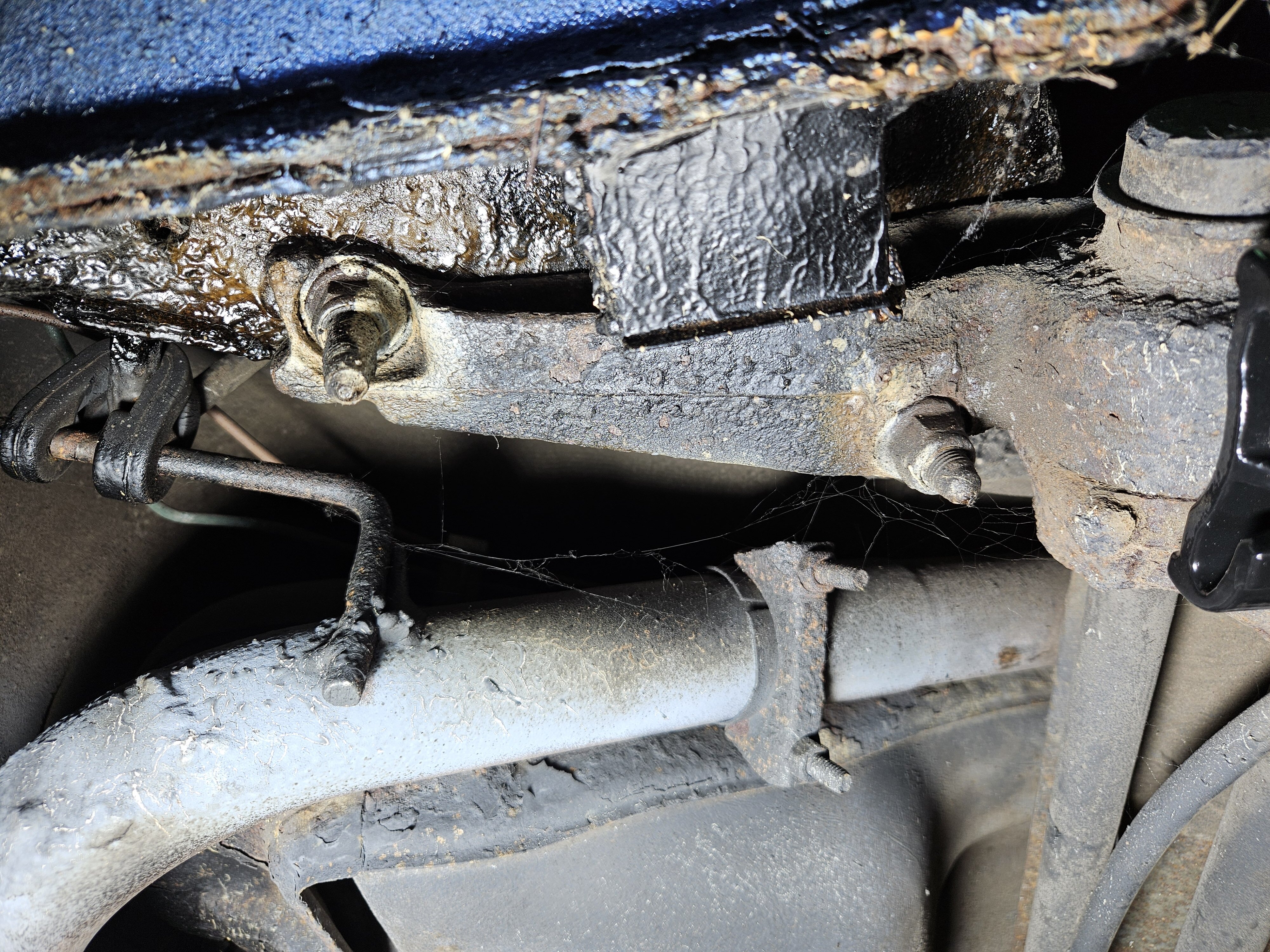

From what I've picked up on the forum, I was thinking of this for the chassis rails:
  • Wire brush
  • Surfex-HD
  • Deox-gel
  • Stone chip paint

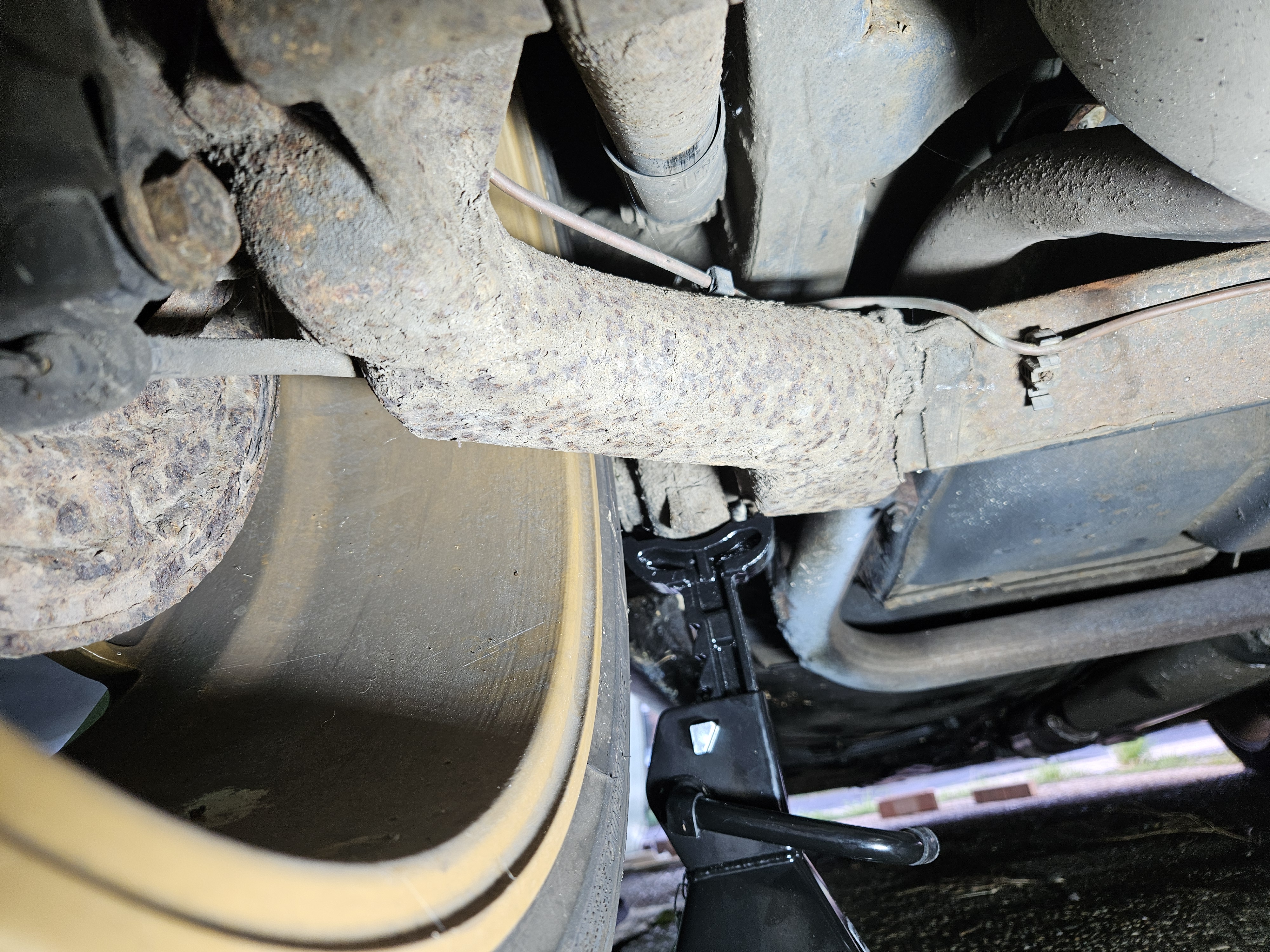

Would you do the trailing arms and rear beam too? They're not looking awful, but, not great.

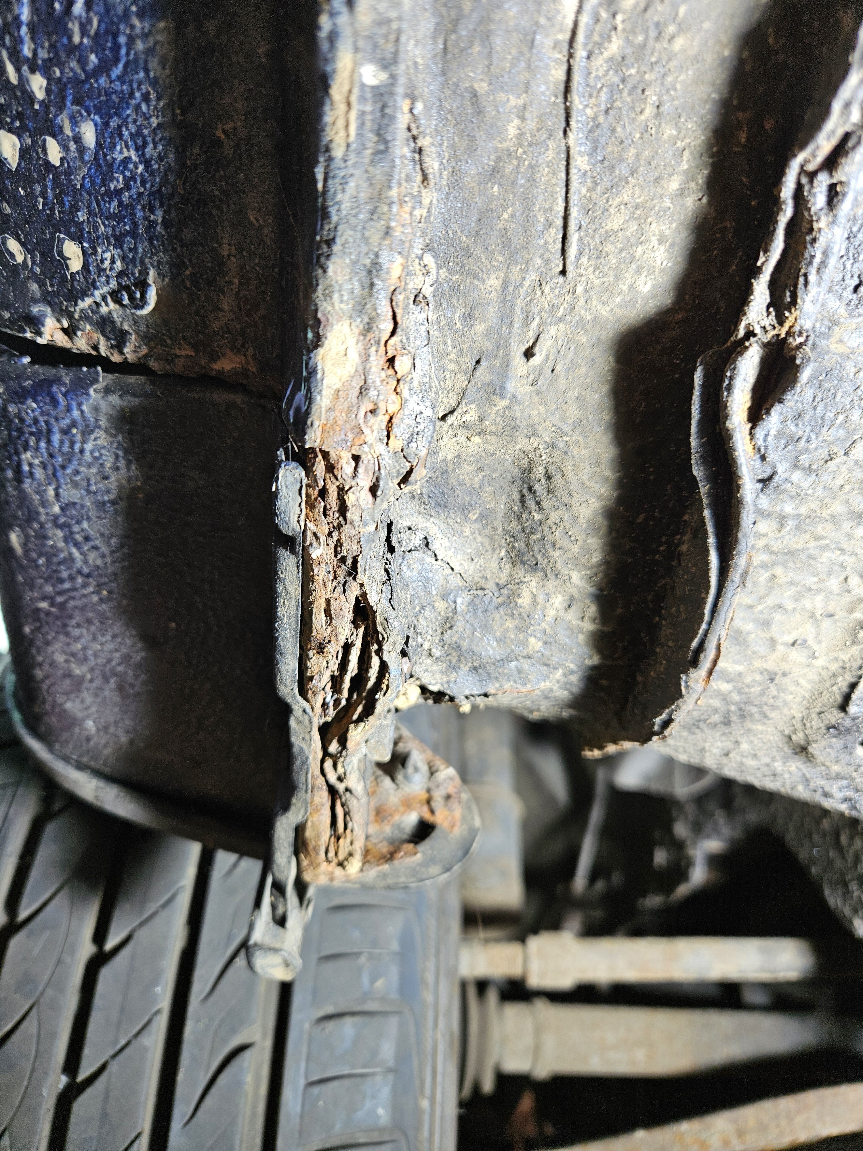

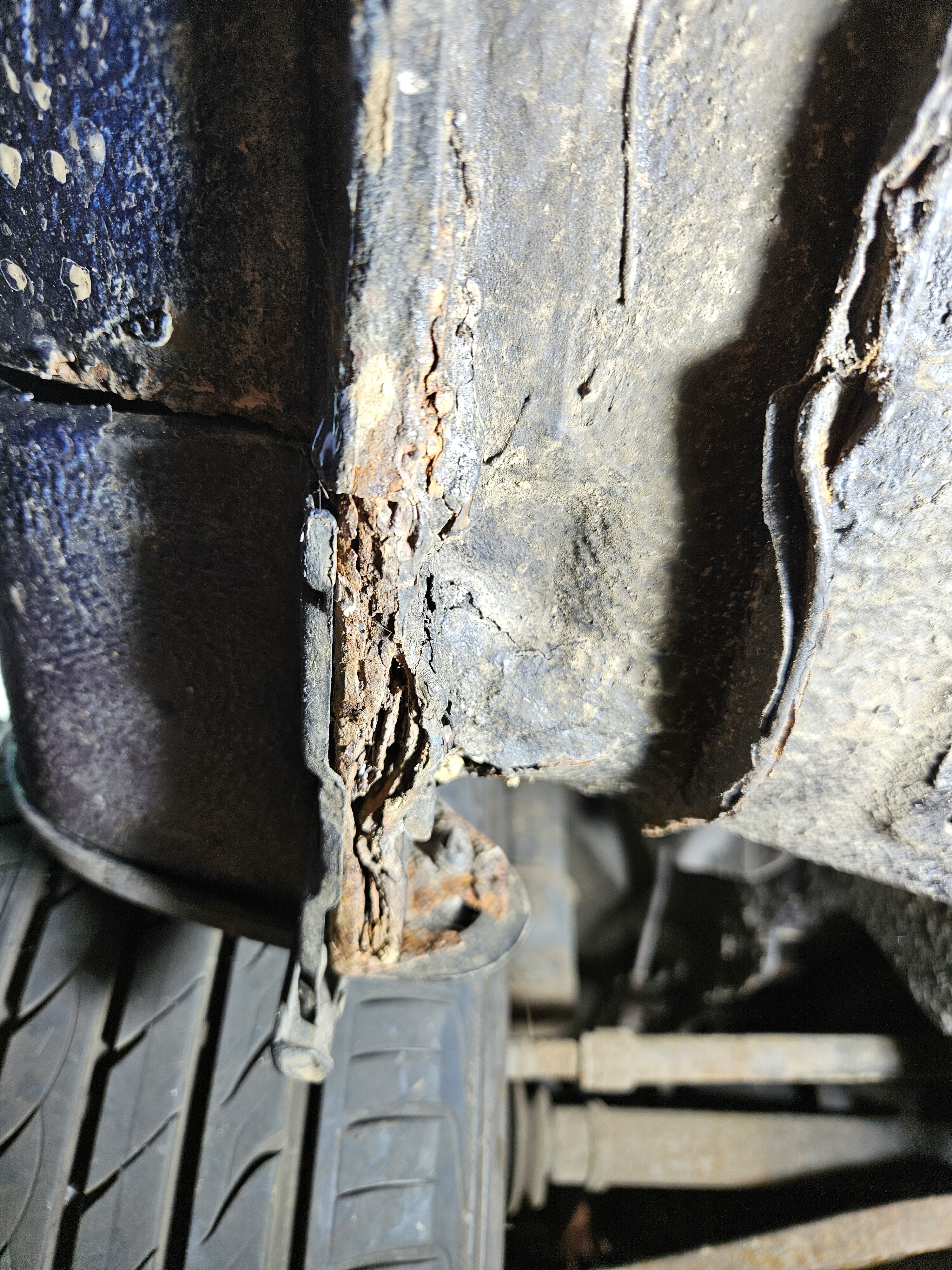

The front arches though... Once I start getting rid of the rust here, I suspect there’s going to be a massive hole. What’s the best way to start tackling it?

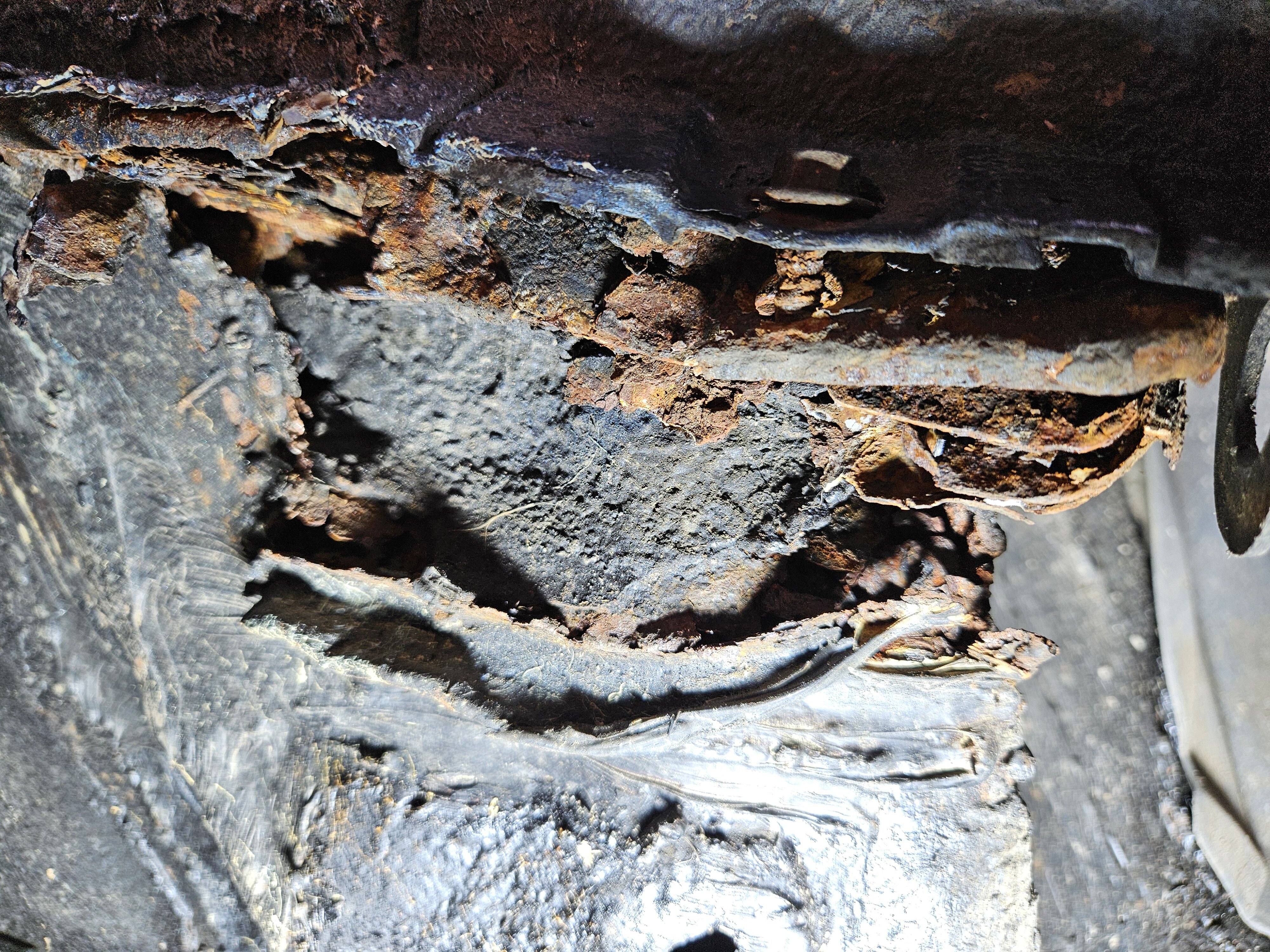

In a lot of places the sills have started to separate. Apologies the photo is a bit out of focus. Is it possible to try and treat it with some Bilt Hamber bits or am I better off digging it out and finding a welder?
Get yourself a pack of wire brushes, a couple of large and small drill attachments with wire brushes, and ideally a needle gun too.
Take as much stuff off the bottom of the car as possible. Rear beam and fuel tank definitely need to be removed.
Attack the lot, then see what you’re left with and go from there.

There's a lot more work than a wire brush and some snake oil rust products required there unfortunately. If you're not up to speed with welding/body repairs I'd start getting quotes from some body shops that specialise in restoration work. There's nothing stopping you stripping the paint/underseal off with a knotted wire wheel on a grinder to see the extent of the rot first.
The rear beam is a straightforward remove, strip down and get it blasted and powder coated job.
Remove as much rust and old paint/sealer as possible with wire brushes and drill attachments. You need to find the border areas between rust and good metal before you can make a full assessment and get costs. Some areas may not be so bad but expect to find some problems that you haven't seen yet.

You need to be quite picky when it comes to finding someone to do the welding.. Most crash repair/volume work body shops won't be used to rust repair/restoration work, and you definitely don't want it done by someone that does 'MOT welding'
The last thing you want is to pay good money to end up with pigeon s**t patches under filler and some shiny paint and underseal
