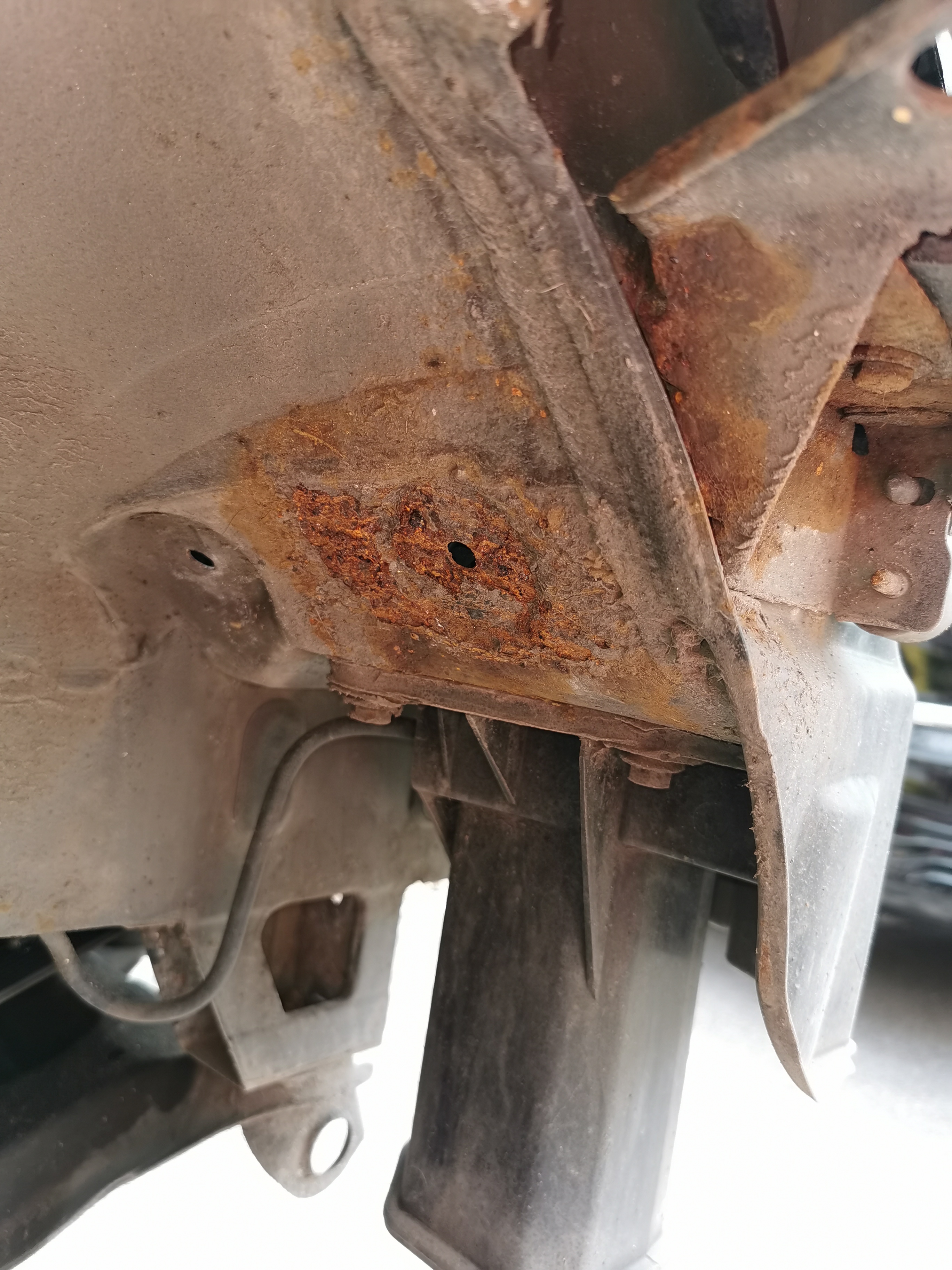

Is Bilt Hamber Dynax-S50 all that's needed to protect the jacking points when they have been straightened? There is obviously some rust on them at the moment so when repaired they need protecting. I was thinking about using this S50 and then spraying some Hammerite underbody seal over the top just to tidy it up. The S50 will also be used on the inner arches when I get the panels off.
Thoughts?

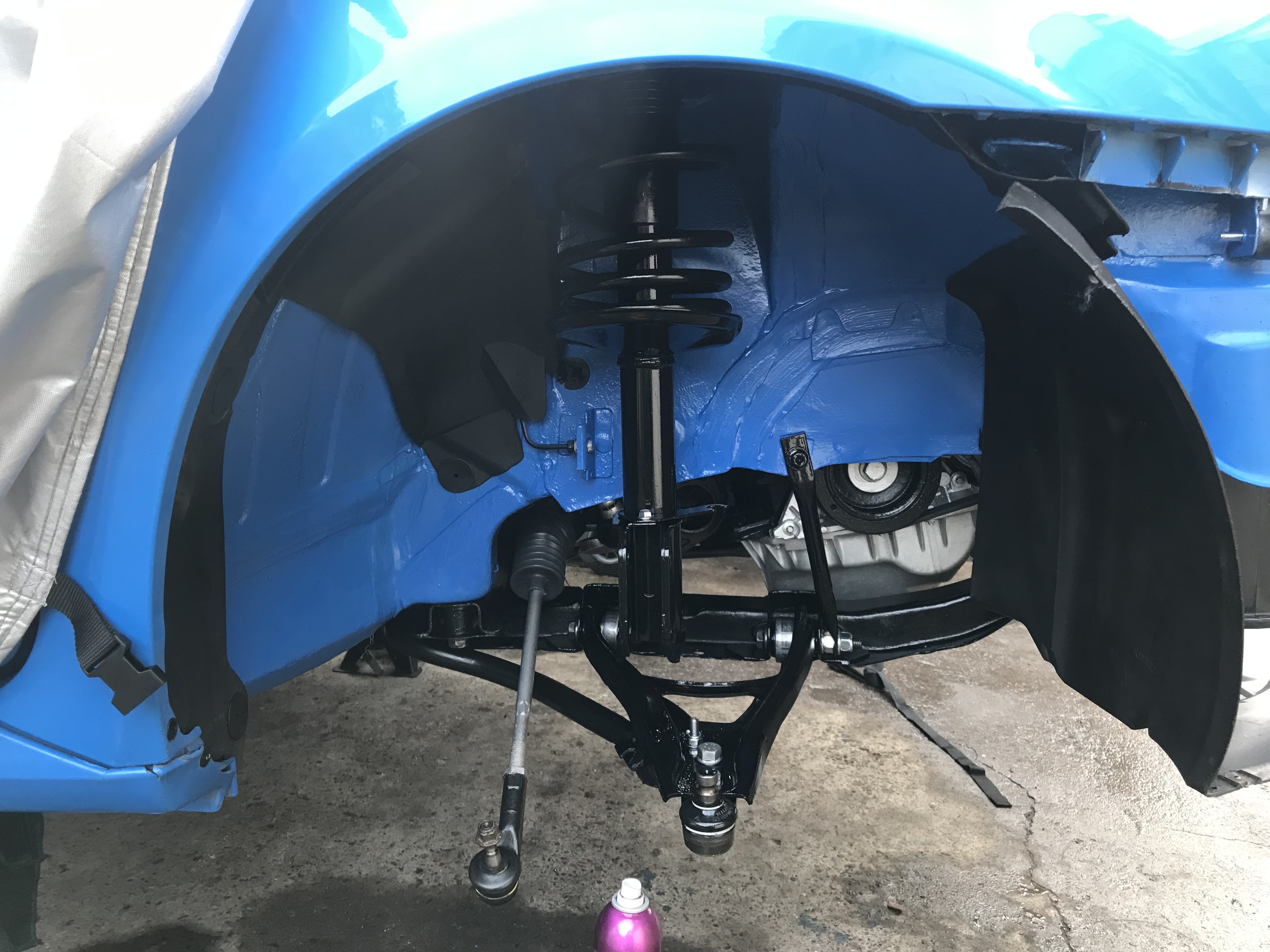

Very common for them to rust behind the canister. Same process as before. Wire brush down to metal and build back up with degreaser, hydrate-80, primer, 447/UB, then a lick of paint. Picture of mine when I did under the arches and it’s still holding out nearly 4 years on.
