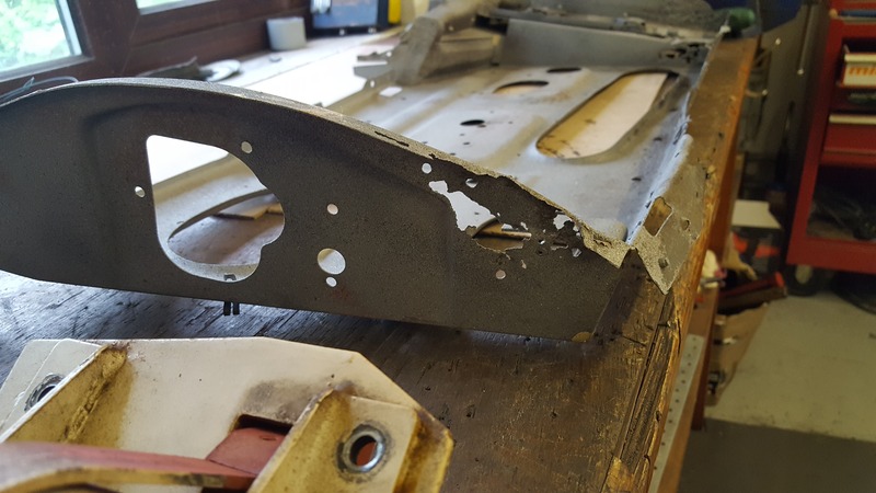

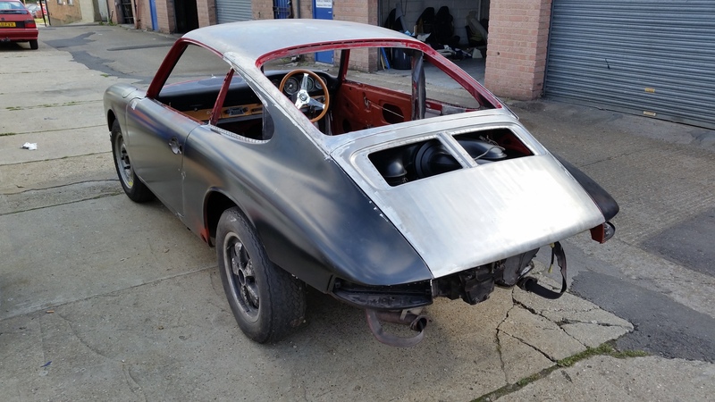

If you were to cut out make and weld in a new arch could take a days work to get it nice. You do it too quickly and you'll have loads of distortion and a ton of filler to try and put it right!
I've been restoring cars for over 22 years and it's always worse than it looks!

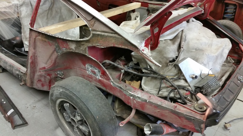

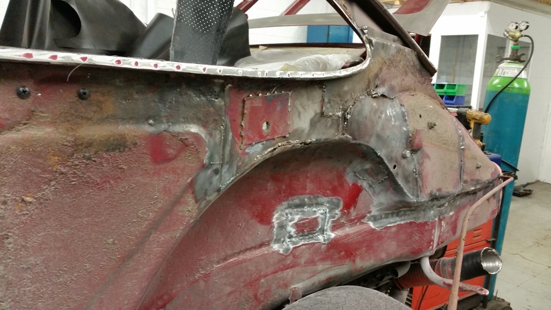

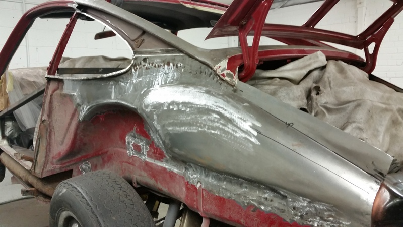

At least it's nothing like this restored patchwork porsche I did a couple of years back!
Work is outstanding .. fancy another job :p

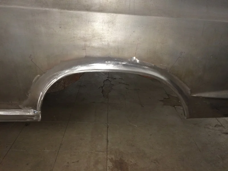

Just make sure whoever does it butt welds the new pieces in. Not joggled and over lapped as it can be a water/damp trap as you can't really seal it properly from behind!
And waxoyl it afterwards!

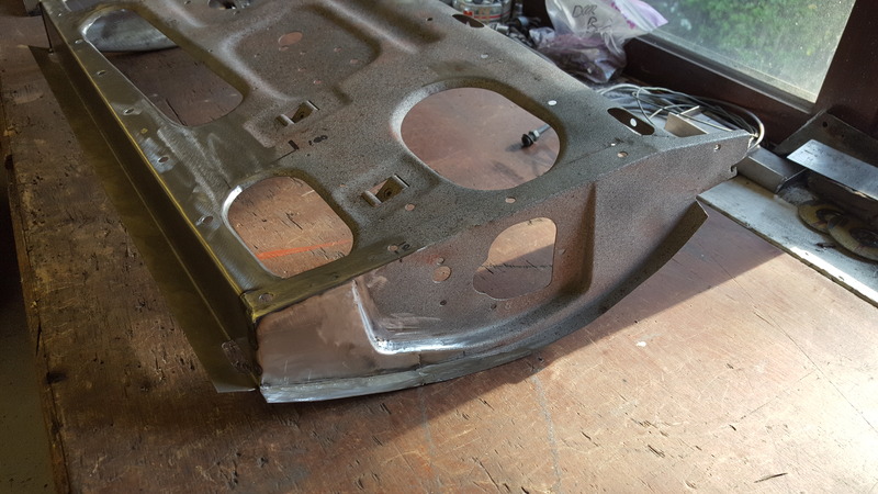

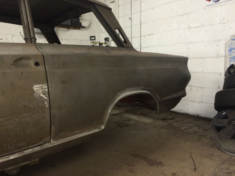

Here's an arch I put into a mk1 lotus cortina.
