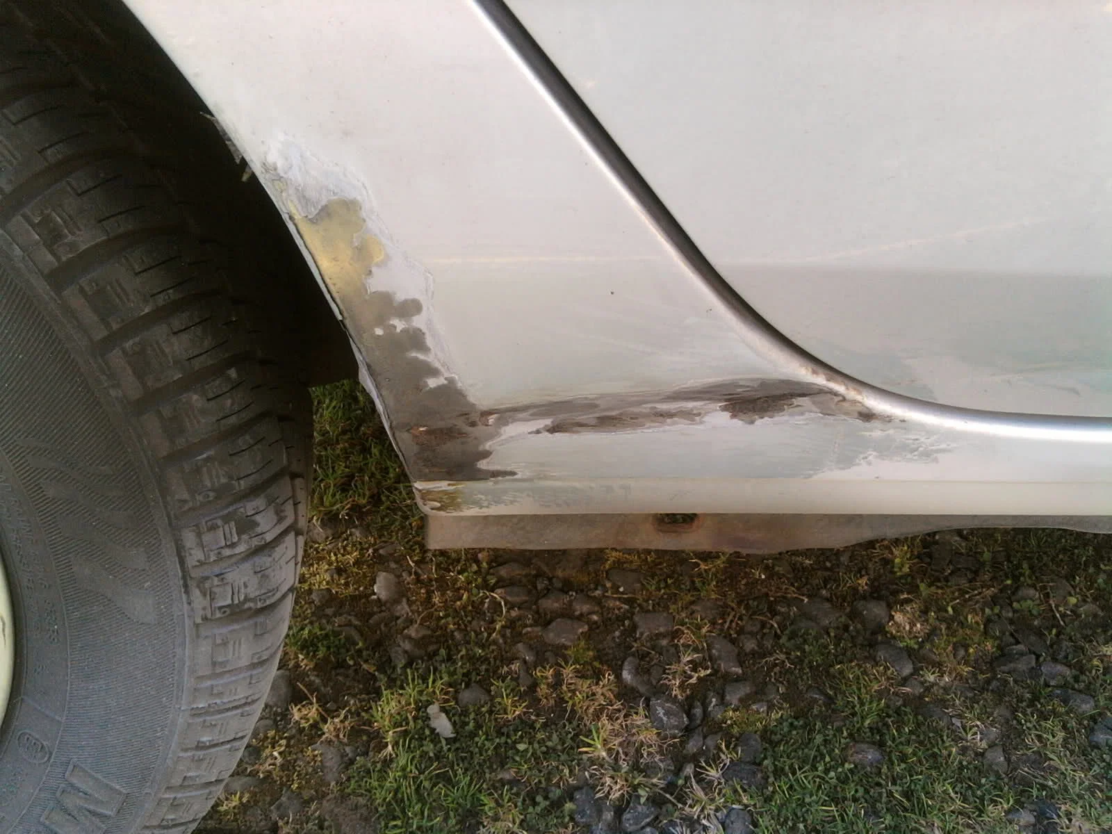

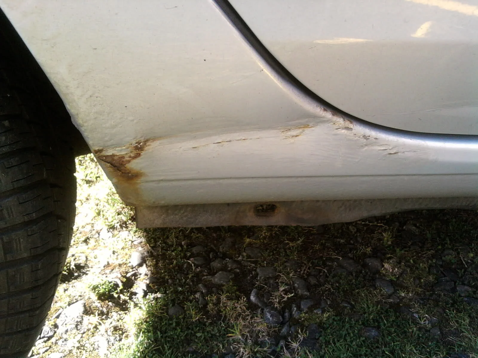

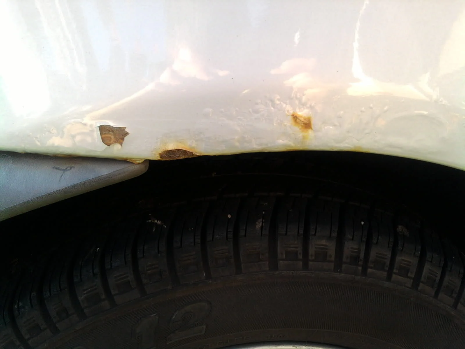

I decided yesterday to remove the worsening rust on my car before winter sets in. I'm pleased with the D.I.Y results, here's what I used:
Angle Grinder with flap disc
Fine sandpaper
Filler
Grey primer
Boreal Grey Spray paint made up by Halfords
Pics:

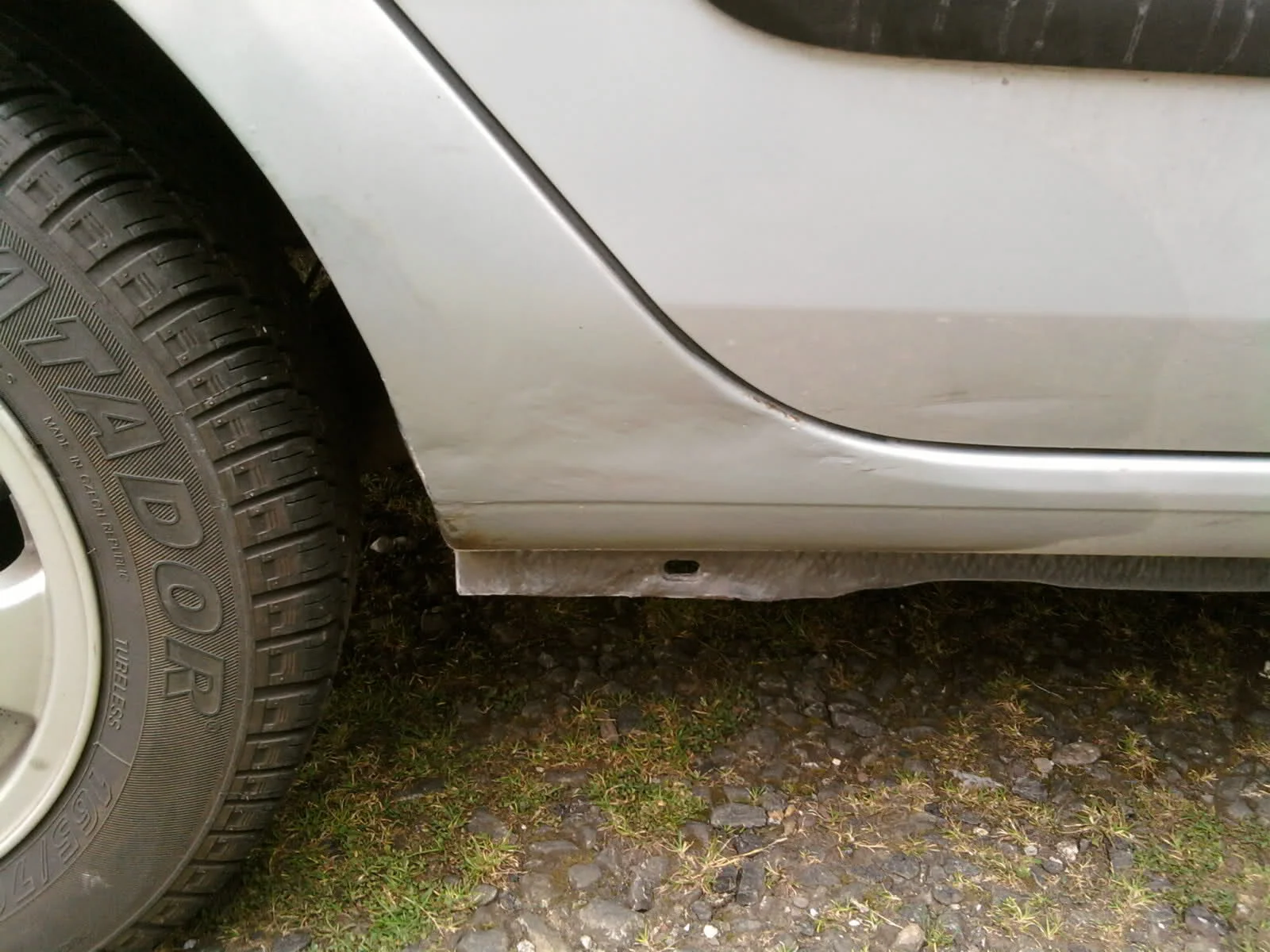

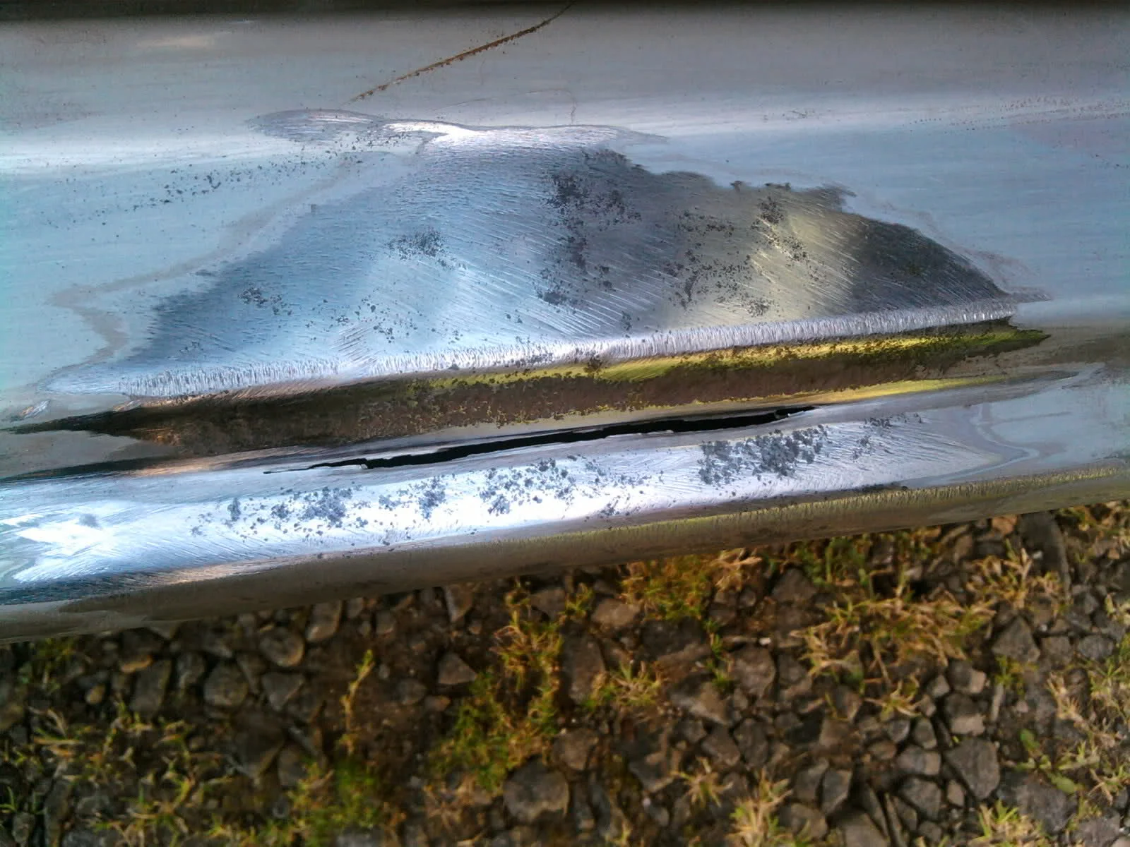

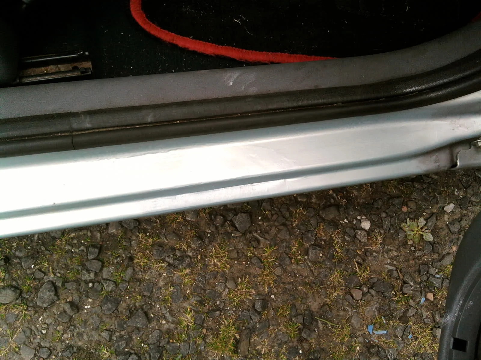

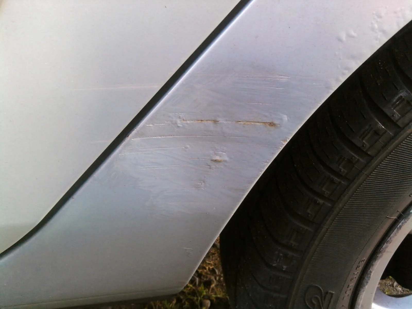

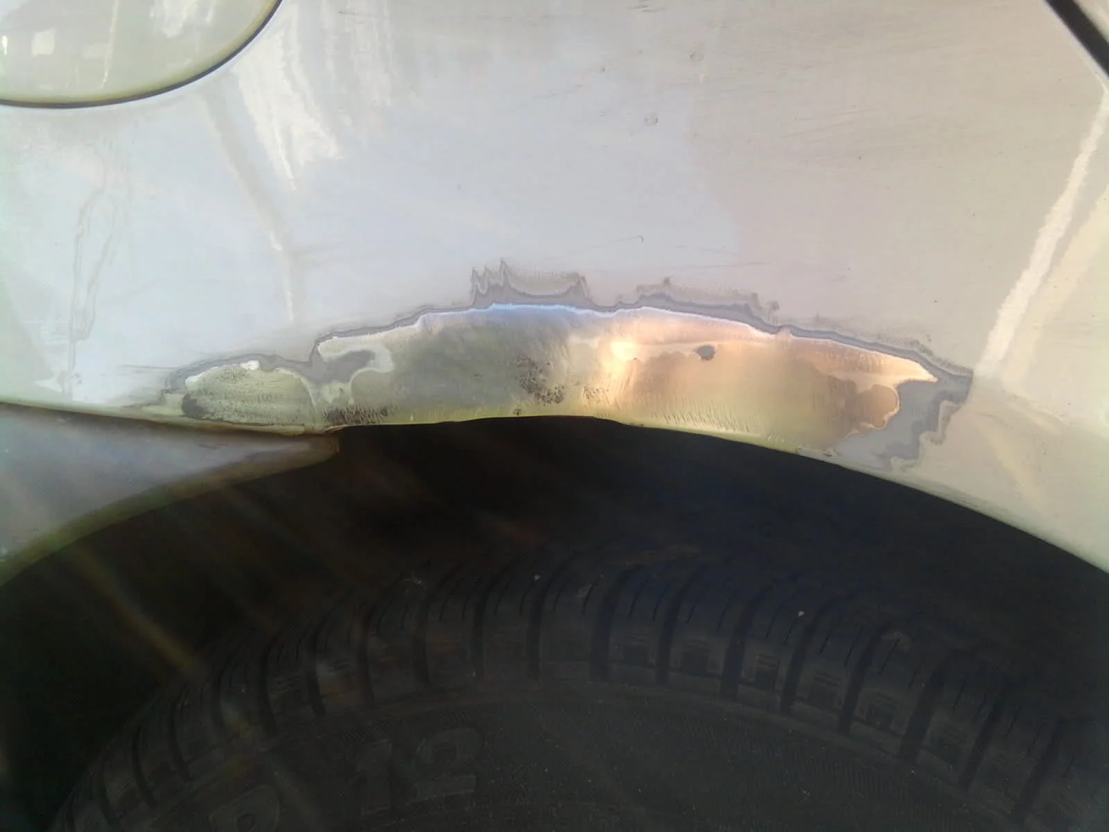

After grinding and some sanding (Rust was so bad on the sill it rotted straight through! Filler fixed that):
Dirty bus:

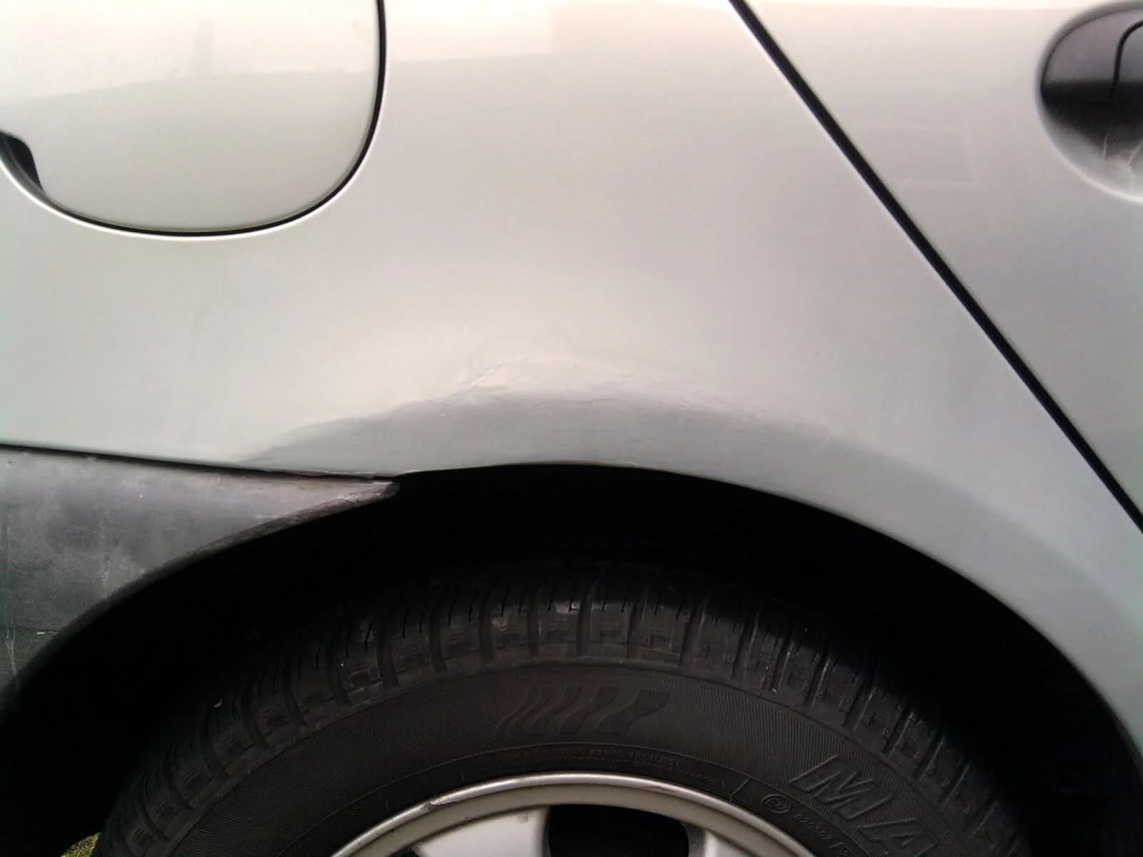

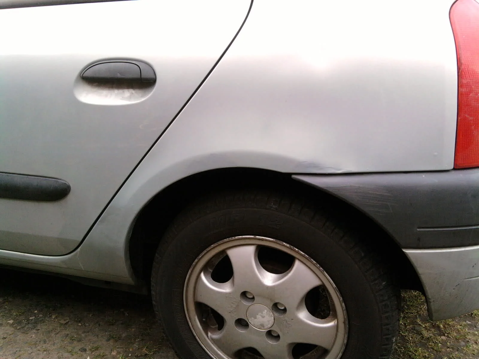

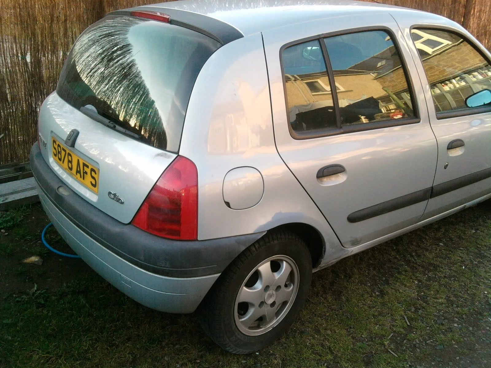

After filler, primer and spray:
It's not the best as you can see, but it looks much better than rot. Hope it'll last a couple of months at least. Gonna give it a good clean next weekend, see how she polishes up. Thanks for looking. :)

Well done for having a go mate and it looks a hell of a lot better but I've gotta agree that the finish would have been a lot better if you'd spent some time on finishing it off.
You could still make it look a lot better still, starting off with some 300 grit, then 500 then 800 then paint it again. Think you could really improve it.

Yeah the finish looks a bit ropey, but lets face it, its a 11 year old base spec clio. As long as the lads put the rust at bay for a good few months then it was a worthwhile mornings work imo.

Henry: Not sure! There was a huge patch of rust there, and when angle grinding it down I thought it was just a gathering of metal flakes but it had went right through!

Robbos: Gonna wash the hell out of it and t-cut the areas I sprayed, then see where I go from there. If it's nice I may well sand and paint it again!
As it was my first time doing (second time watching) I didn't expect it to be restored to it's original state, but from a small distance it actually looks pretty good! You wouldn't notice it unless I pointed out I'd done it. If your car is an old one and not very valuable I definitely recommend doing it yourself instead of replacing doors, wings etc. Cost me all of 24 quid.
