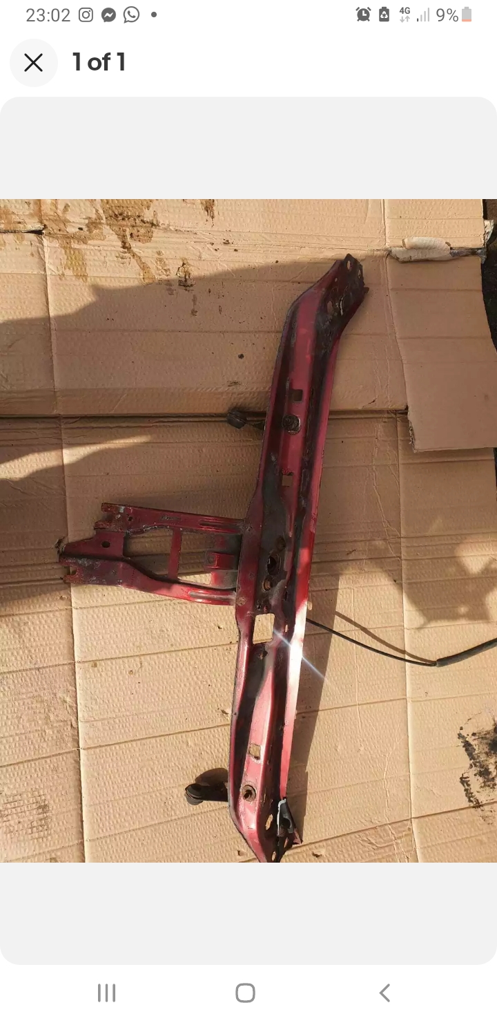

Found a set on ebay on a random slam panel for cheap. Looked like they had been in the sea as expected. Did not get any before pics for some reason so only got a screenshot off ebay.
Both bolts sheared right off even after soaking in penetrating oil as expected.

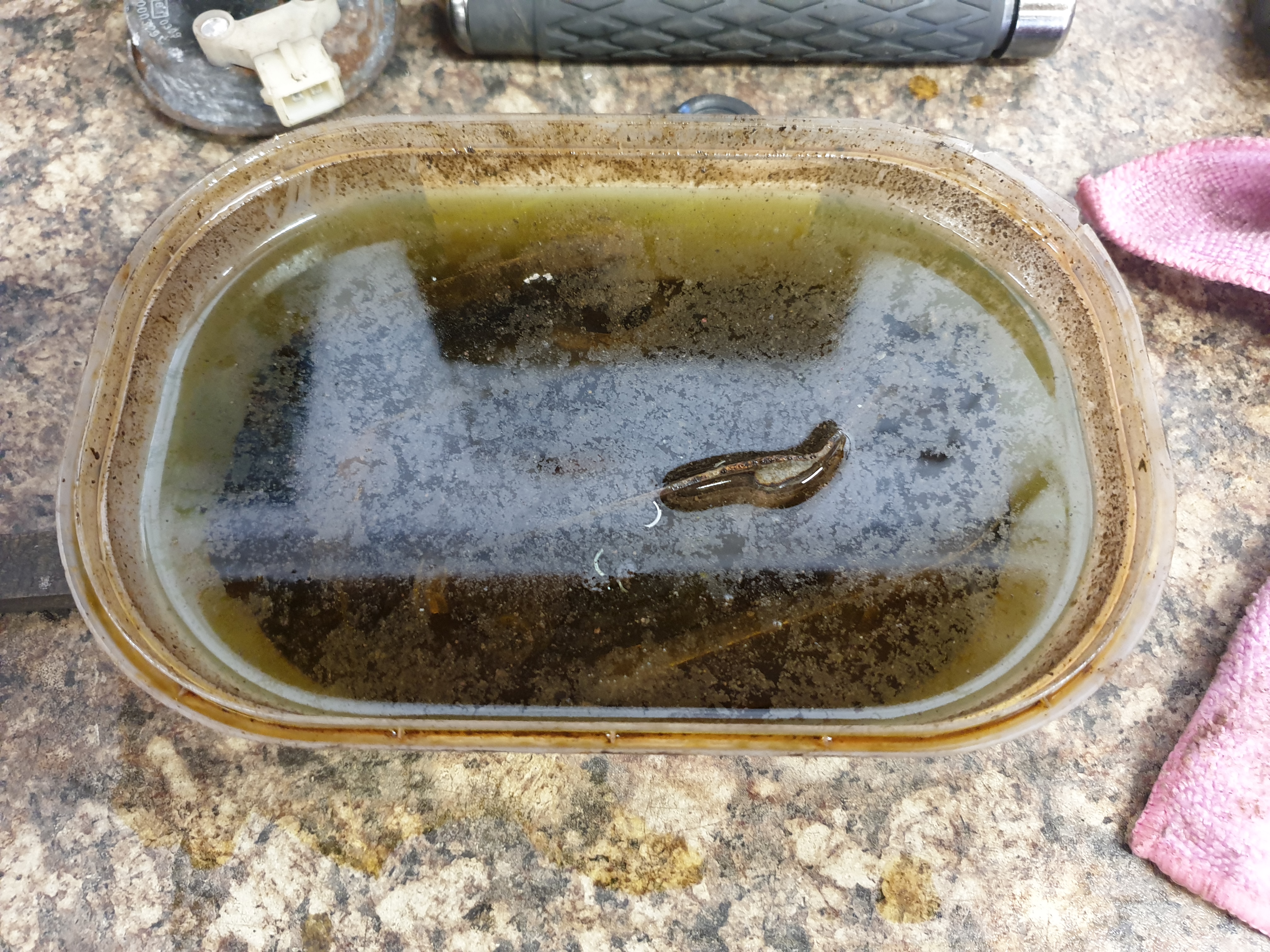

Ive used Bilt Hamber deox gel with success but opted for the cheaper option this time as id ran out of it. Bought 1kg of food grade citric acid powder for £8 delivered off ebay and mixed a few scoops full into hot water in a container.

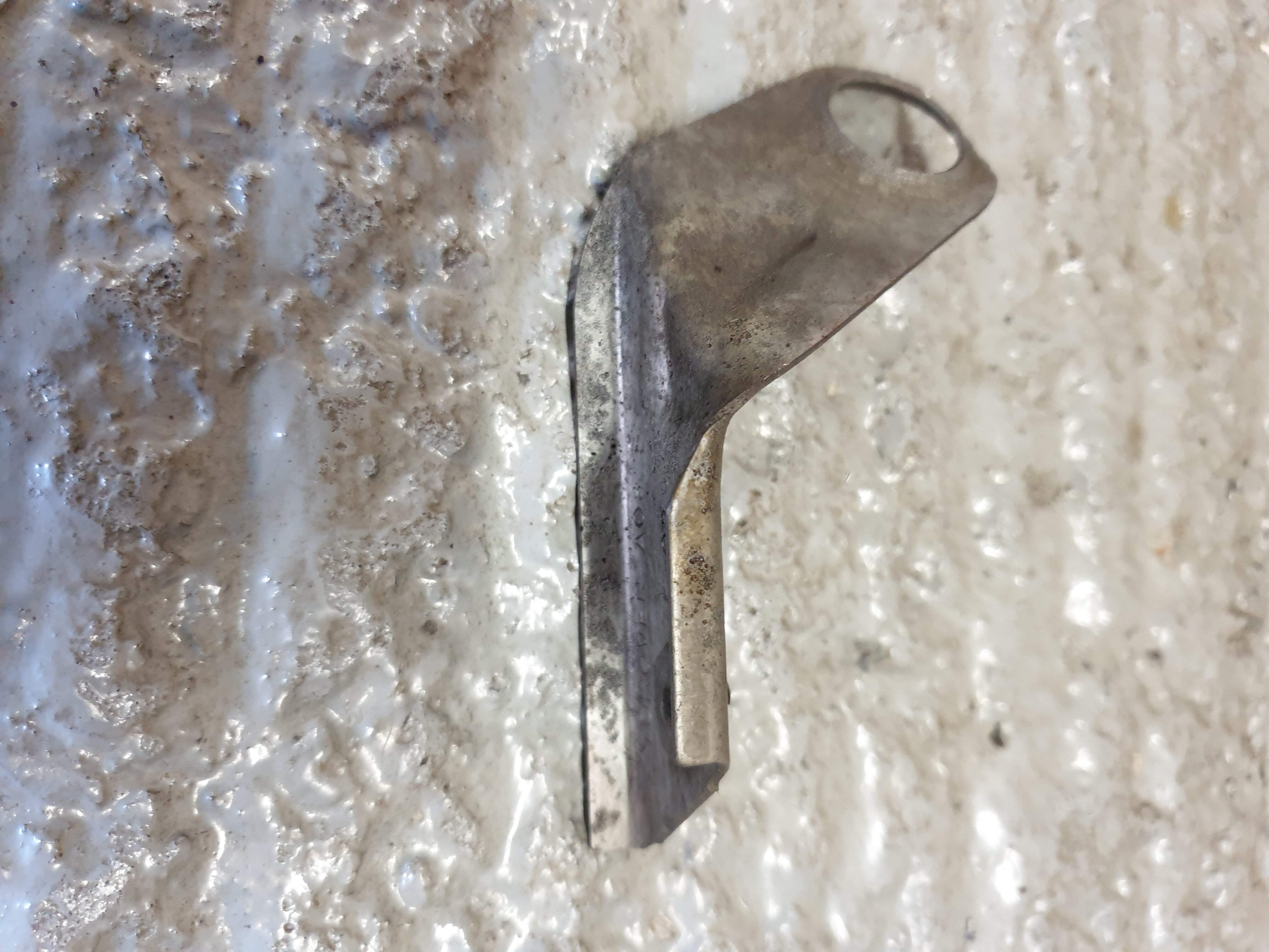

Left for a few days with occasional agitation with brass wire brush. Can see lots of rust particles on the container.

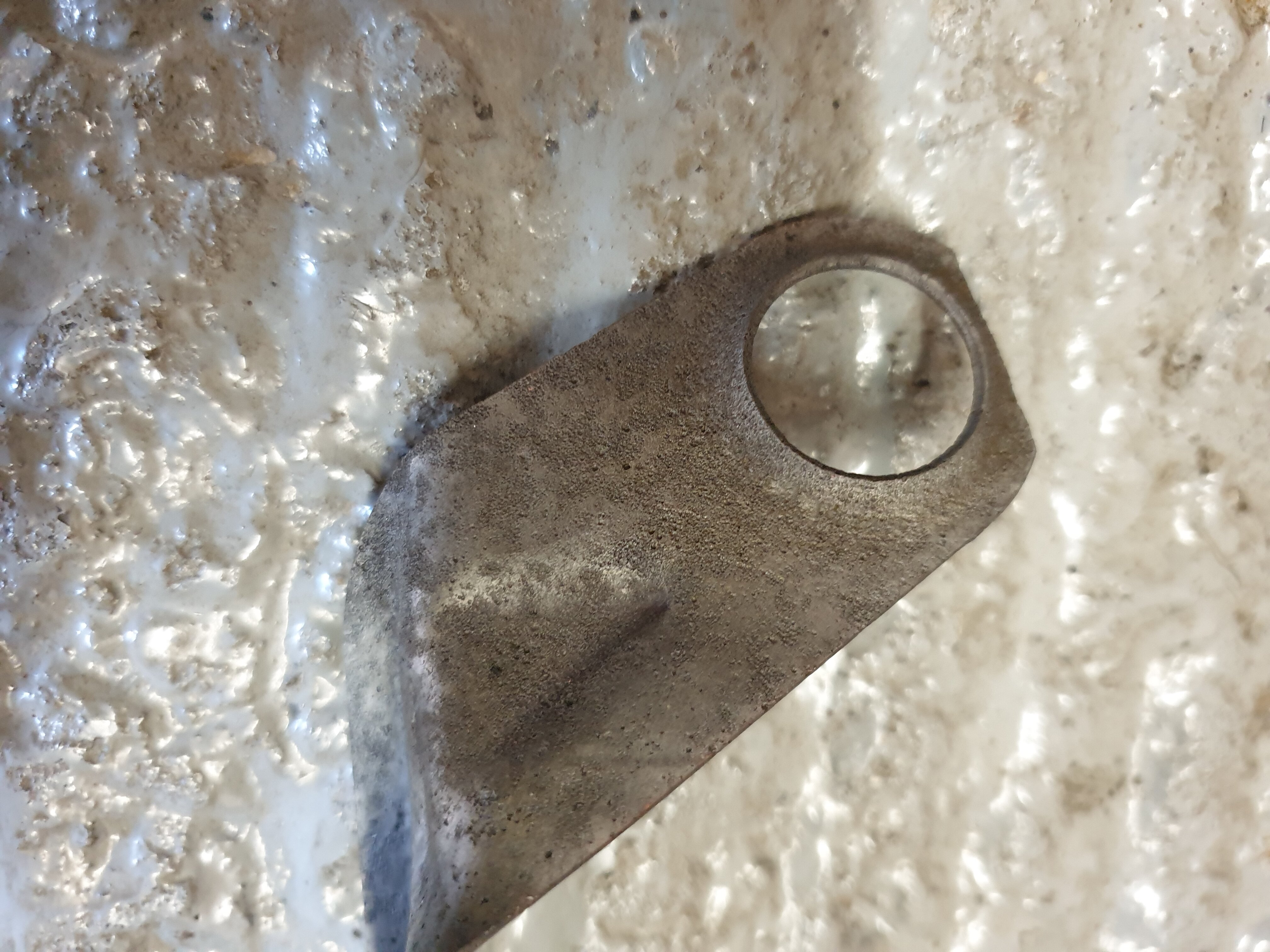

After 3 days soaking this is the result
All the rust removed even the smaller pits that is not possible to get with mechanical wire brushing usually. Amazing for little to no effort apart from waiting.

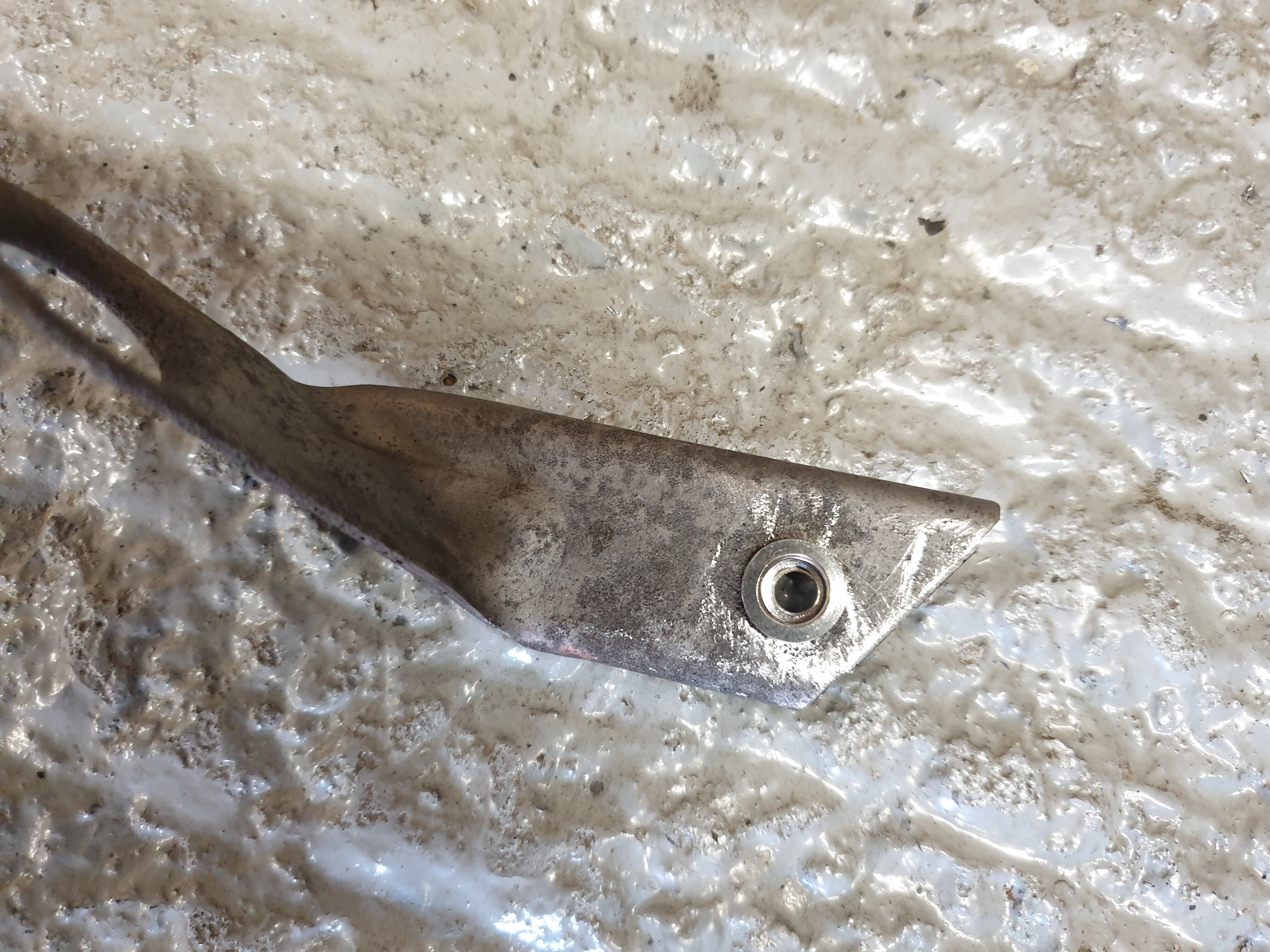

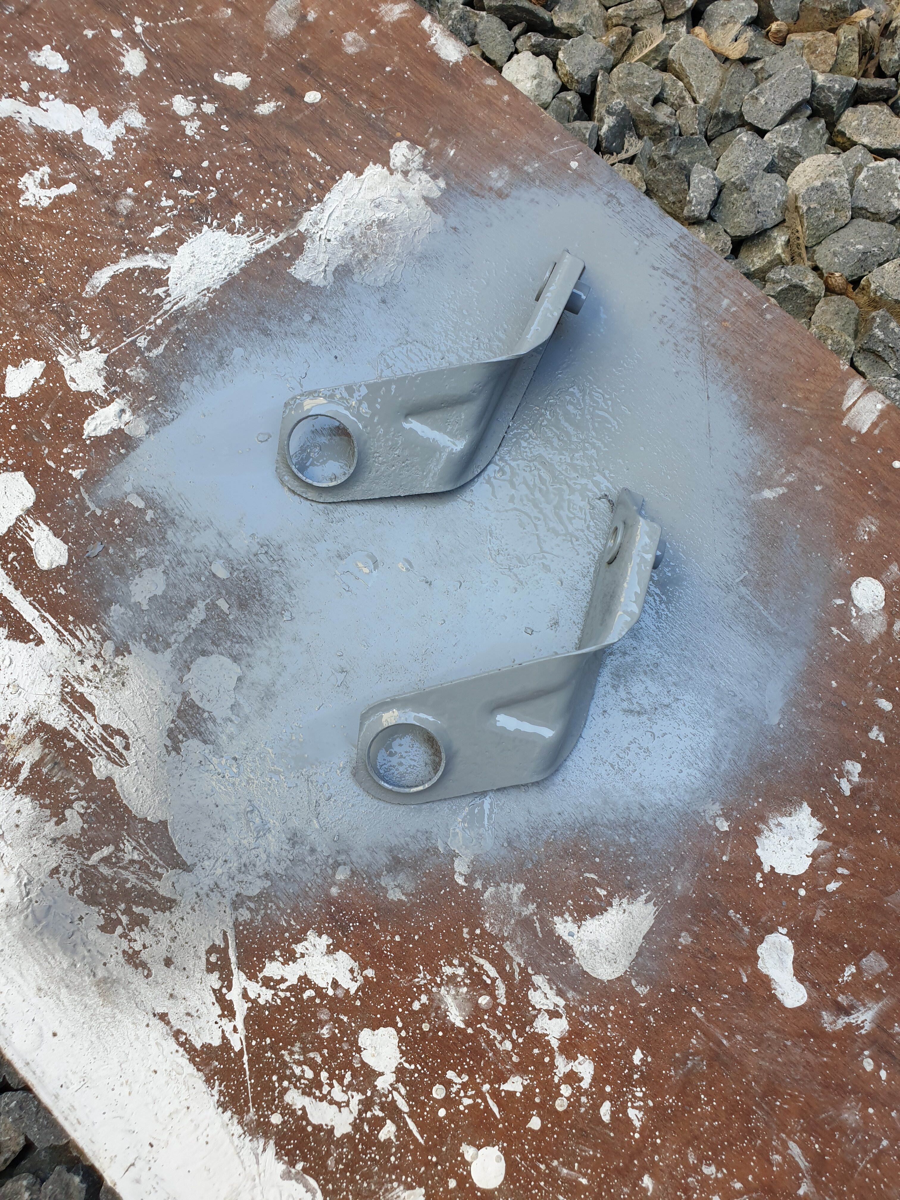

Rinsed off, drilled and nutserted repair

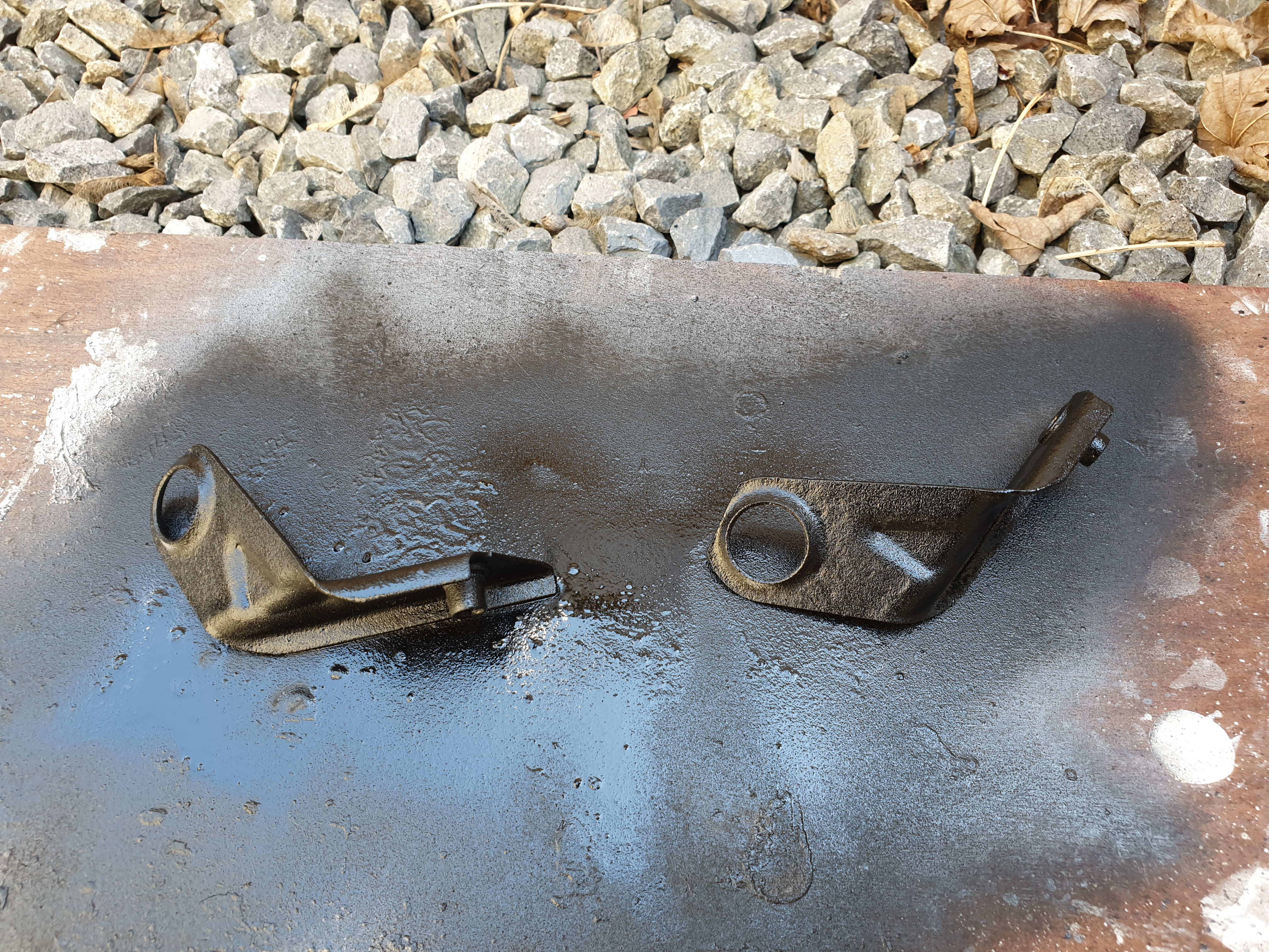

Acid etch primer.
Bedliner paint as top coat, all i had in stock.

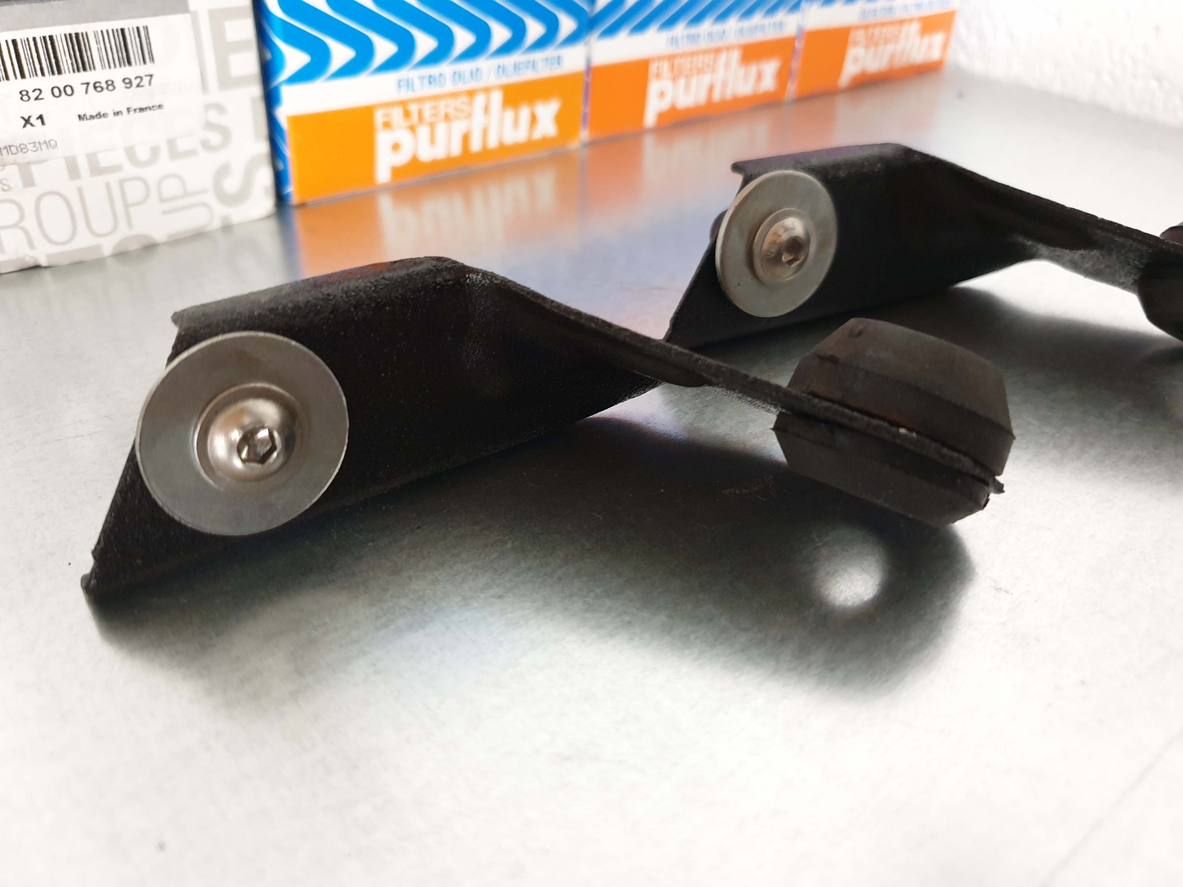

Stainless fixings and rubbers back in. Not bad for hardly any work.
