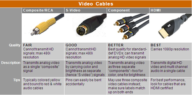

I have HDMI for connecting my PS 3 to the tv however my dvd video is only scart or S video. Which type of cable will provide the best quality?
Liam
scart is a higher quality than s-video
Scart would go between s-video and component
thanks. I just have the bog stancard scart cable that came with it not RGB scart.
still better?
Cable will probably be wired for it, but IIRC a lot of sets require the RGB scart to be on AV/1 as normally not all the sockets are wired for RGB.
