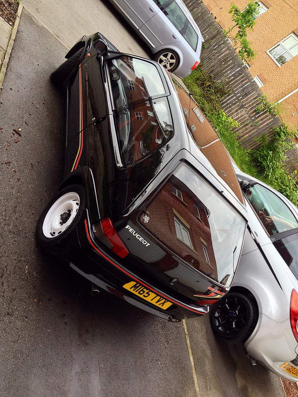

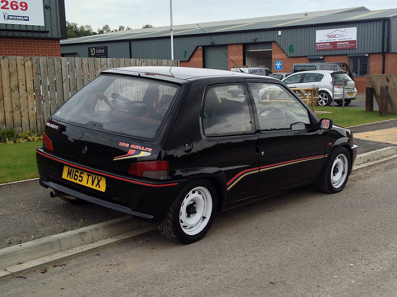

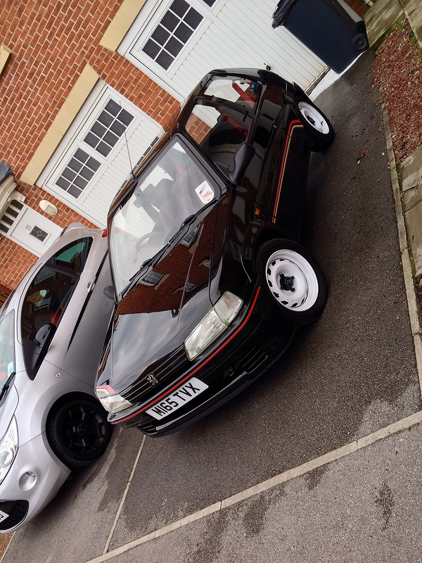

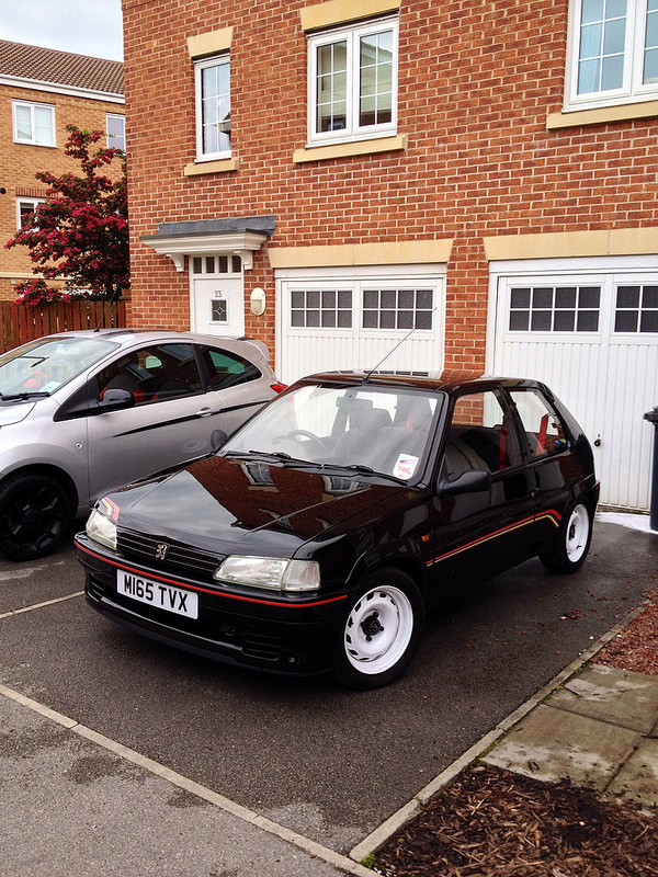

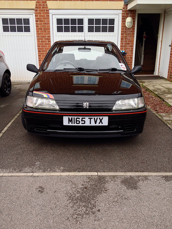

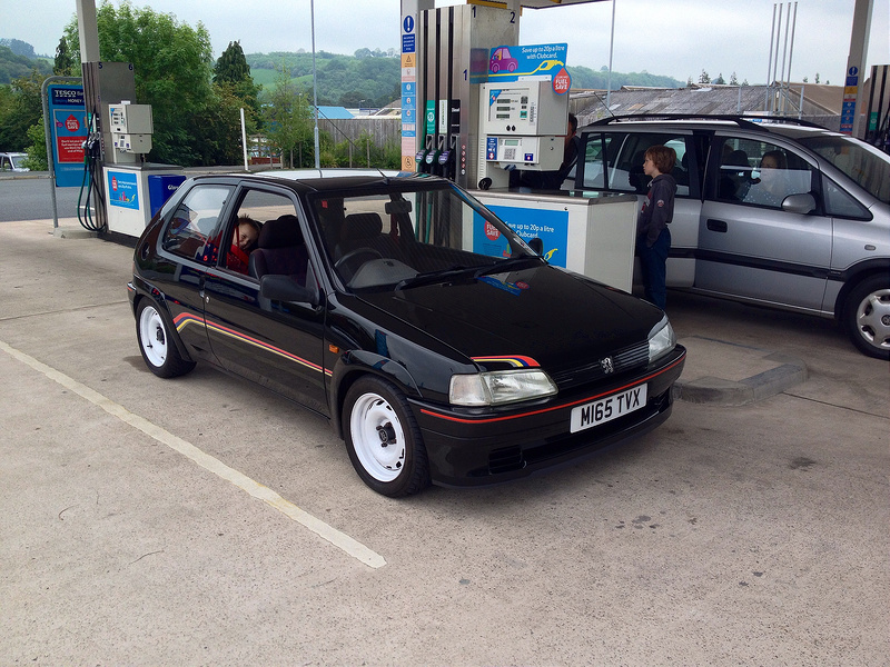

I'm pretty sure this was for sale on here before but I've bought it today.
Really tidy, 16v but still got the 1.3 box and in true rally style it has already broken down.
pics;
