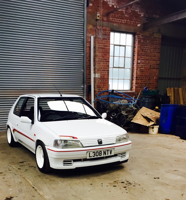

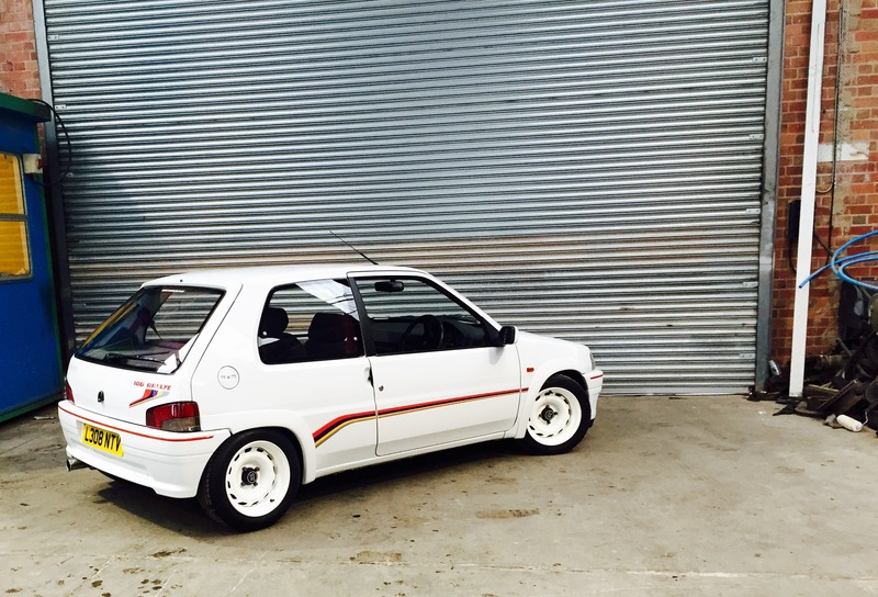

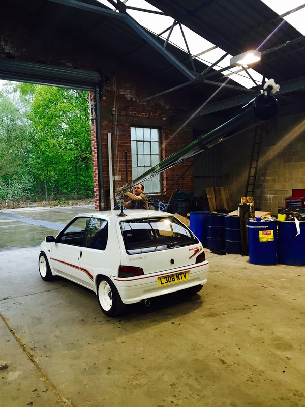

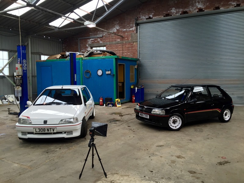

That white one looks like the geometry is out.

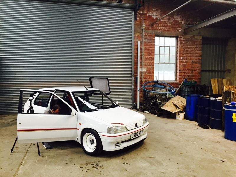

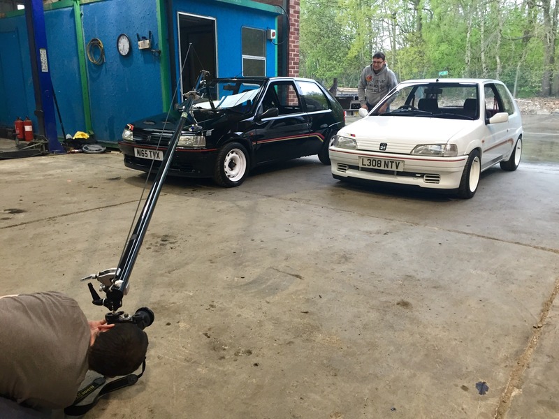

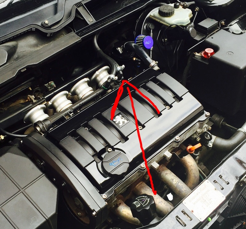

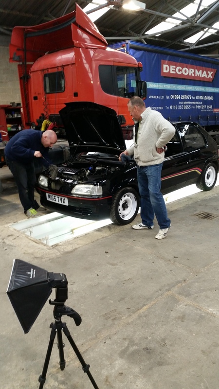

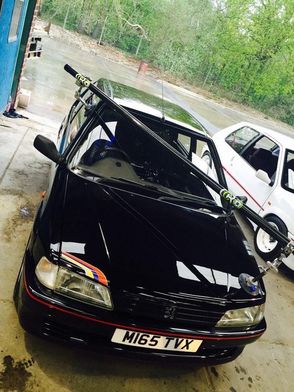

Small update. When doing the shoot and moving the car around I couldn't help but notice a few drops of oil where the car had been stood. We were in the right place to have a look so got the car over the pit and indeed the bottom was covered in oil! (Note how close I was to driving the car into the pit!)
With the help of Craig and his knowledgable old man we identified that the oil had pissed out of some return breather located here;
This had never been bunged before and had never leaked so was a bit of a mystery. Luckily the car had not lost too much oil and was still within tolerances. Craig's dad created a bung out of a rubber number plate bung and a screw and the leak was sorted.
I was still confused as to why it had started leaking from that location though so upon getting home looked into it more. It turned out my catch tank was full so pressure had built up and forced oil out of the other hole.
It's now emptied again but it's a Lesson learned - check catch tank more often!

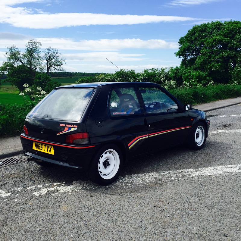

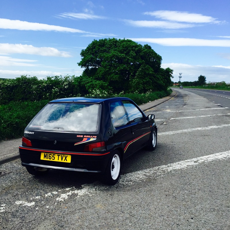

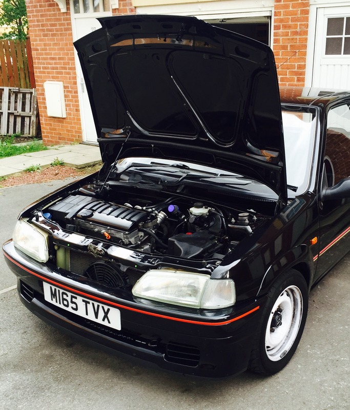

Nice dry afternoon this afternoon so went out for a spin. I love only using the car occasionally as it always keeps me interested and I don't get chance to get used to the performance.
Anyway, here's a few pictures I took;
