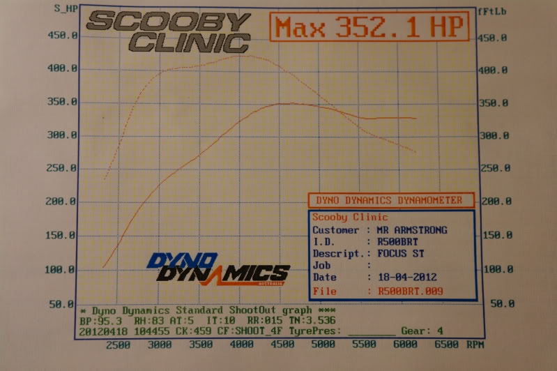

Heres a little spec list off my previous Focus ST which ran 352bhp and 435Ib/ft, maybe of some use if you wanting to get even more:
- K06 Dreamscience hybrid turbo & manifold
- Forge actuator
- Forge recirc DV
- Dreamscience Turbo X remap
- Dreamscience induction kit
- Airtec gen 3 intercooler
- Airtec plenum
- Focus RS injectors
- Focus RS oil cooler
- Pro Alloy cold pipe
- Magnex downpipe (3")
- Dreamscience decat (3")
- Piper catback (3")
Got to say was pretty mental through the midrange with the torque that was available from low down:
