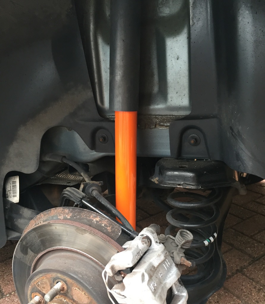

Fitted the rear shocks yesterday (as well as replace the pads that were down to the metal)
Rear pads lasted 70k though, so can't complain really!
Monday is the big day - Front shocks, bottom arms and top mounts to go on.

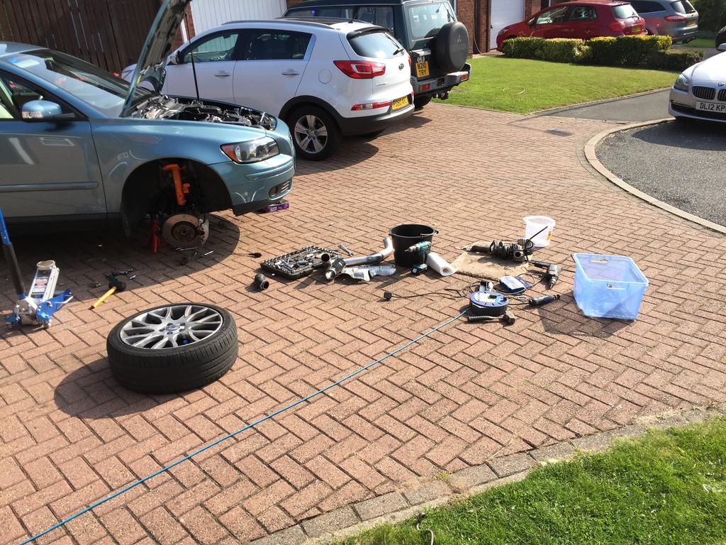

Quick update:- Fitted the front shocks, top mounts, bottom arms and drop links. Tightened it up nicely. Then it was MOT time, so a couple of Saturday's ago, I get up early (MOT was @ 9am) to change the downpipe, 30 minutes later that's done and off I go.
FAILED - but only on the headlight level being too low. A quick session with VIDA got the auto level system recalibrated (it was because of me disturbing the sensor on one of the front arms) - went back to the MOT place about 11am - passed, great.

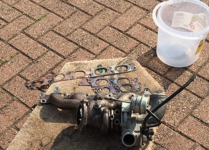

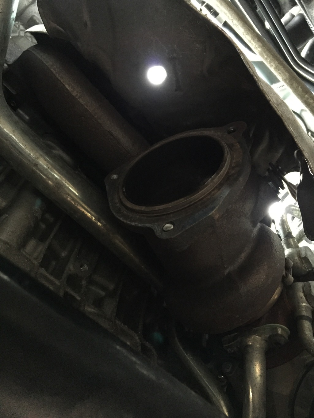

I had no time that day to swap the downpipe back, so I left it until the following weekend. I really wish I hadn't! - in the process of removing the OE downpipe, 2 of the downpipe bolts sheared off in the turbo. Left me no choice other than to remove it.
Here's the snapped bolts
Here's how my car sat for a week whilst I had the turbo drilled and tapped
Here's the sad looking turbo
I'm pleased to say it's all back together, VIDA was very helpful in the refit process as it gives all the torque settings. Refit took twice as long as strip down due to taking my time and torquing everything correctly (if you're gonna do a job, do it properly).

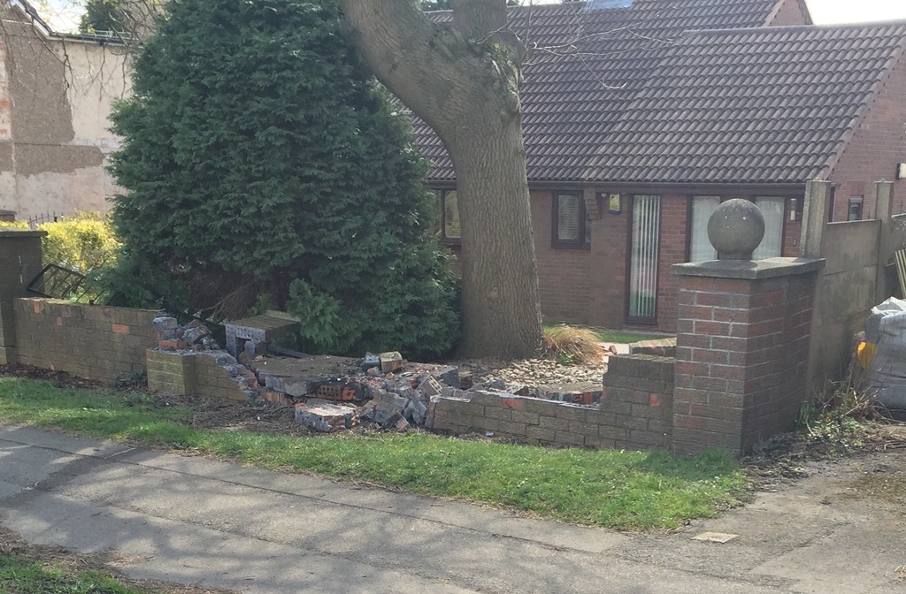

Righto - Volvo is dead after I had a blackout (possible cardiac arrest) at the wheel and crashed into a telegraph pole and someone's garden.
No pics of the car as I never got chance to see it, but it's a cat c.
Hoping to buy it back to salvage some parts but we'll see how that pans out.
Thanks old friend for looking after me, could have been a hell of a lot worse if I wasn't in the tank I reckon.

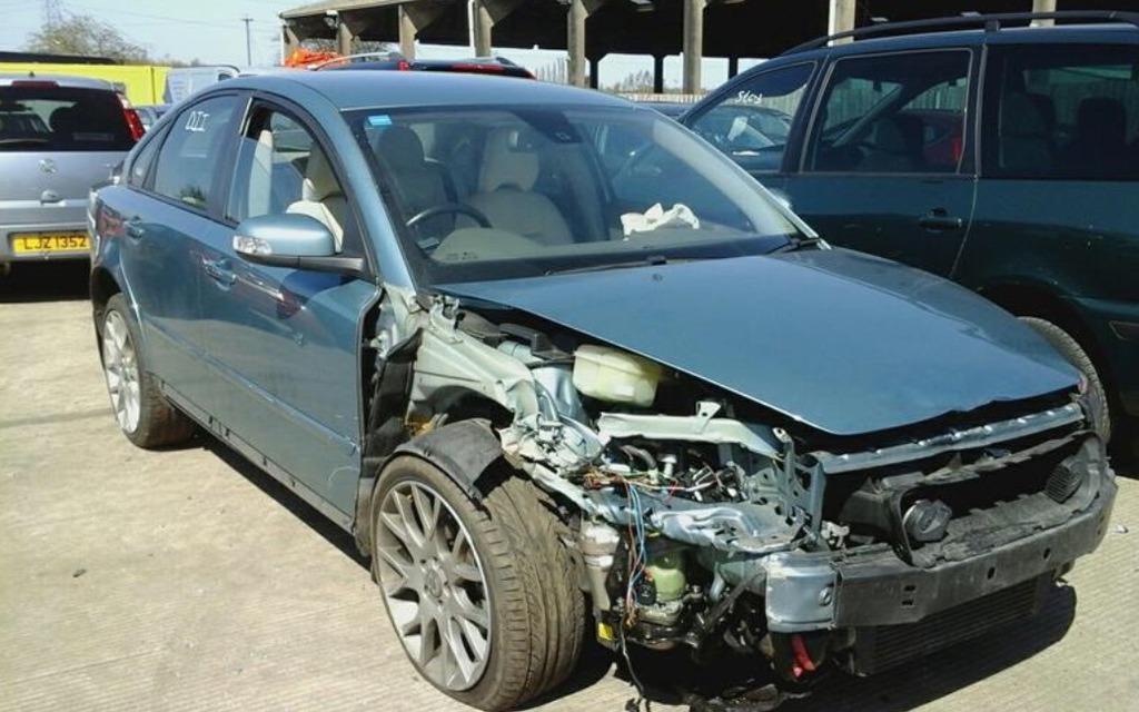

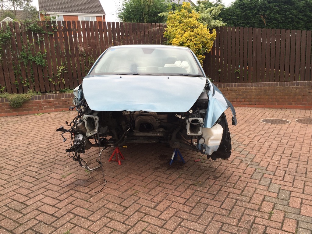

So here's how the car looked when I collected it from the salvage yard
And how it's sitting right now

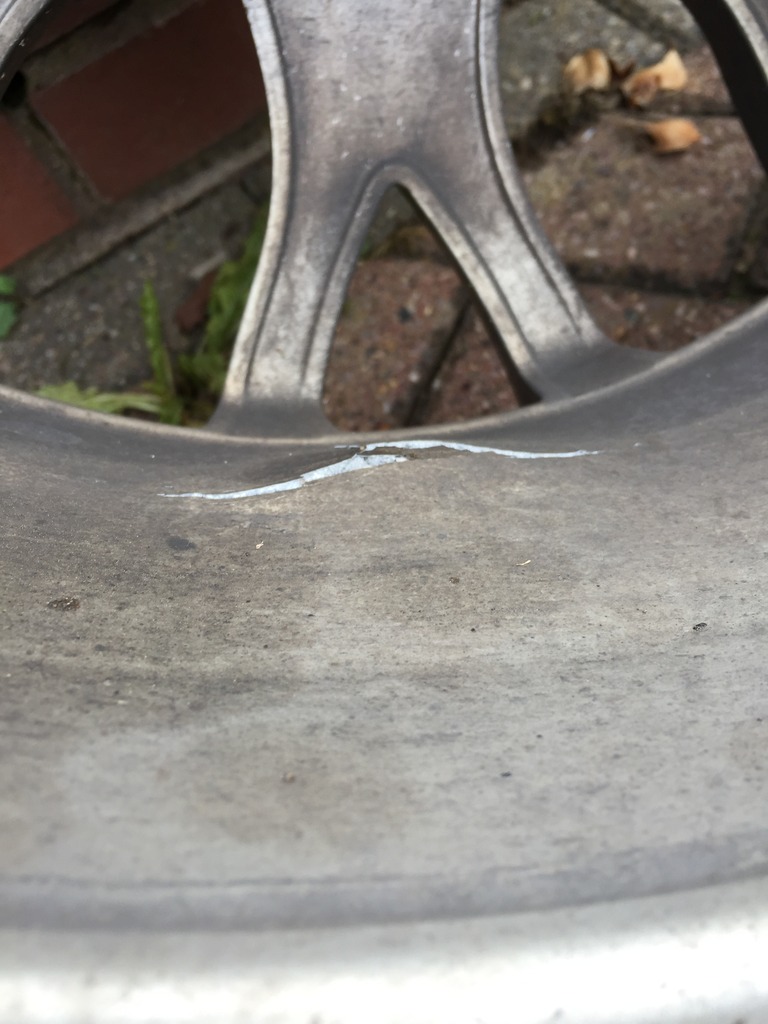

Proper bit of damage to the front wheel!
