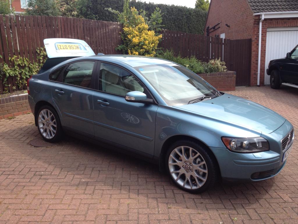

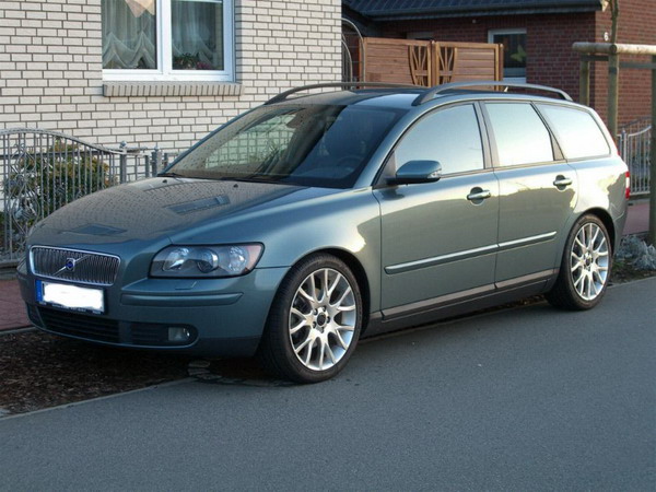

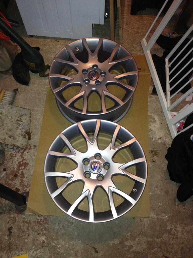

Quick update. Won an eBay auction today for a set of 18" Volvo Medusa wheels which were an option wheel for the r design I beleive. They are freshly refurbed and ready for new rubber, hoping to pick them up at the weekend. Ok so it loses a little of the sleeperness but it'll smarten the car up no end.
Not my car of course but you get the idea

Really like those, I reckon it'll still be just as much a sleeper as before tbh.

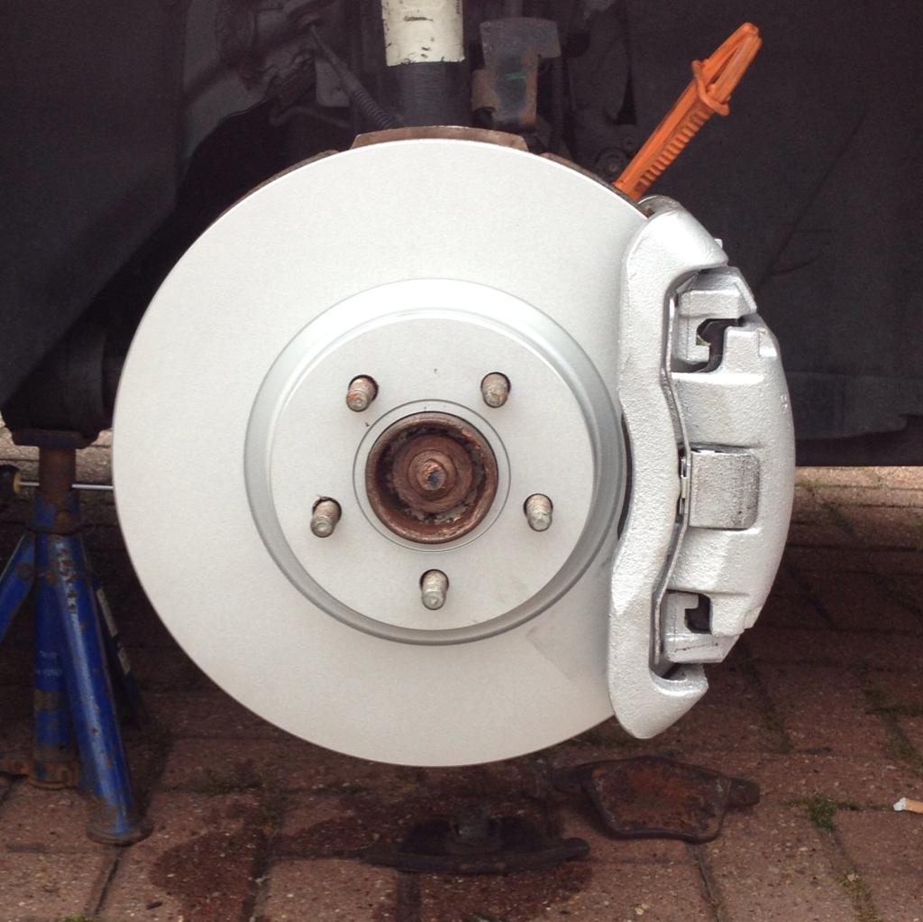

So today's update is - front brakes!

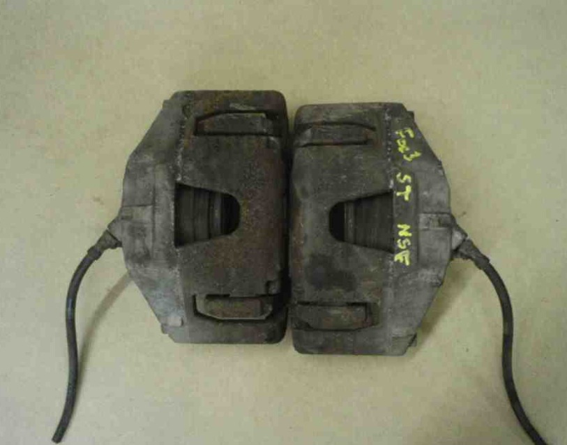

Picked these up about 14:30 this afternoon, they are calipers from a Focus ST, along with a new set of 320mm discs and pads (the riginals are 300mm)
This was how they looked when collected from Nottingham ford breakers:-

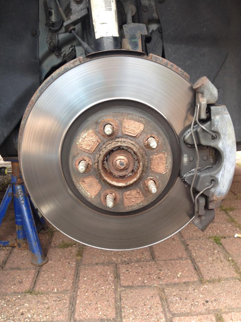

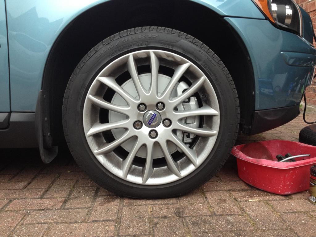

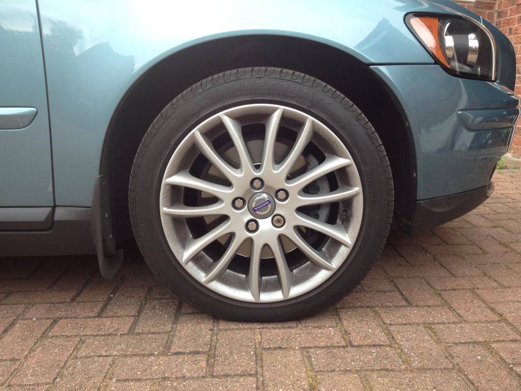

This is the original set up

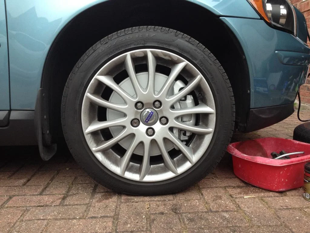

New calipers sprayed and fitted along with the discs & pads
Excuse the filthy wheel, i'm not cleaning these when I have the new ones to go on soon!

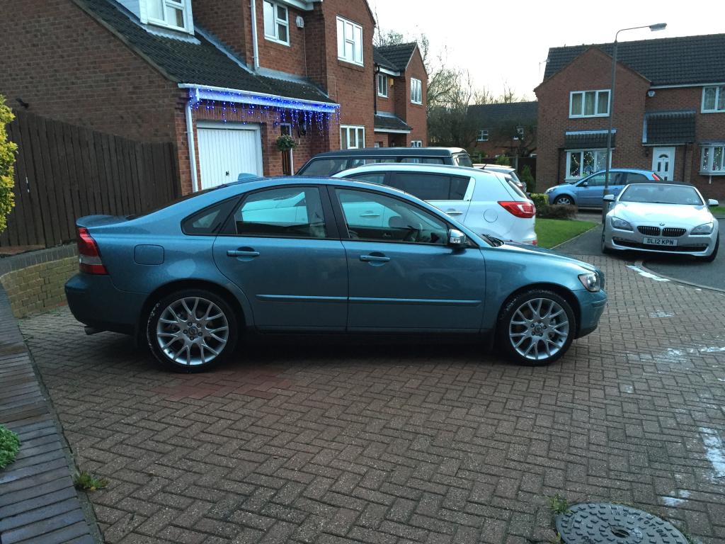

New wheels fitted today with a nice new set of Michelin Pilot Sport 3's in 225/40/18
From this
to this
im really happy with them!

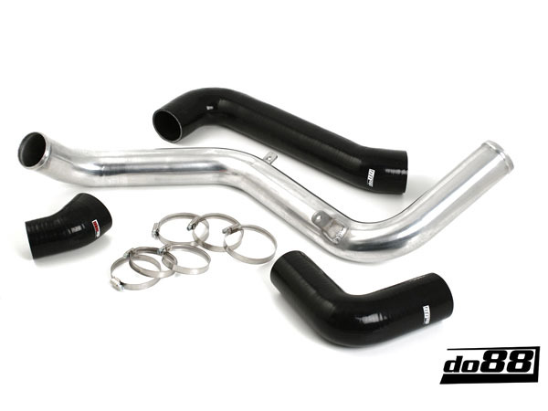

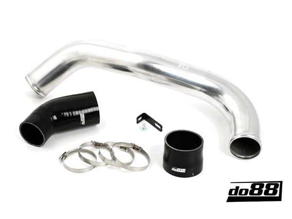

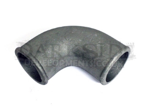

These to replace the 90degree silicone bends as they rub slightly on the radiator brackets (sticking with black to remain 'stealth')
And have these coming next week. The intake pipe is 3" instead of the OE pipe that goes down to 2.16" at one point, and the intercooler pipework in 2.5" instead of the OE 2.0".

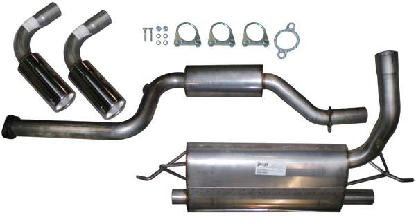

Then early next year I want this exhaust system, it's apparently one of the quietest stainless systems and is only slightly louder than OE.

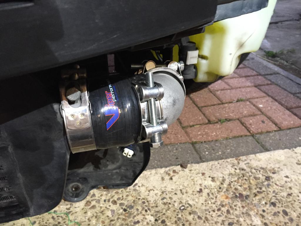

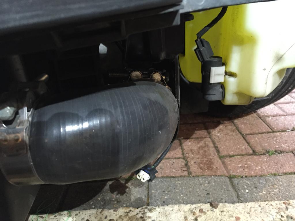

So, I managed to sort the boost piping yesterday. I've not got the hard pipe kit yet but I've sorted the pipe that kept popping off.
Original set up
New set up
It's a much tighter bend, so doesn't catch on anything now and it s much better fit. I took it for a few high gear full throttle runs and it seems to have cured the problem!
