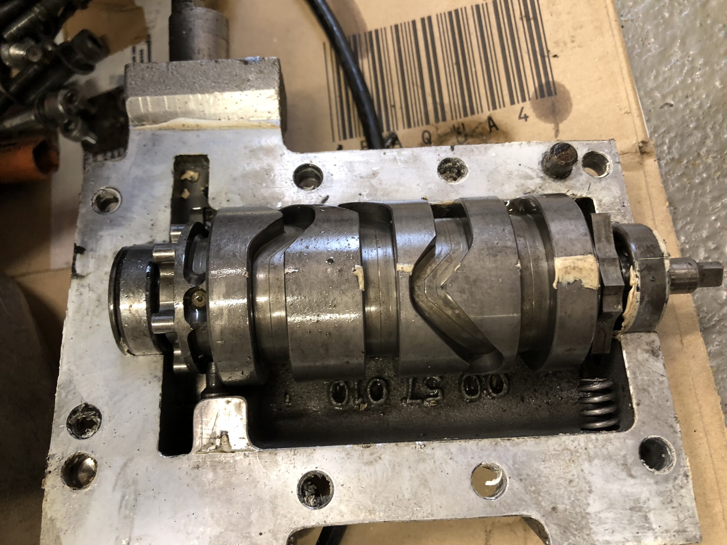

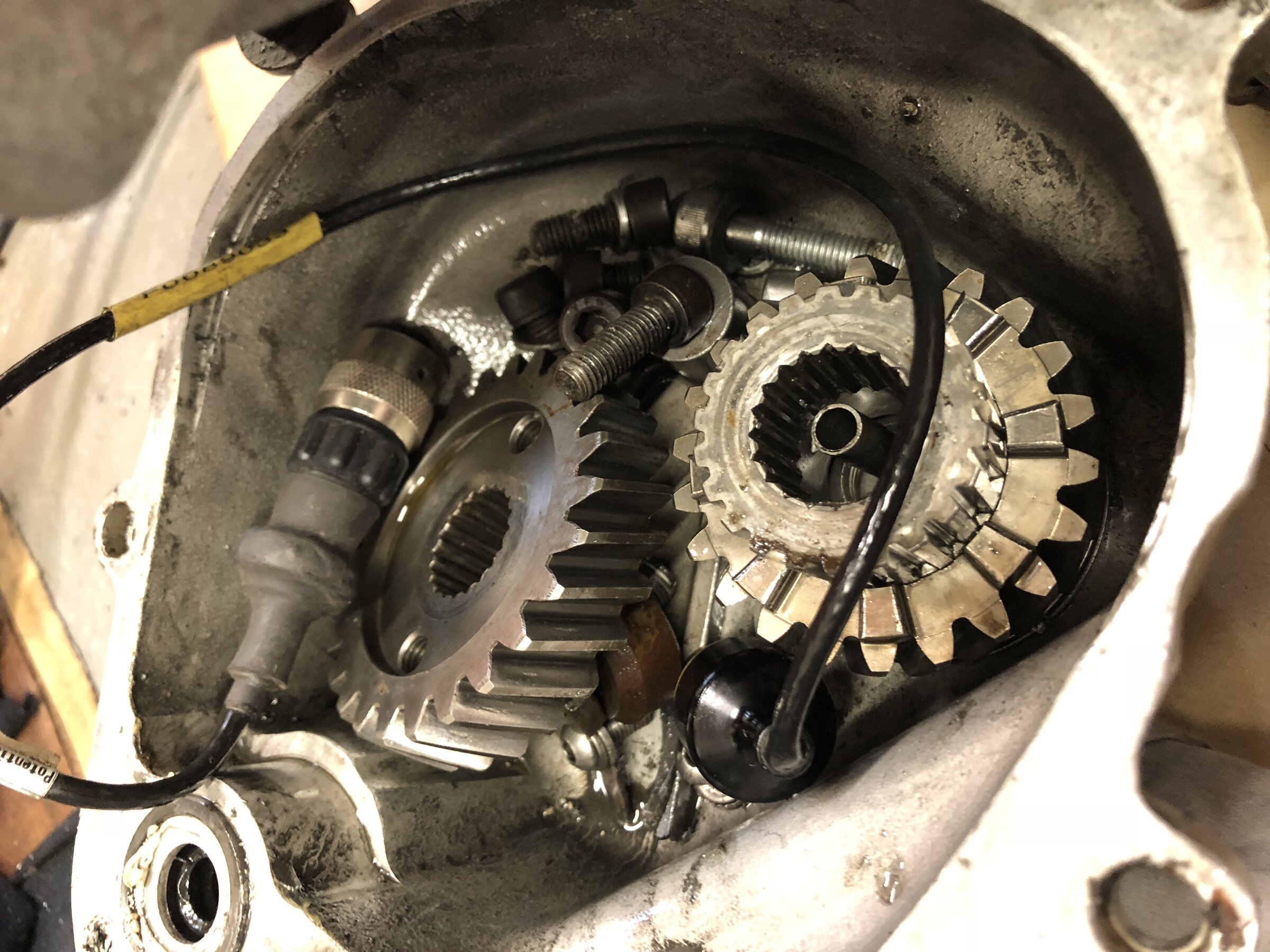

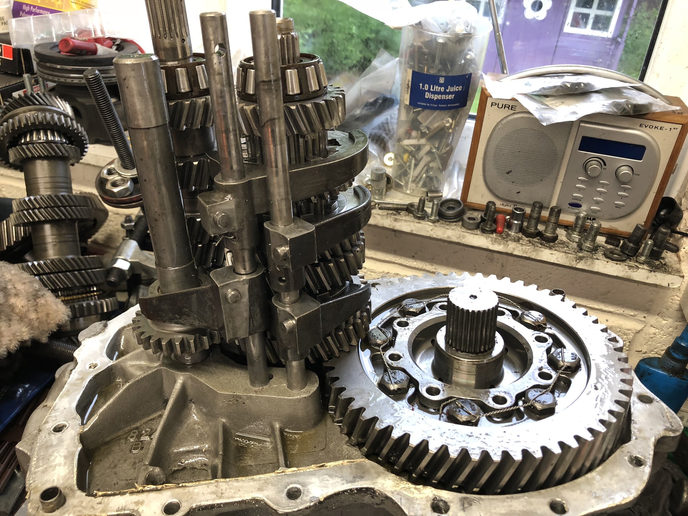

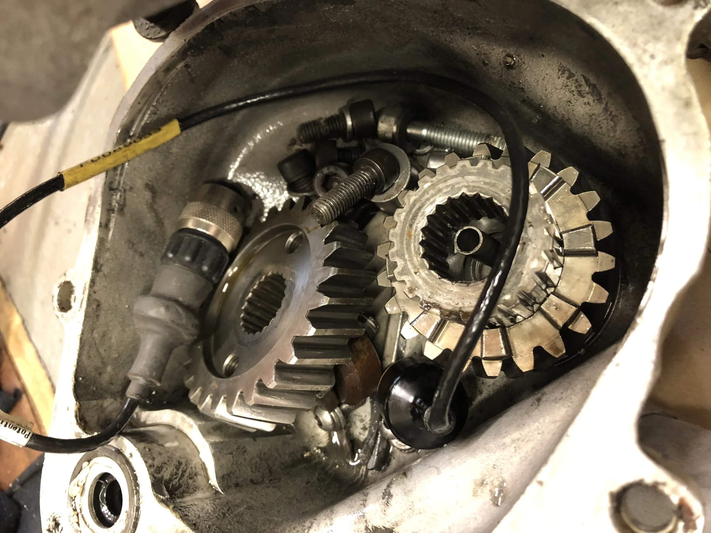

Sometimes I get interesting stuff to look at, so thought I’d share some pics of what a sadev clicky box looks like on the inside.
Diff being stripped for a rebuild here.
Selector worm
5th gear
