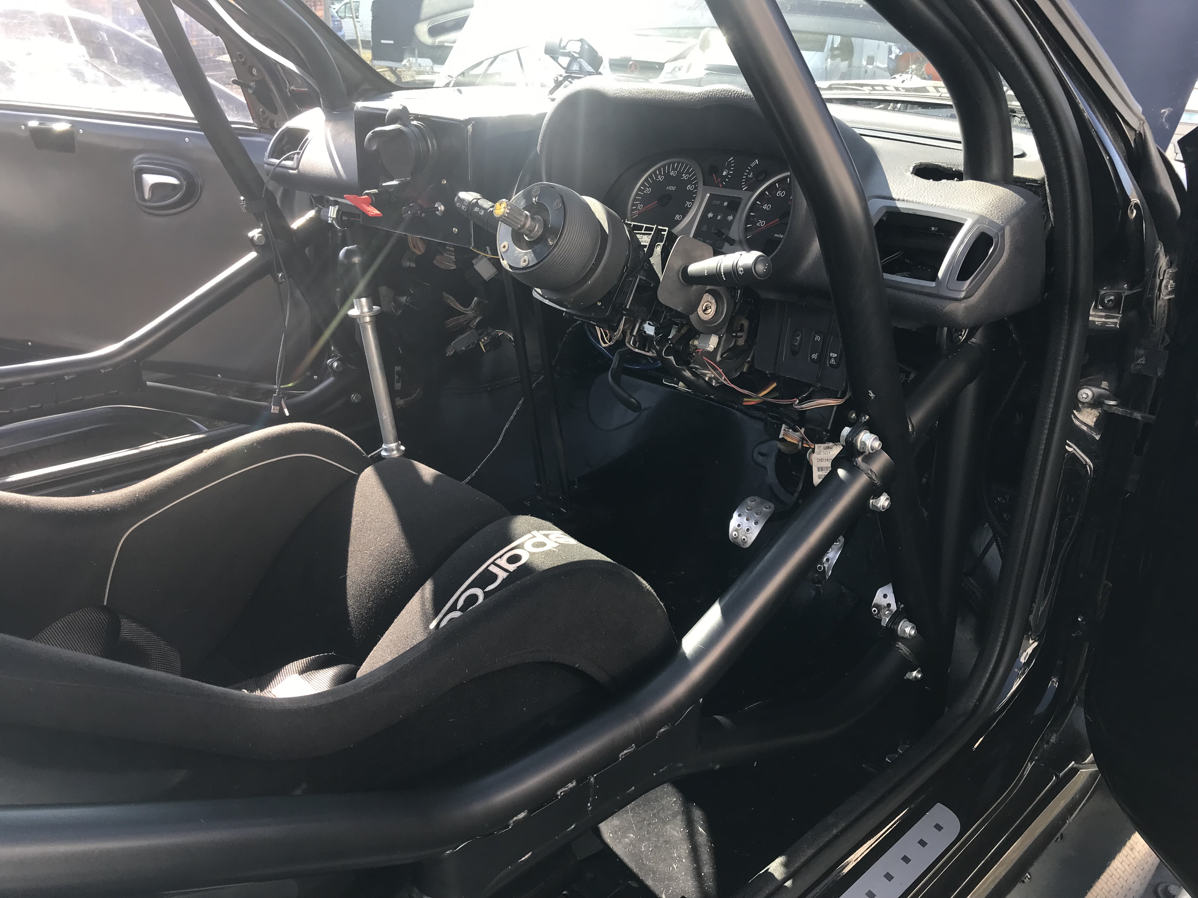

It’s doable but you’ll need to cut around your carpets and cut into the dash. You’ll lose the glovebox. I couldn’t be arsed so stripped it right back. Lots of pics if you need them.

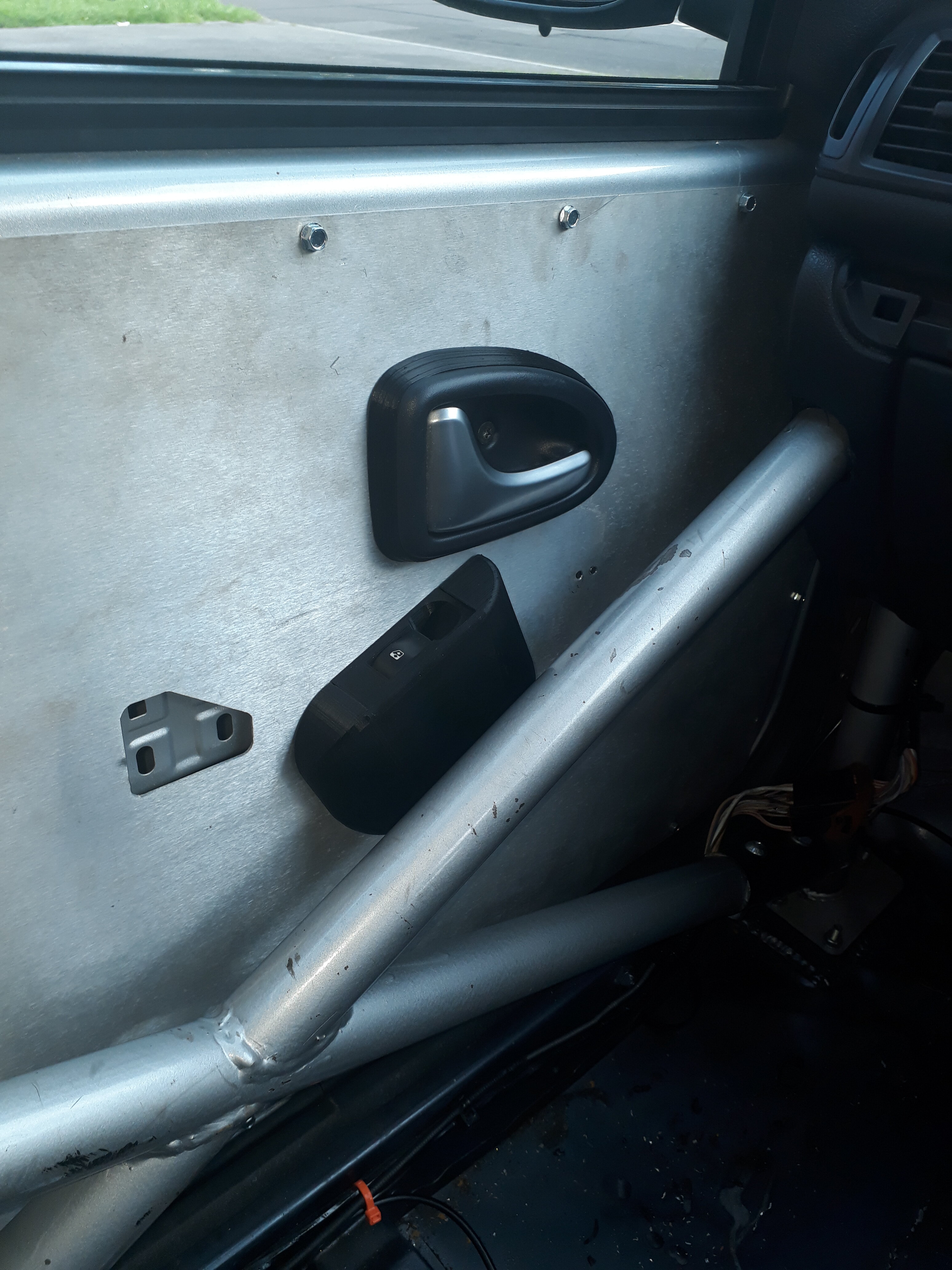

All non dash dodgers will need a fair mount of the upper and lower dash cutting out, and the RO22 is no exception. This also means the fuse box needs relocating. Most cages with door bars will catch on the OE door cards also so usually need plain panels put in place.
