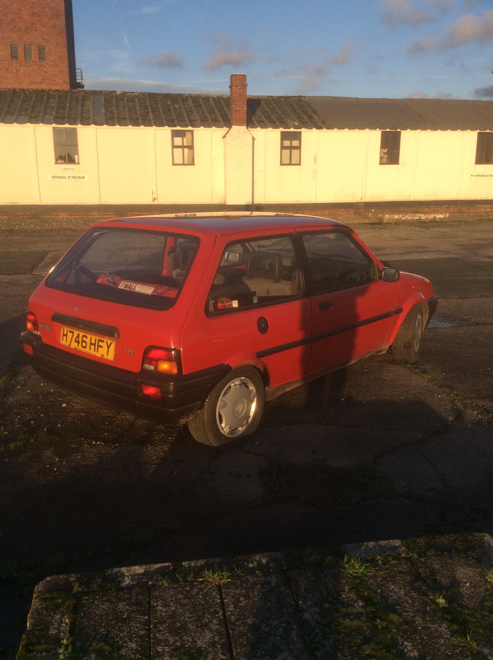

I did a metro vvt a couple of years ago , the rust is a nightmare . Brilliant sleeper though.

Gone mate. Sold it a few months ago. Was a sad day but the right decision, wasn't using it. I'll always have a soft spot for them now, though.
Damn that’s a shame. How much did you let it go for? Out of touch now on evo prices.
16,300 in the end. Strong money for 8 MR but I'd spent a great deal on it and there's not many in that condition anymore. It would still have needed treating underneath in a year or two though to keep it that way if I were to keep using it. Agro...

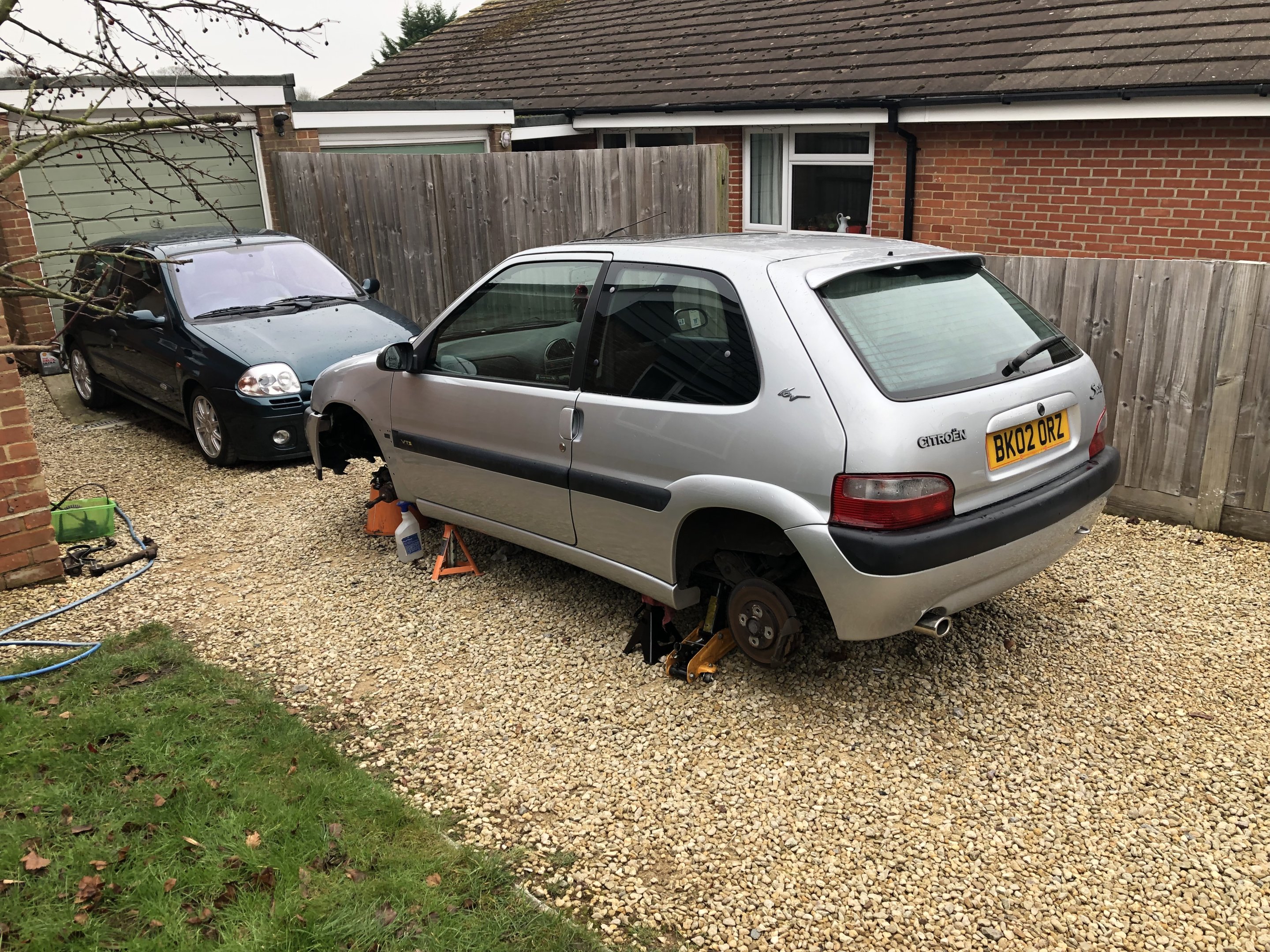

Going to put the car on stands and get the wheels refurbed with new tyres this week.
Hopefully by end of Jan this will all be done and motd.
Add new shocks to that list now, want gas filled rather than oil. Plus pretty sure drivers side front is leaking.

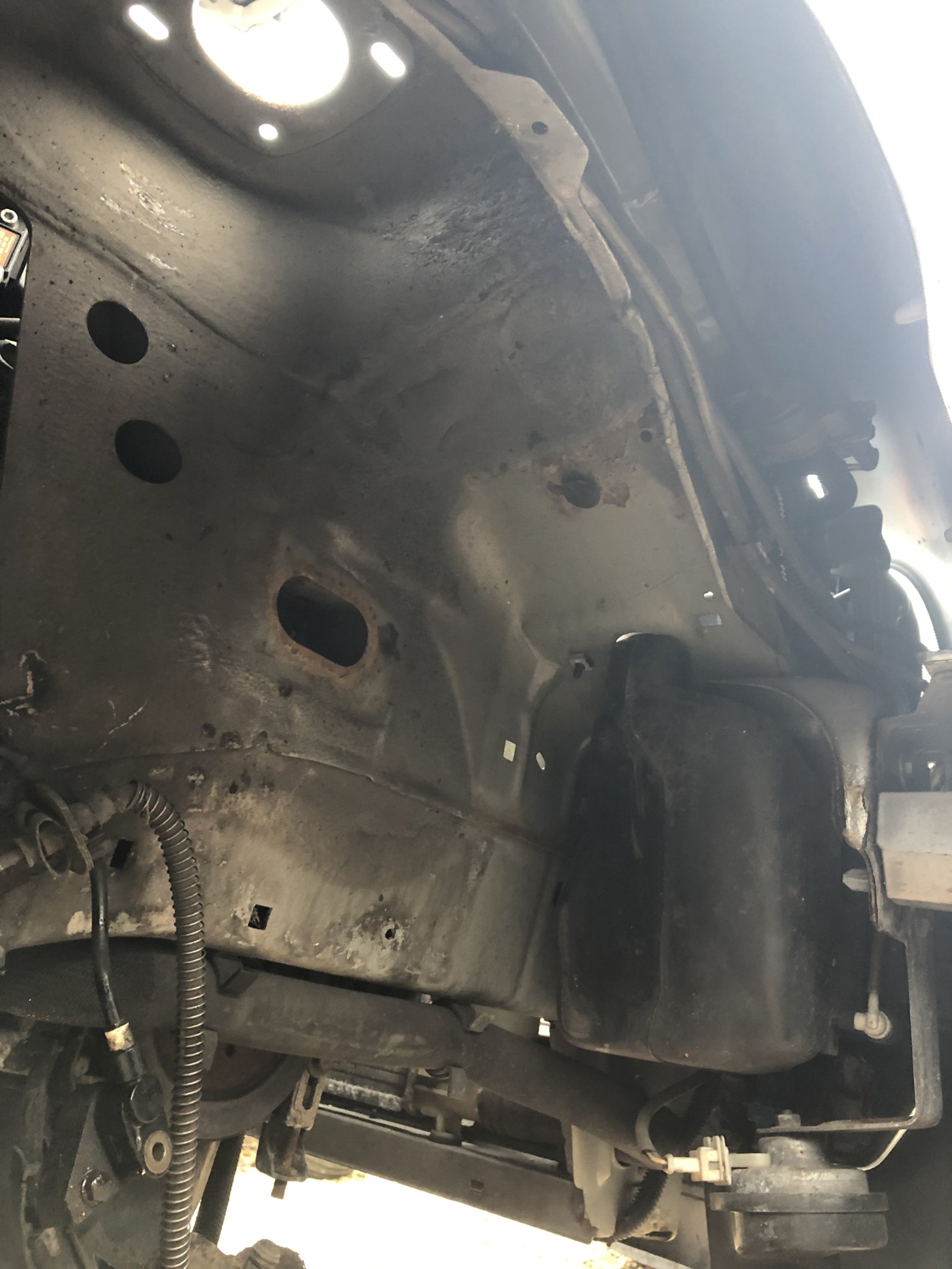

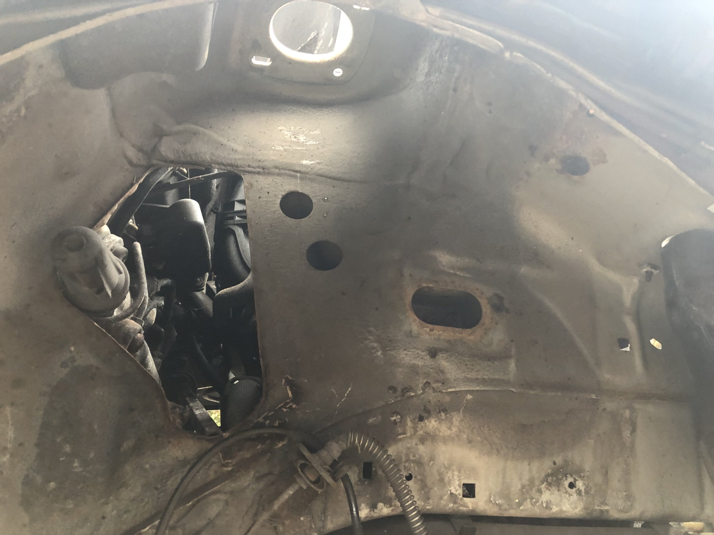

Started striping all suspension off the front end for replacement. Wishbones have never been changed as foam was sealed inside car. Can’t conplain with that! Going to wire brush it all back, paint and seal. Also well chuffed with boot floor!
Passenger side removed and given a very quick clean to what’s under dirt happy days.

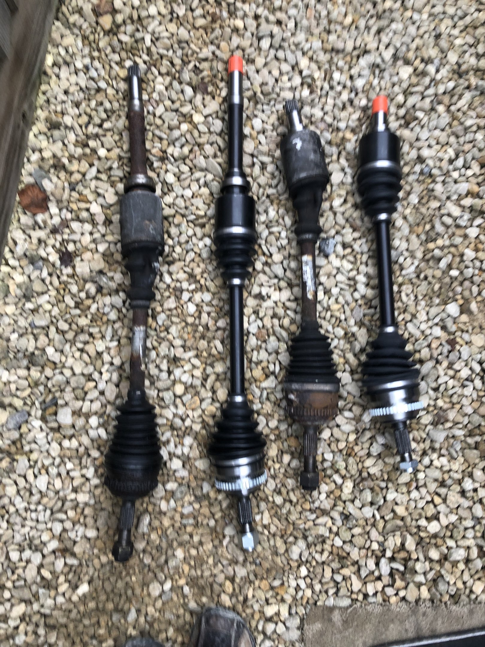

- New driveshafts
- New springs

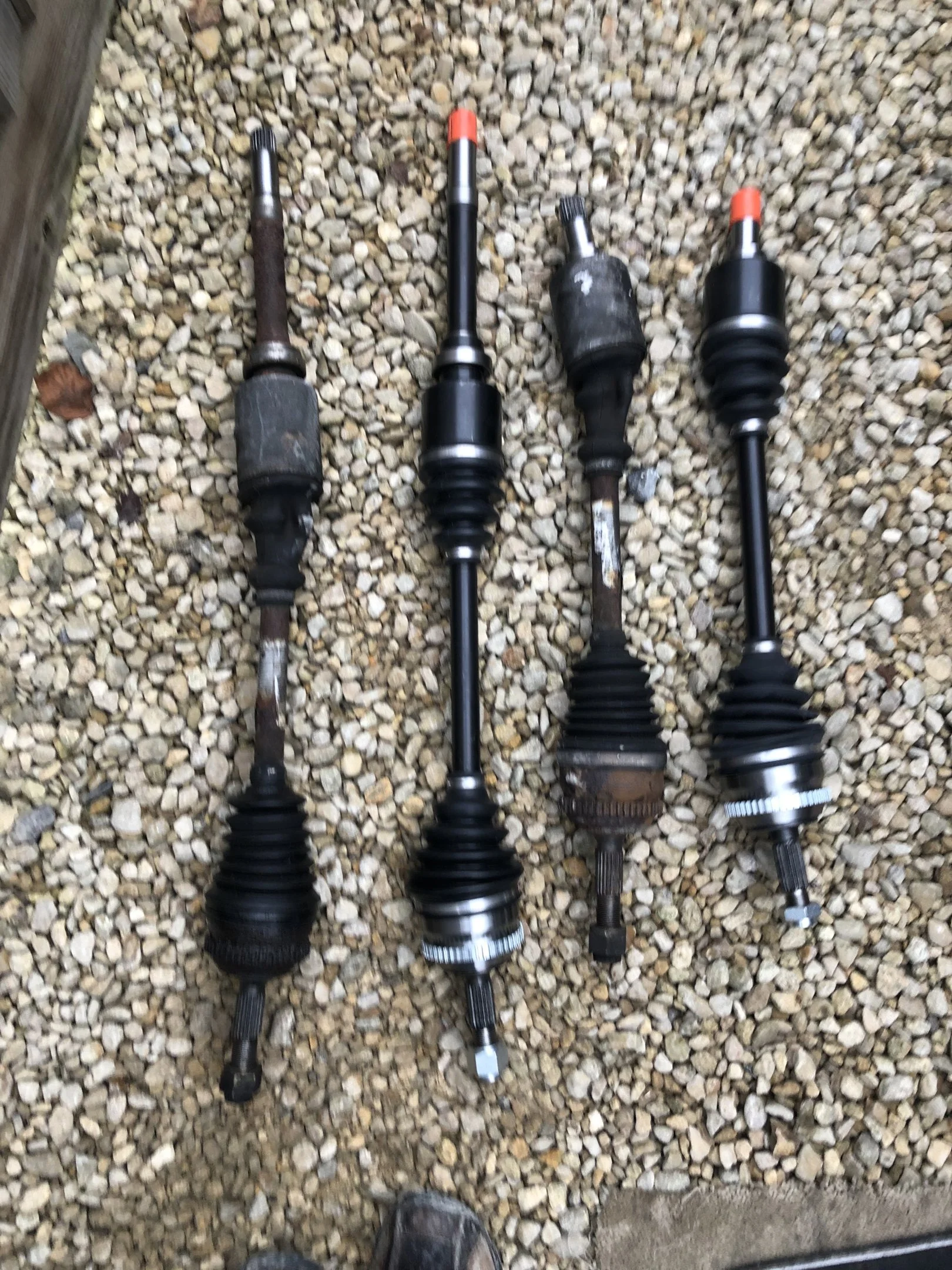

J and r shafts are decent apparently
That’s what I ordered. £70 for both off eBay, can’t complain.
ABS rings have seen better days on the current set so might as well swap them out whilst it’s apart.

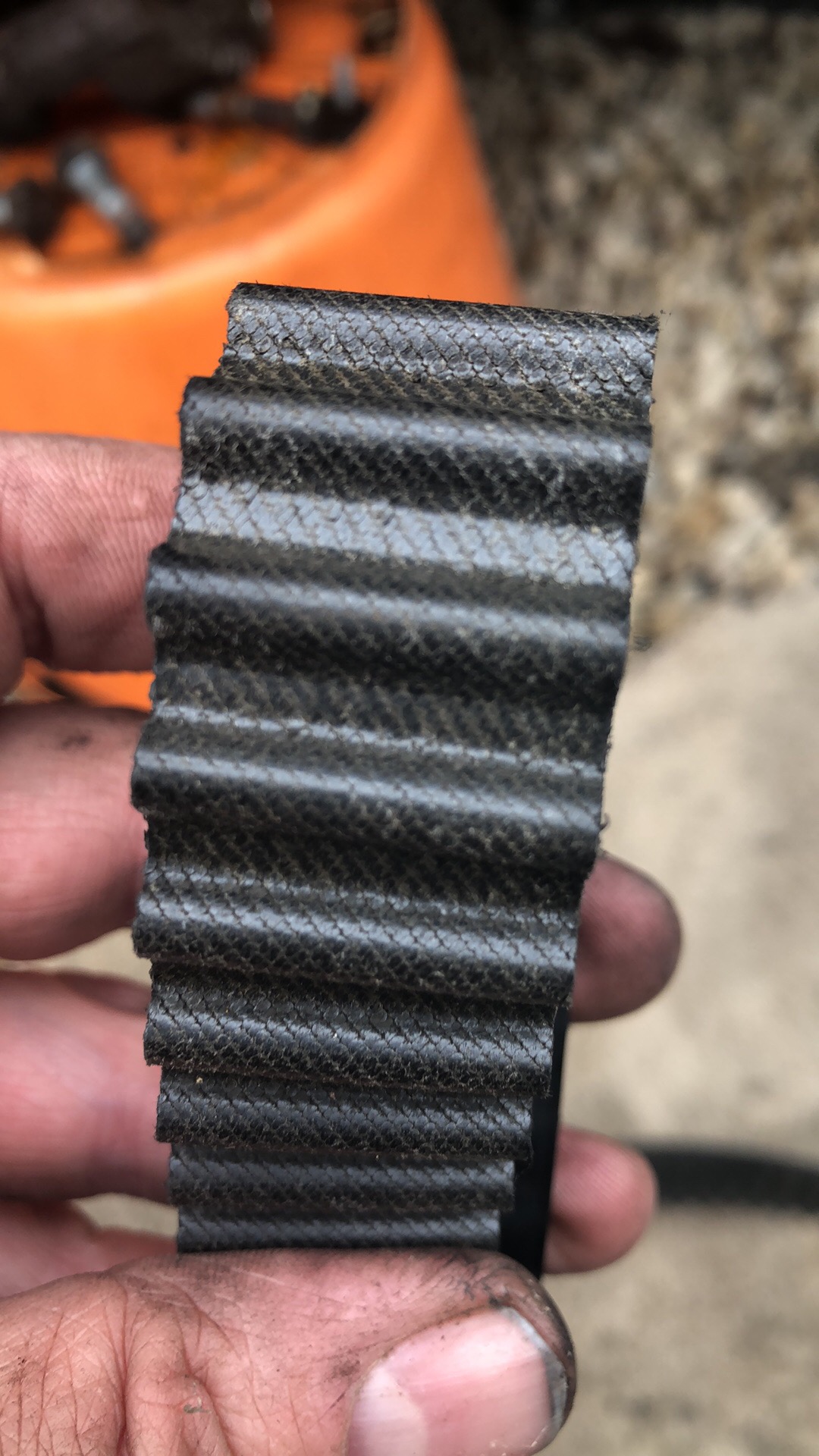

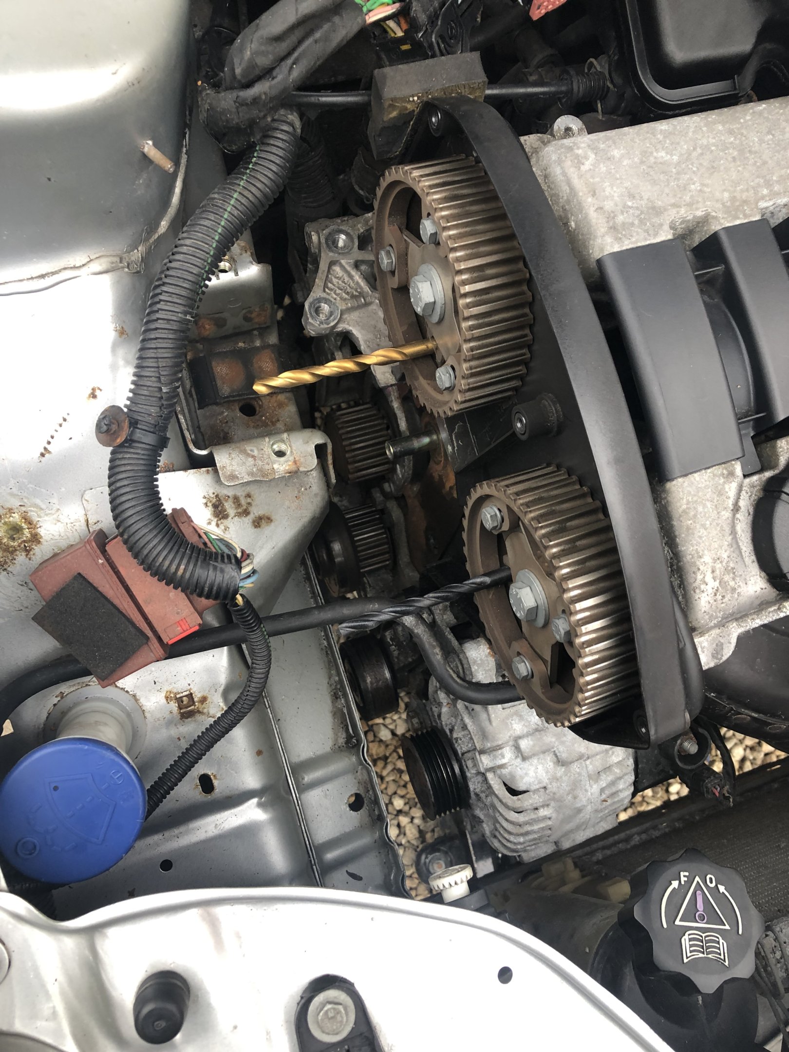

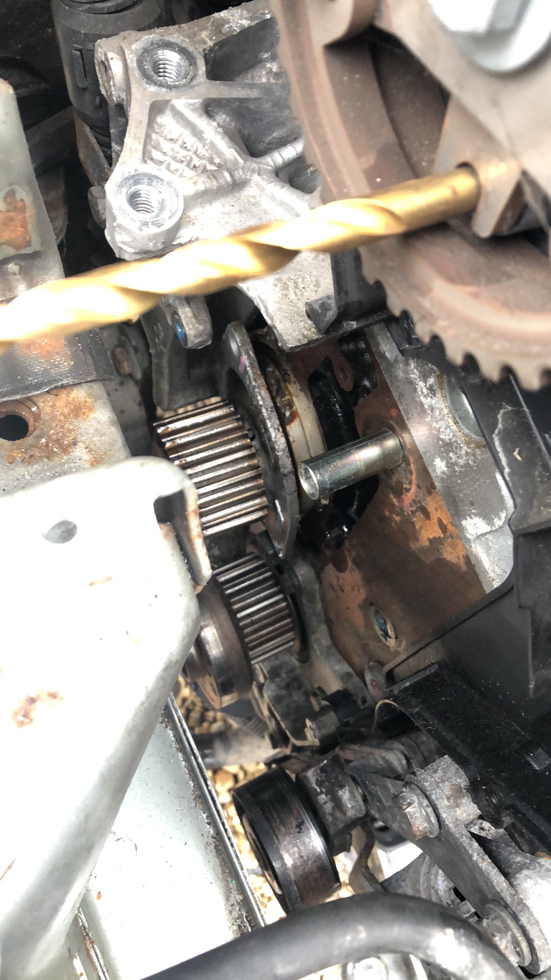

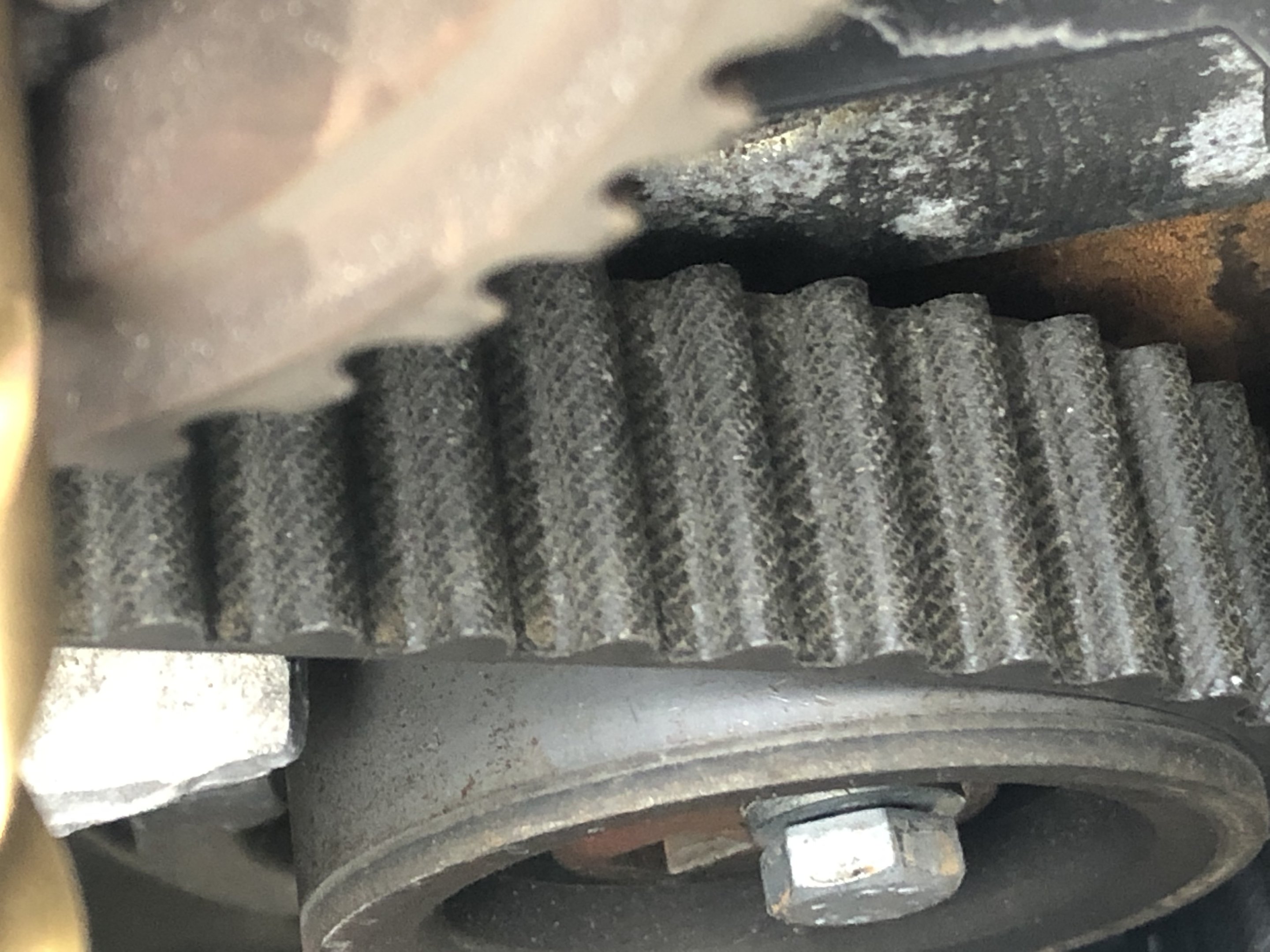

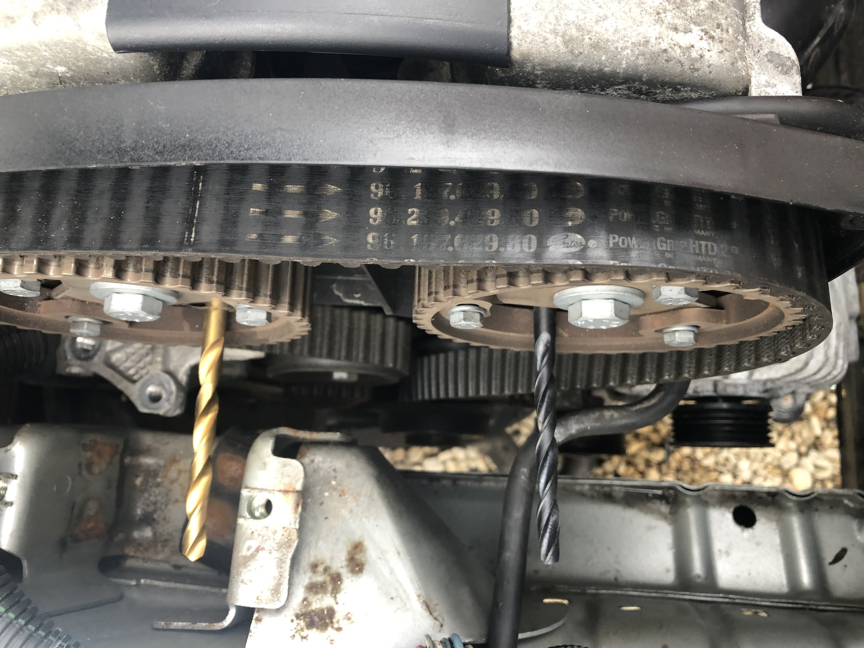

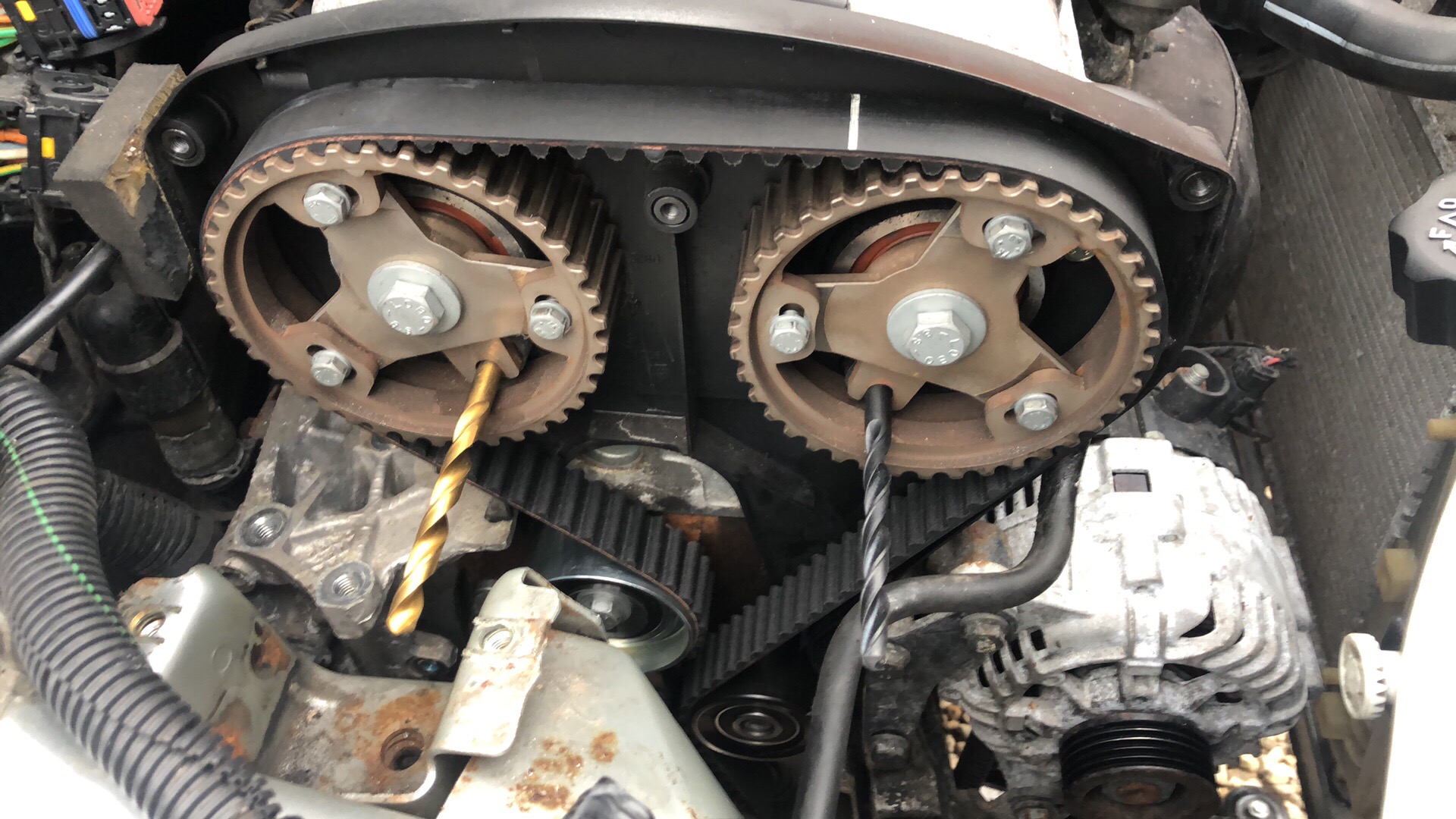

Cambelt today. Looks like it’s the original belt due to some foam items that have to be broken to remove cam cover.
Belt seems to be in good nick with no cracks.

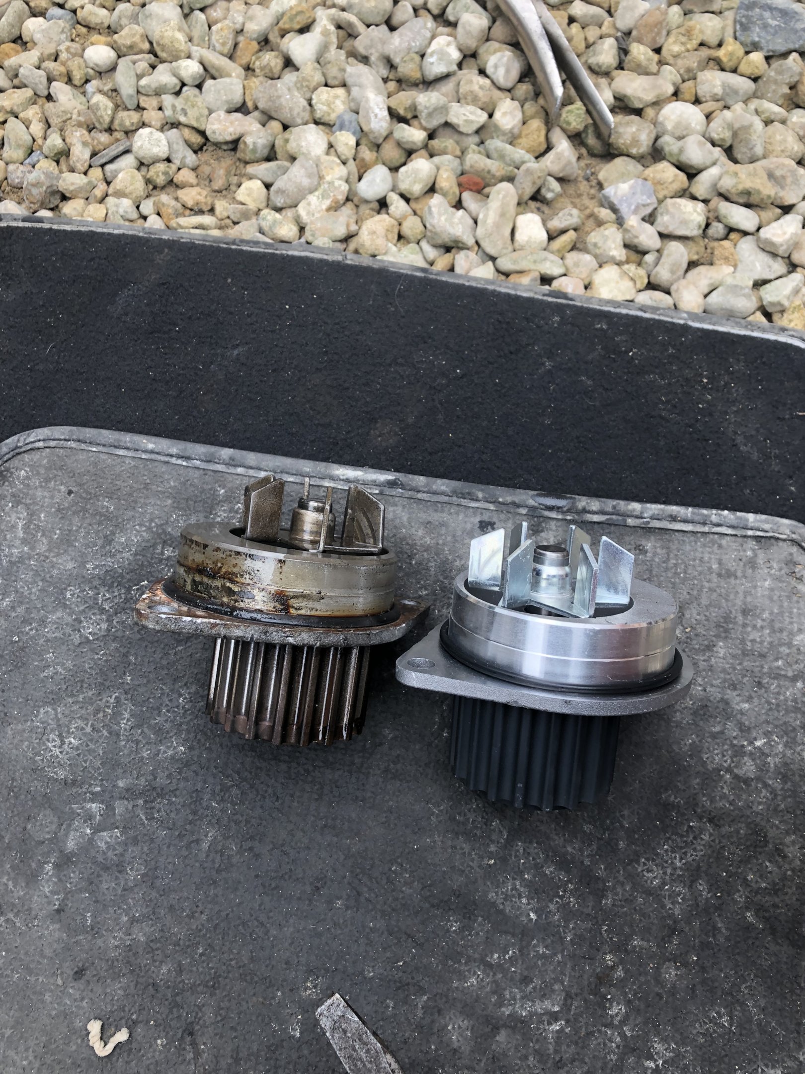

Idle pulley and waterpump was fairly straight forward to remove. Usually the water pump is a c**t due to seizing itself into the block.

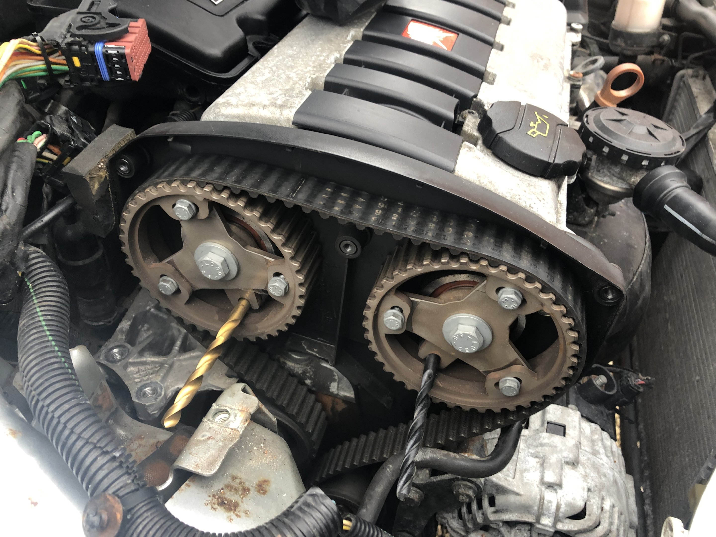

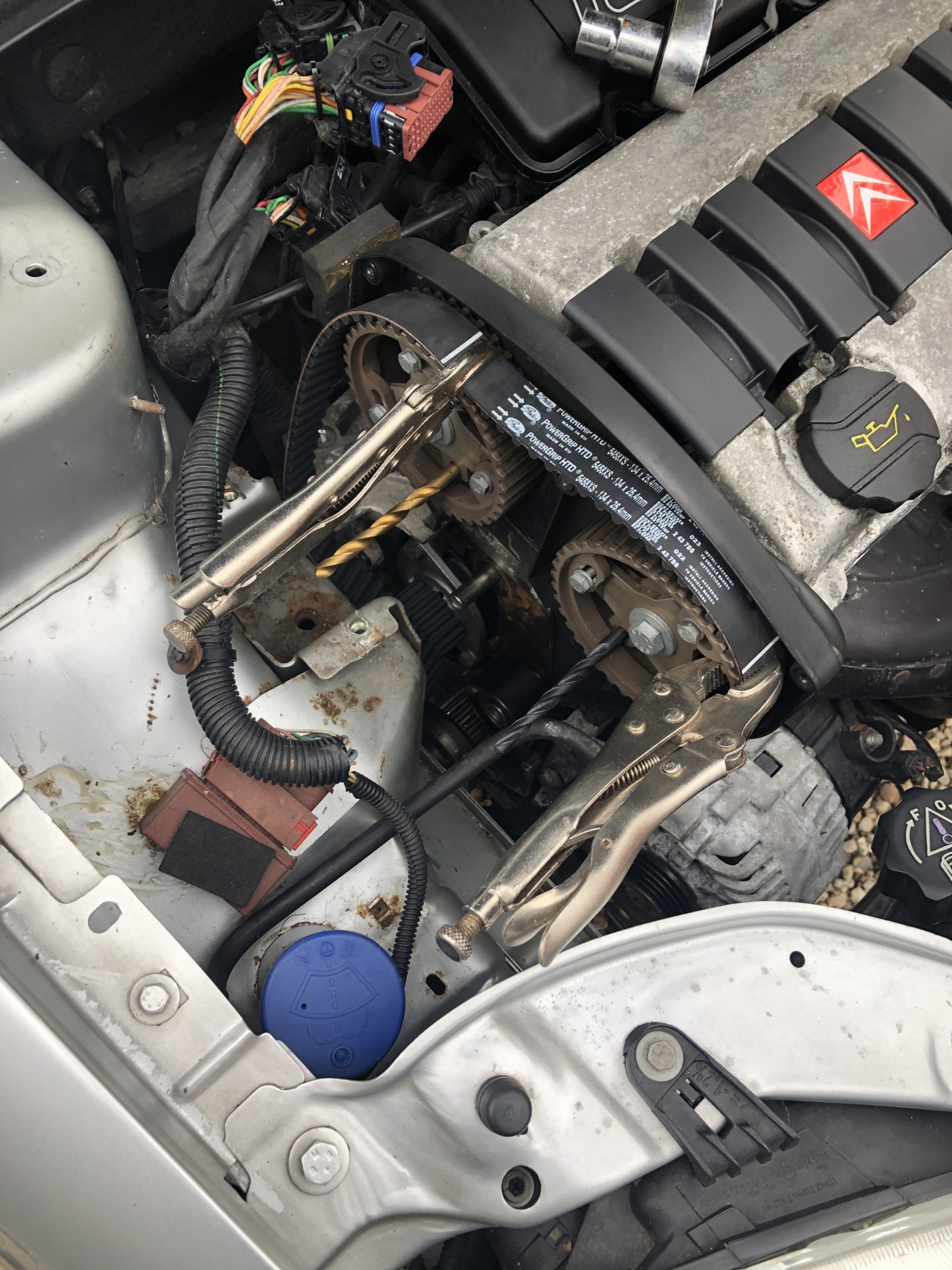

Fitted new belt and tensioner, tensioned as per guide by pushing down and forward at the same time. Grips removed at that point.
Removed locking pin from flywheel and cams. Rotated engine by hand 5 times, put locking pins back in and checked everything lined up, removed again and rotated another 5 times and again re inserted locking pins. All looks good.
Tomorrow I will fit new auxiliary belt, thermostat and fill with fresh coolant and start..... hopefully the tension is correct.

Tip top top tip:
Use bulldog clips to hold the belt, less chance of marking the belt and creating stress raisers.
Tip top top tip:
Yep I agree, didn’t have any to hand. The moles are very loosely on so would full off with a knock.

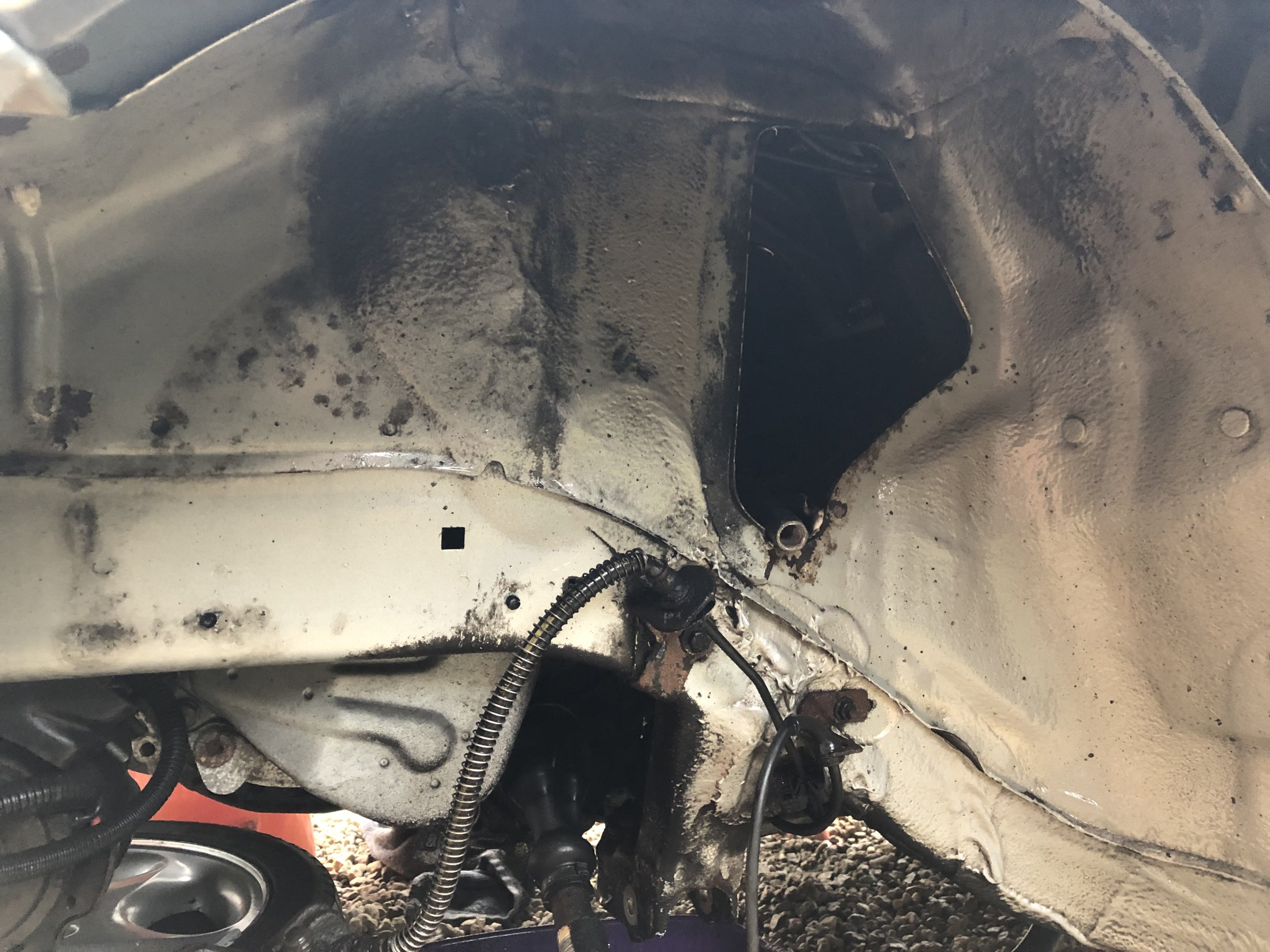

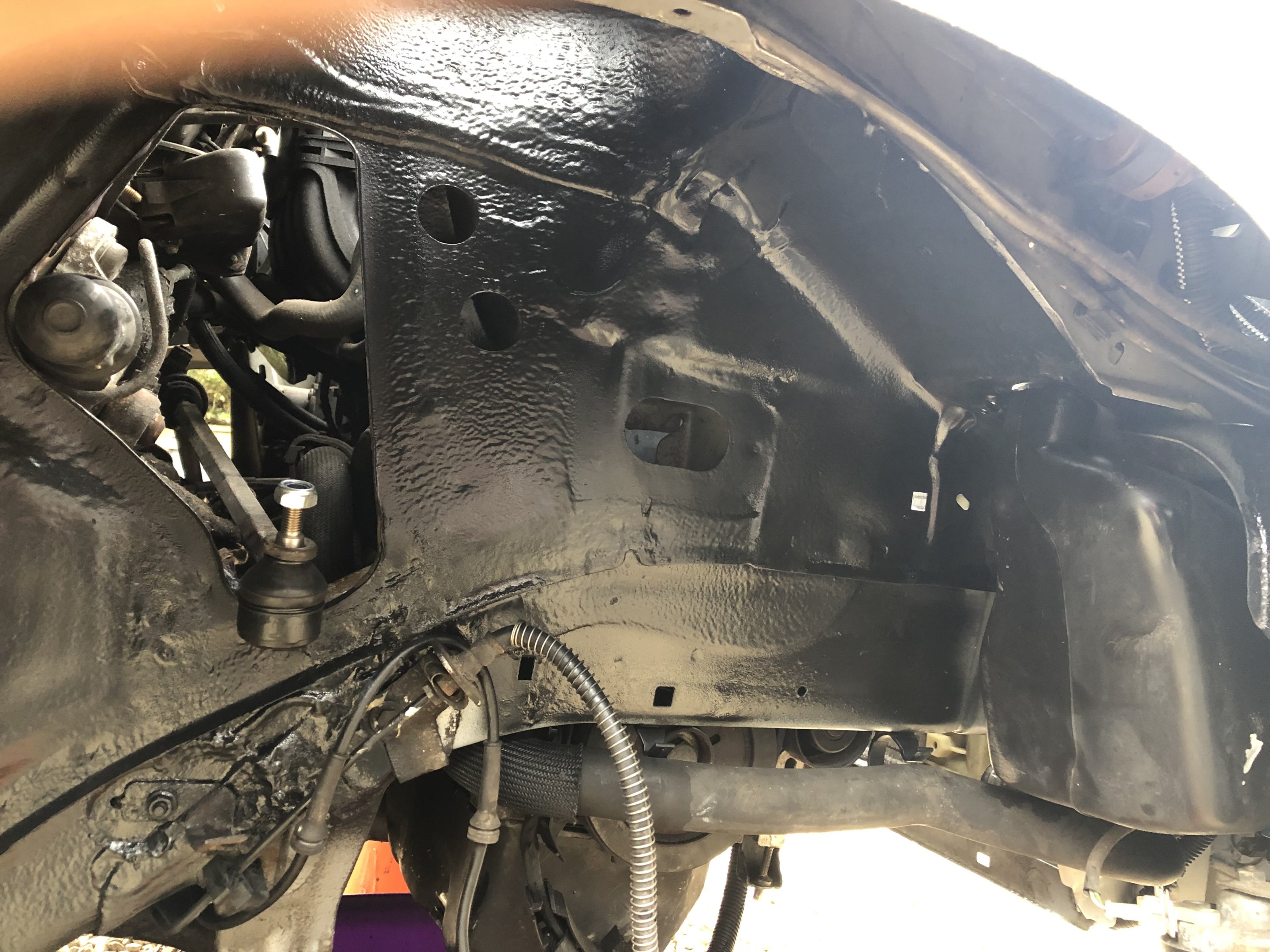

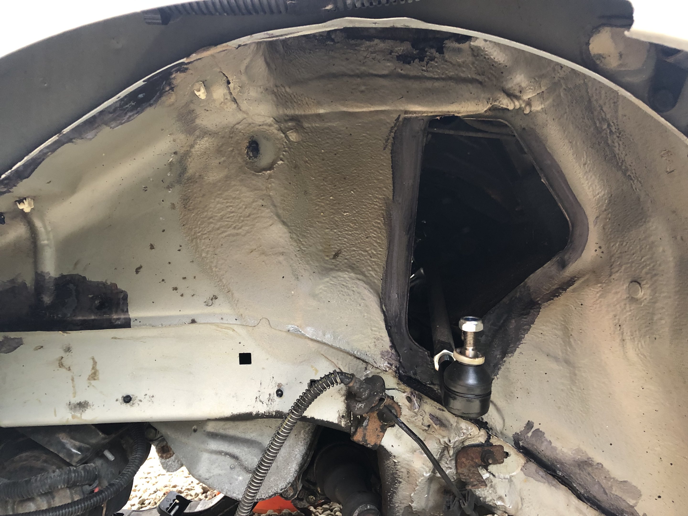

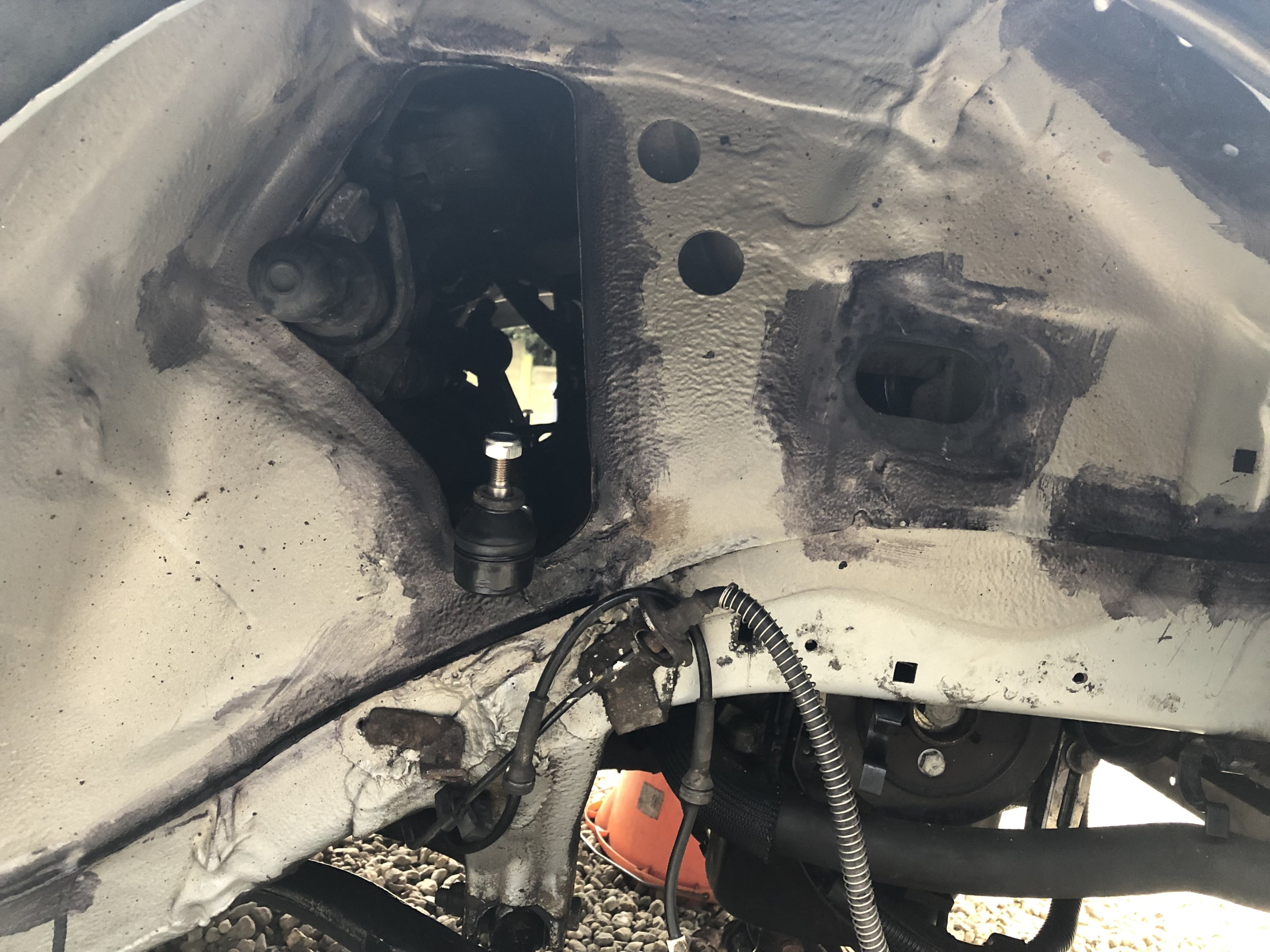

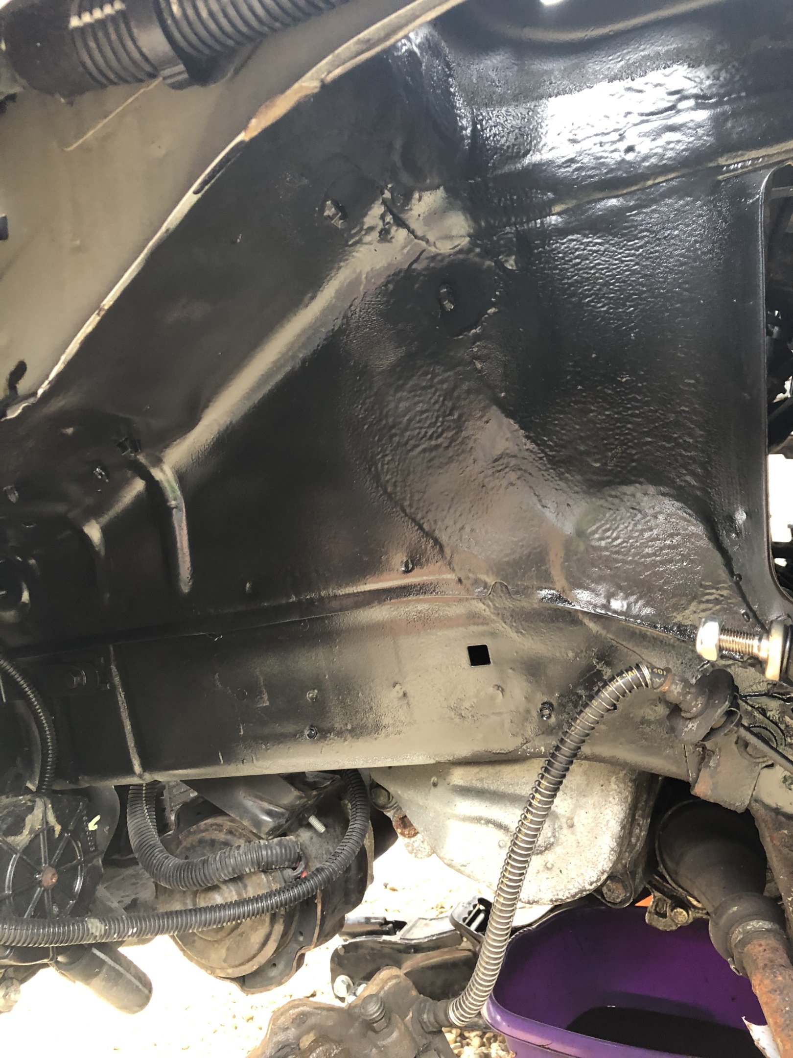

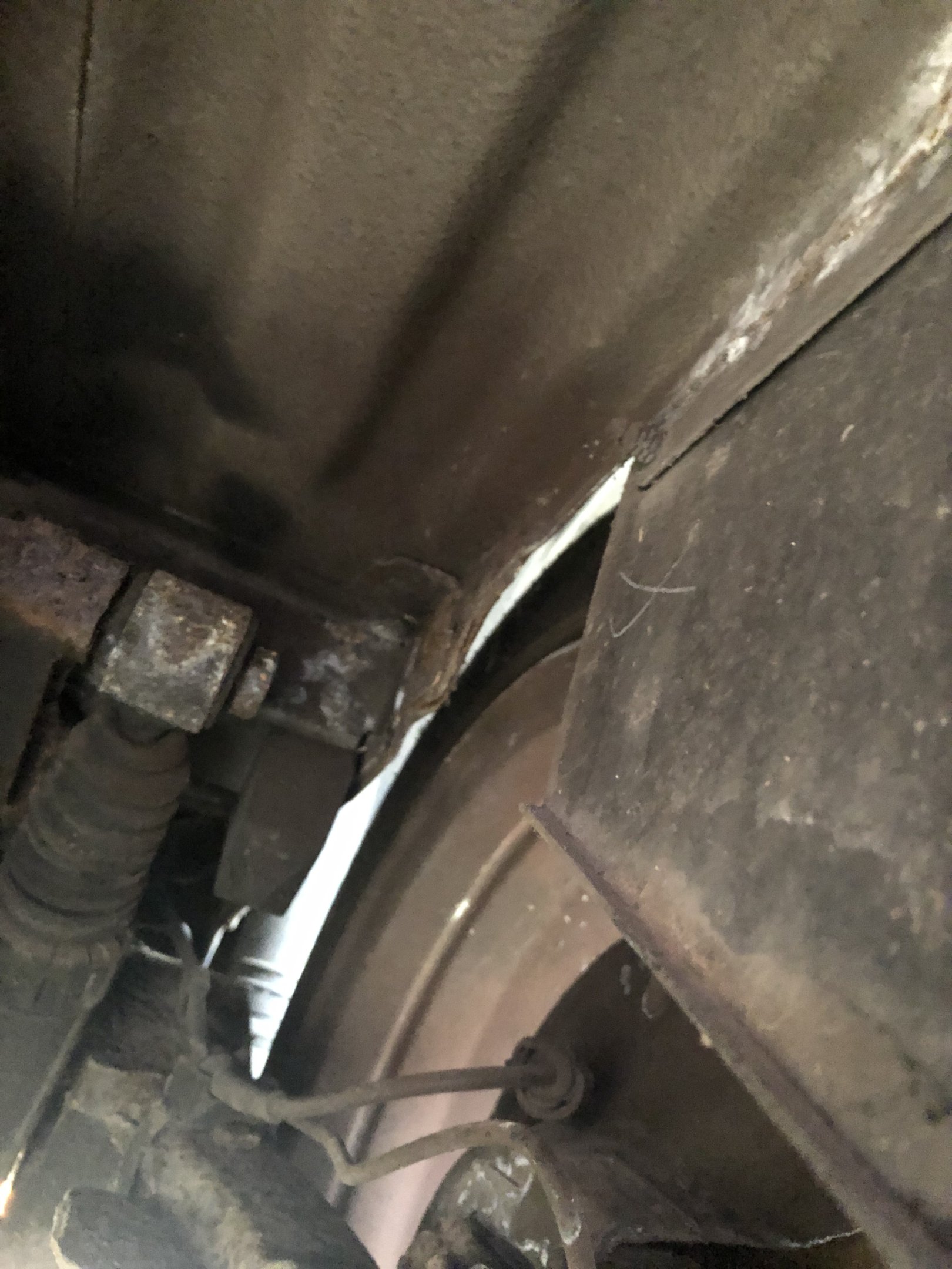

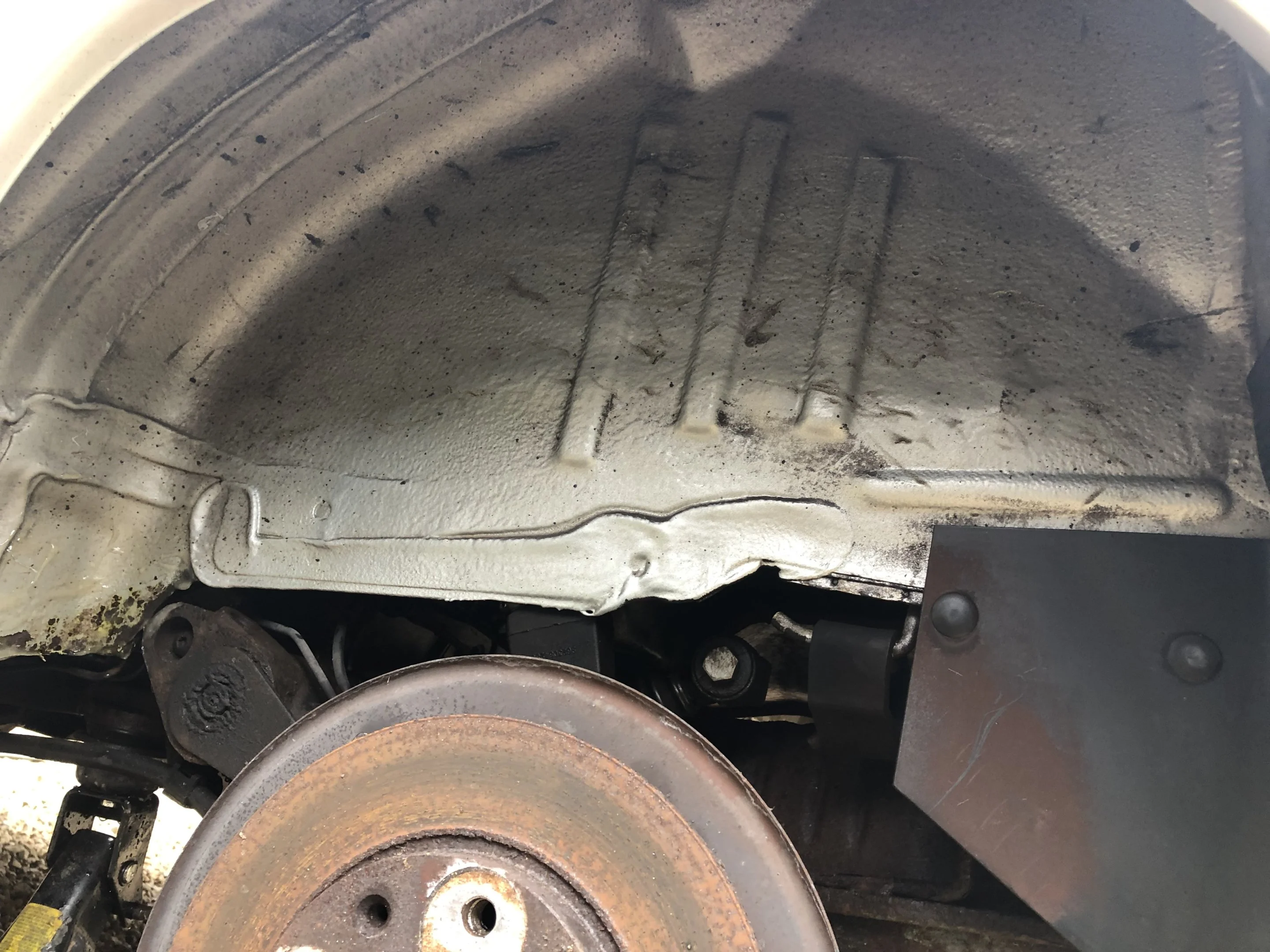

Arches stripped back and treated usual areas, didn’t need it but if I treat now it will stop anything starting.

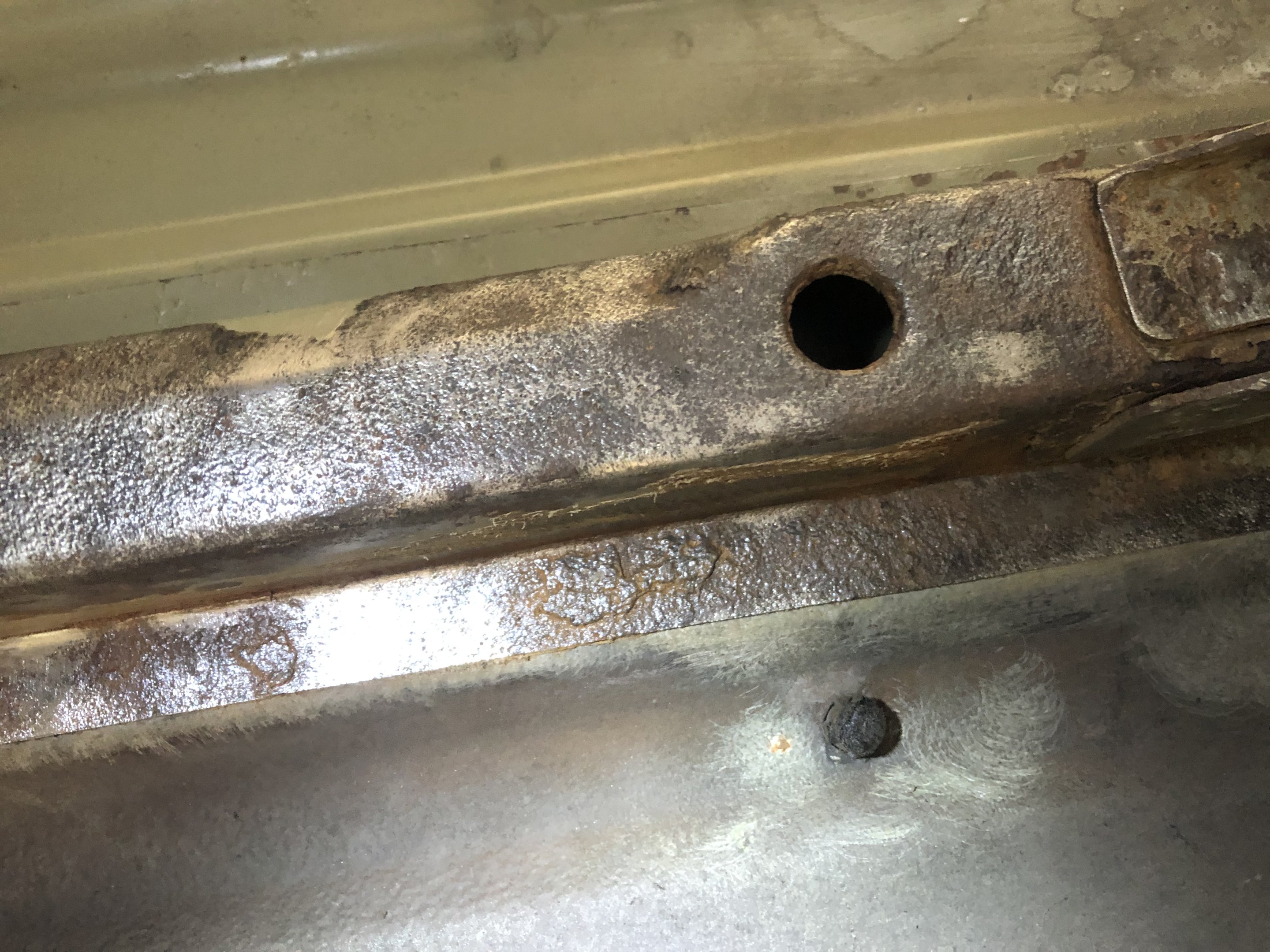

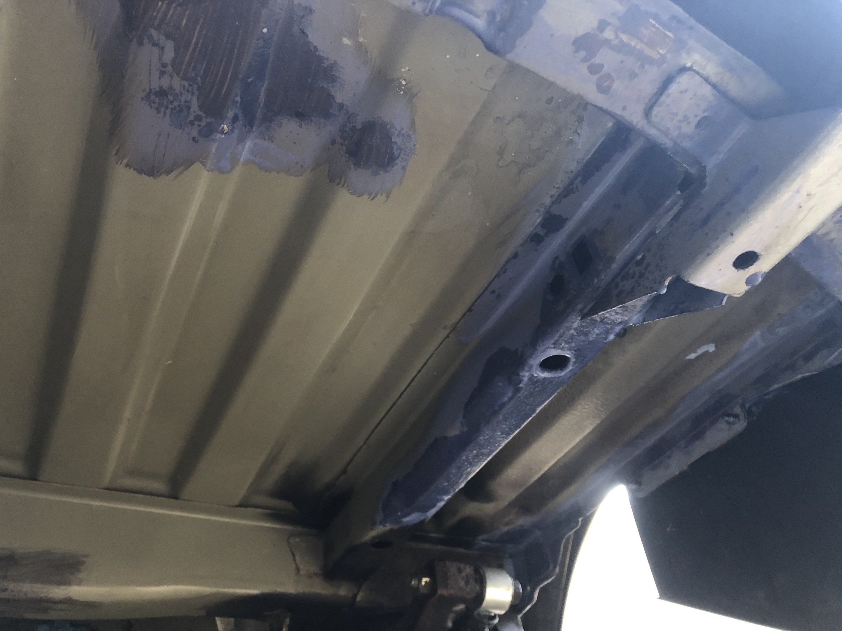

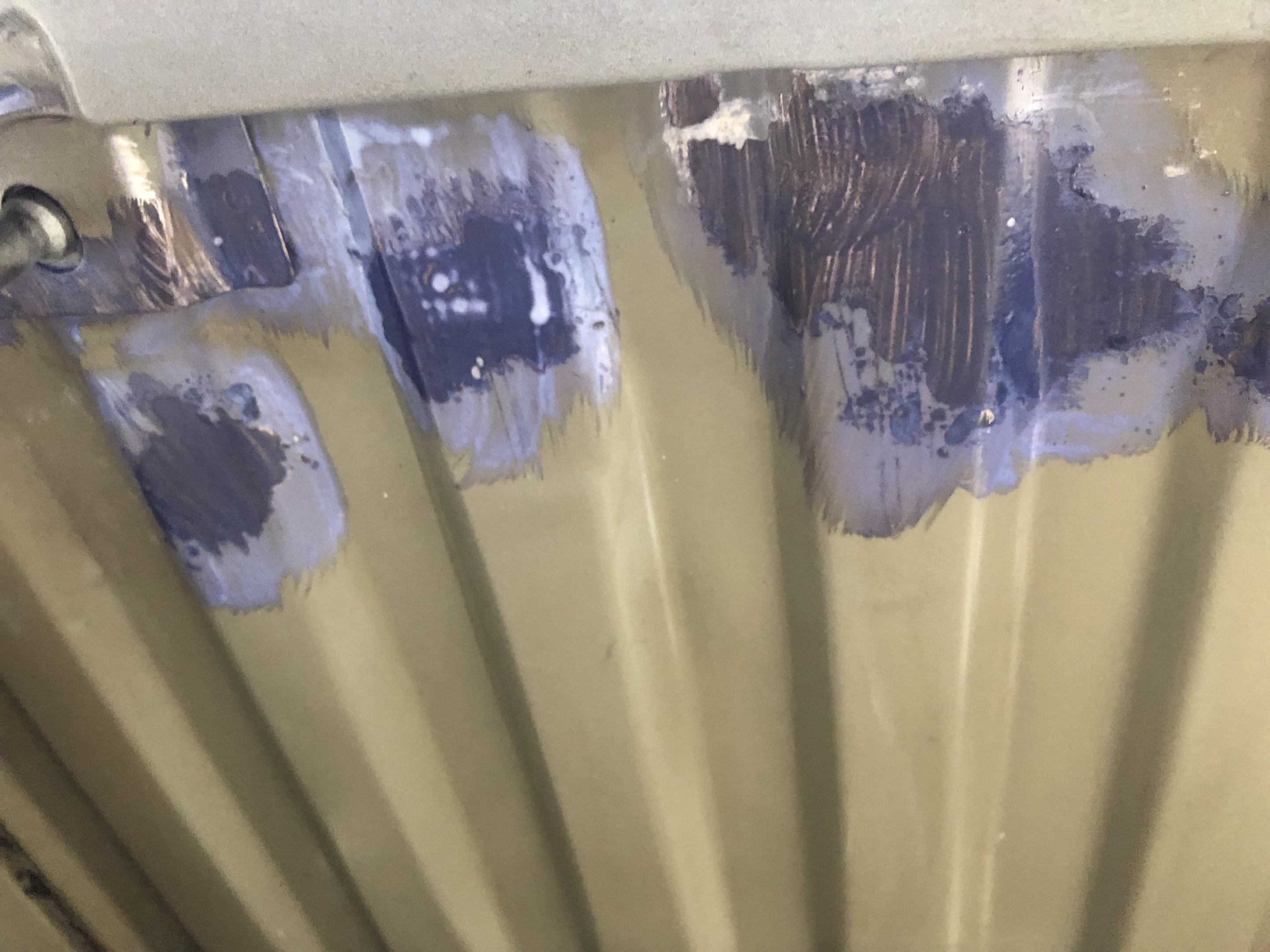

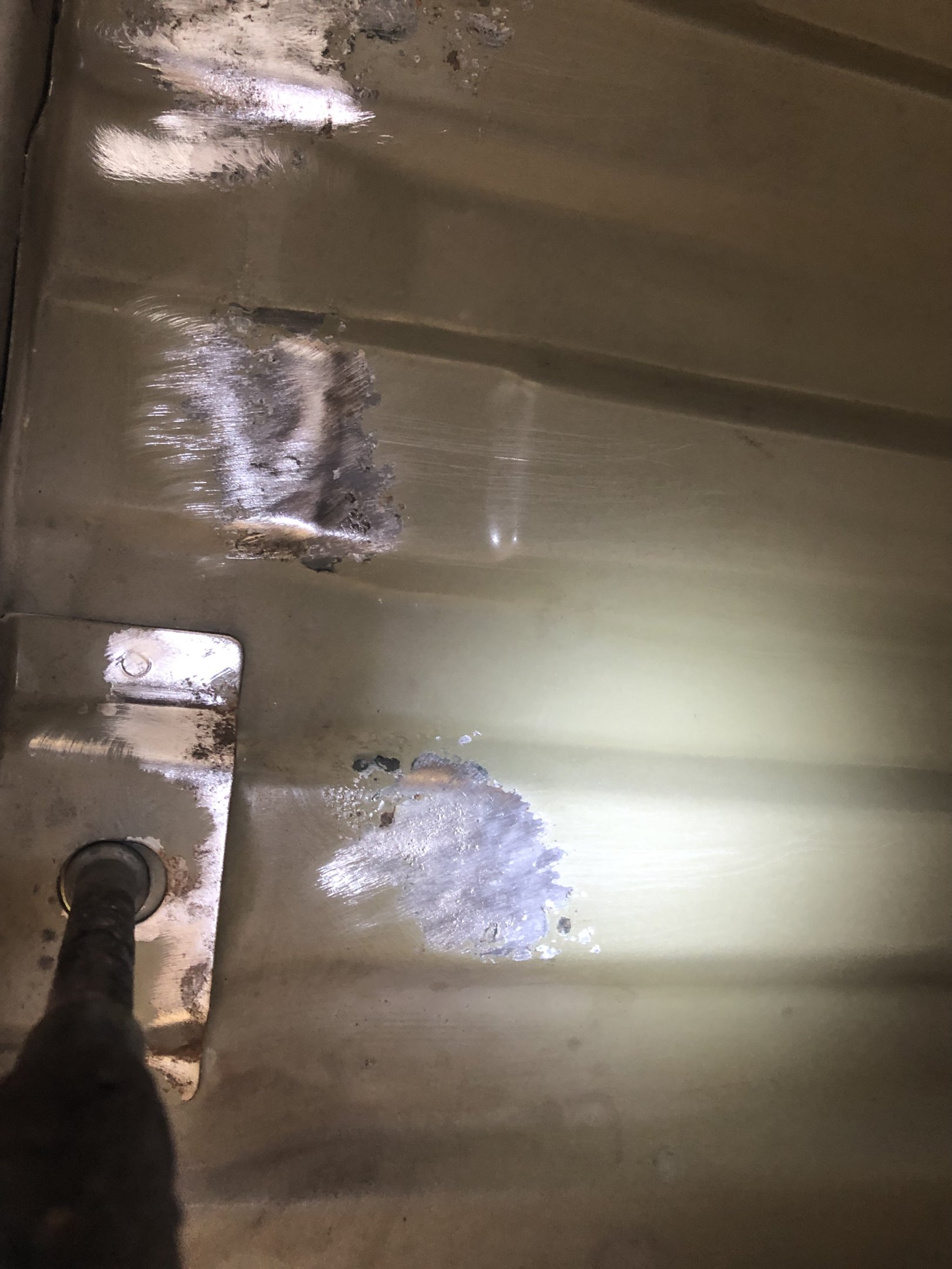

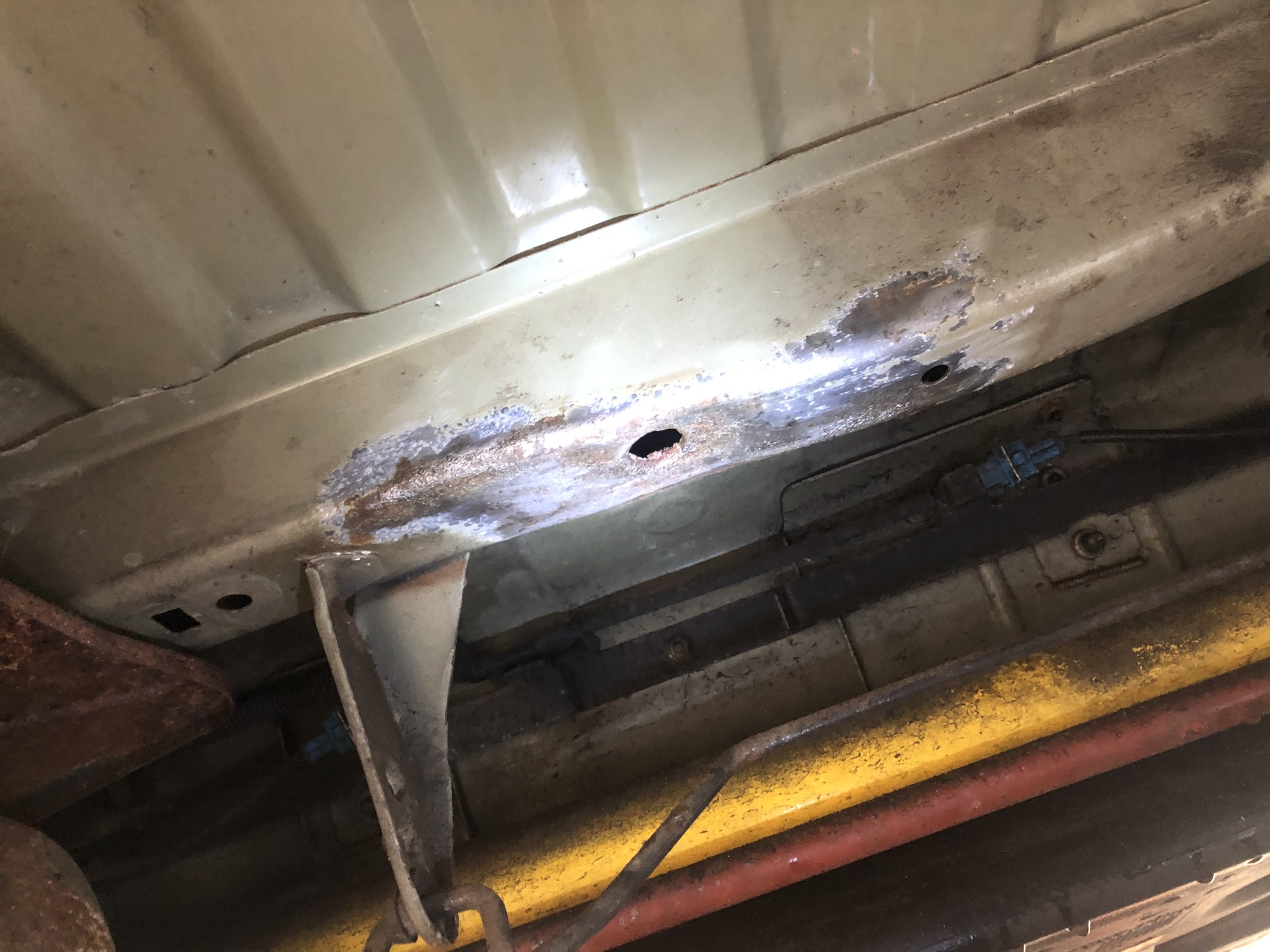

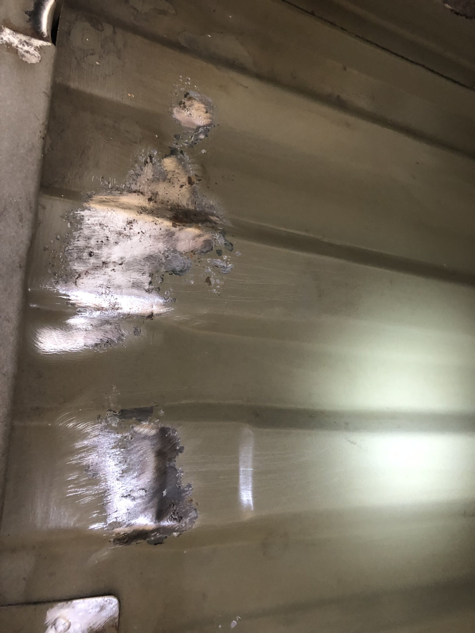

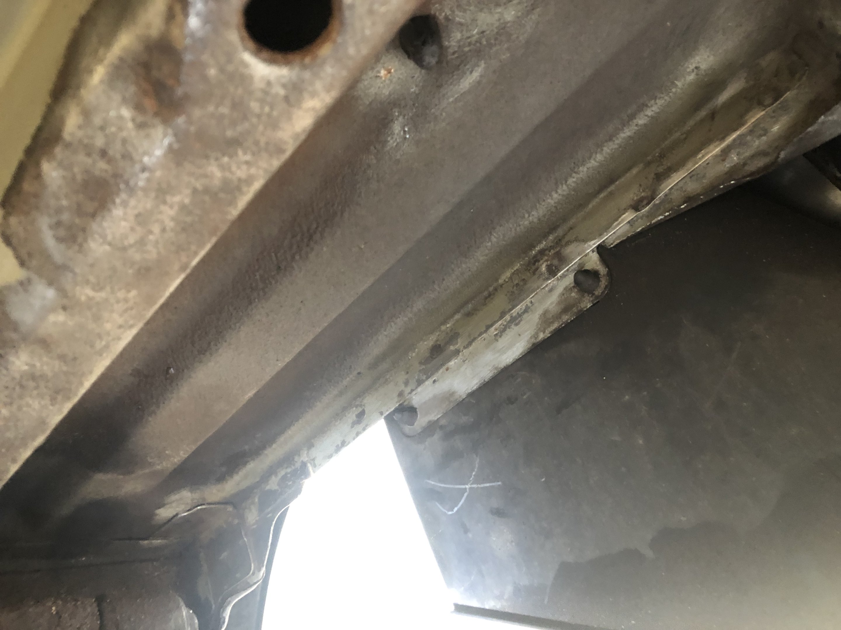

spent the morning looking over boot floor. I could see the spare wheel bag was holding water up against rail so wanted to treat the area.
Dropped wheel and brushed back anything that had surface rust.
Not a lot if any but not taking any chances. Waiting for treatment to set than whole boot floor will be cleaned again and sealed. Won’t have to worry about it again.

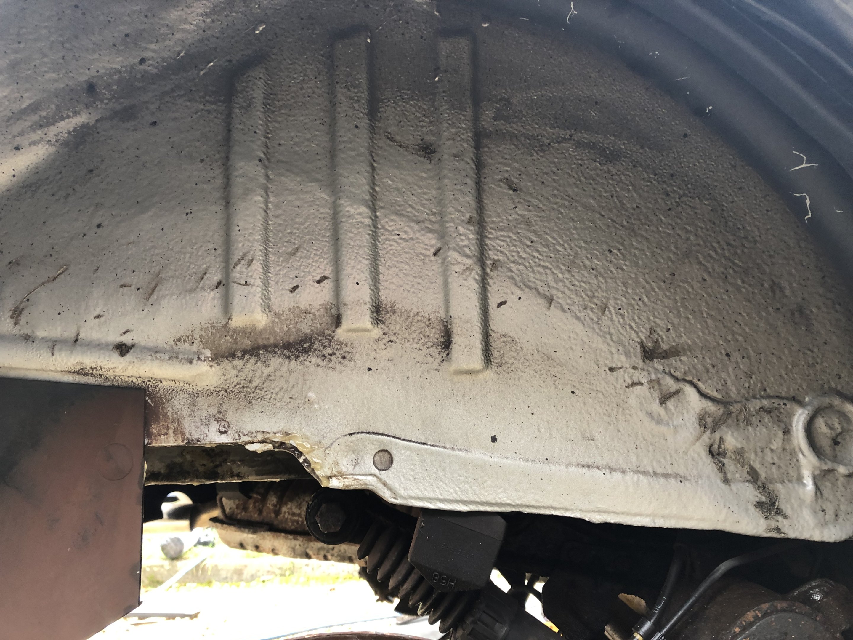

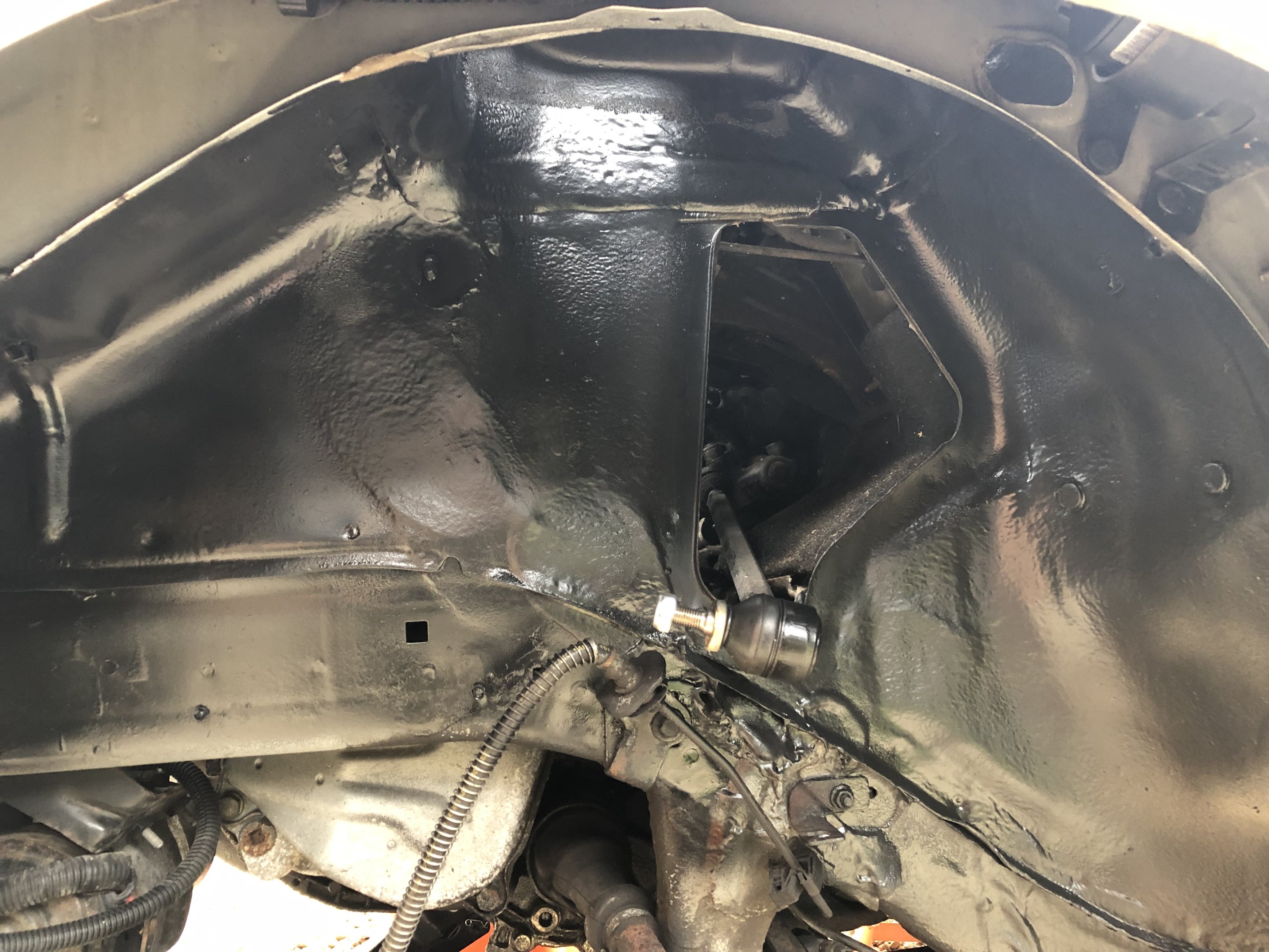

Also sealed the front arches with dintrol chip wax. Cracking product would of liked silver finish but it does the job and again I want it to last and be protected as nothing added from factory.
Boot floor
Front arches

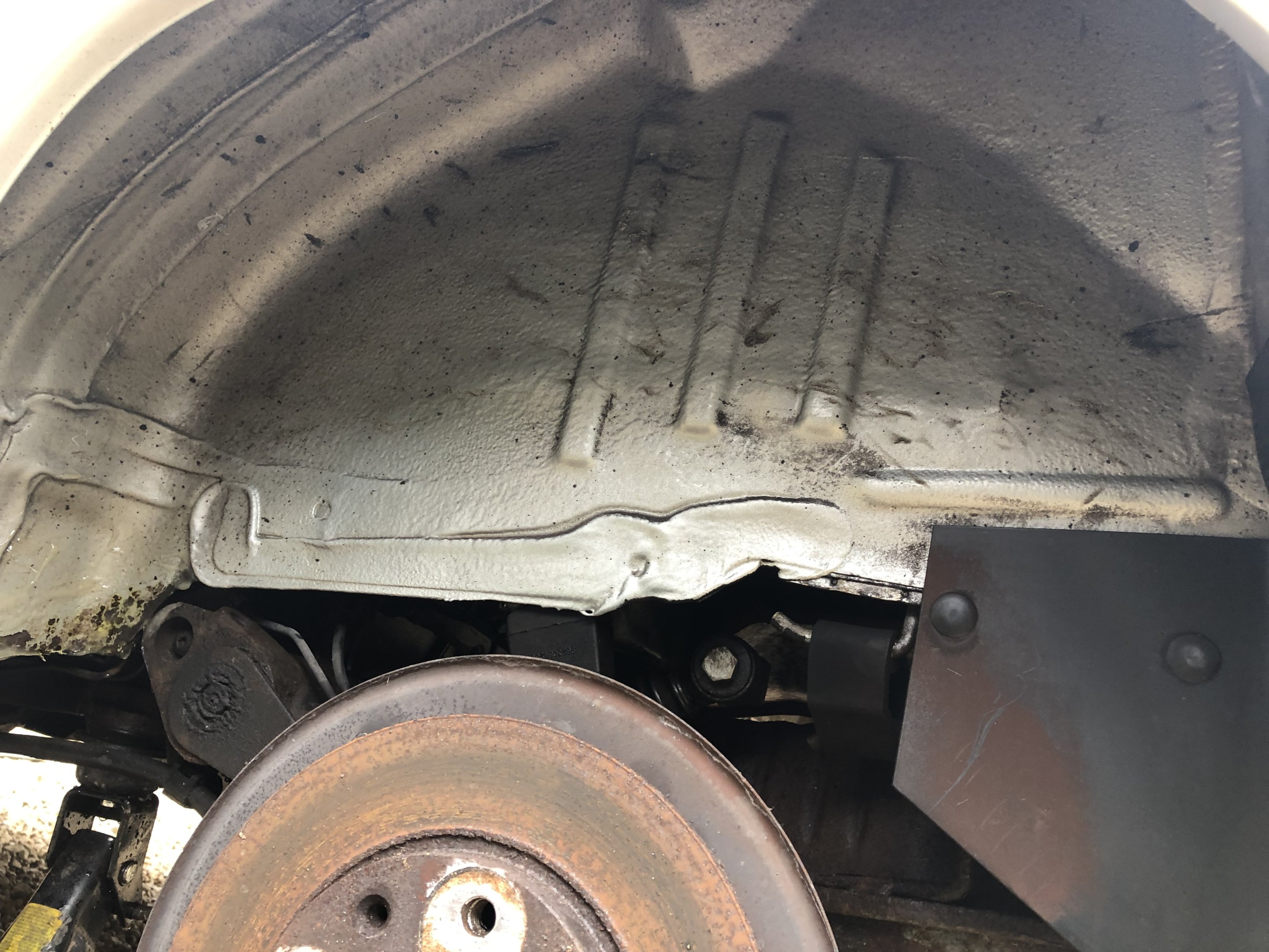

Also started cleaning the rear arches. Nothing to be seen here so degrees, dry and seal.
Boot floor has now been treated to prevent anything from springing up. Interestingly the surface area treated is where the spare tyre was rubbing against floor. Also having the spare wheel bag around the wheel can’t be a good thing hasn’t it holds moisture up against floor.
Anyhow tomorrow I will zinc prime and seal with the same stone cheap sealent I used in the wheel arches.
