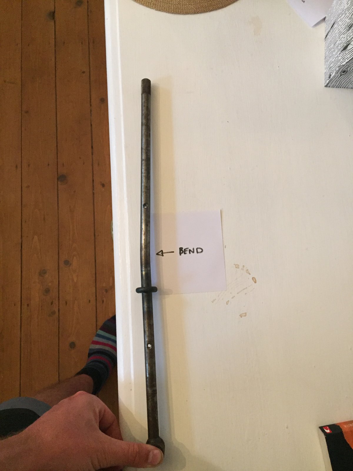

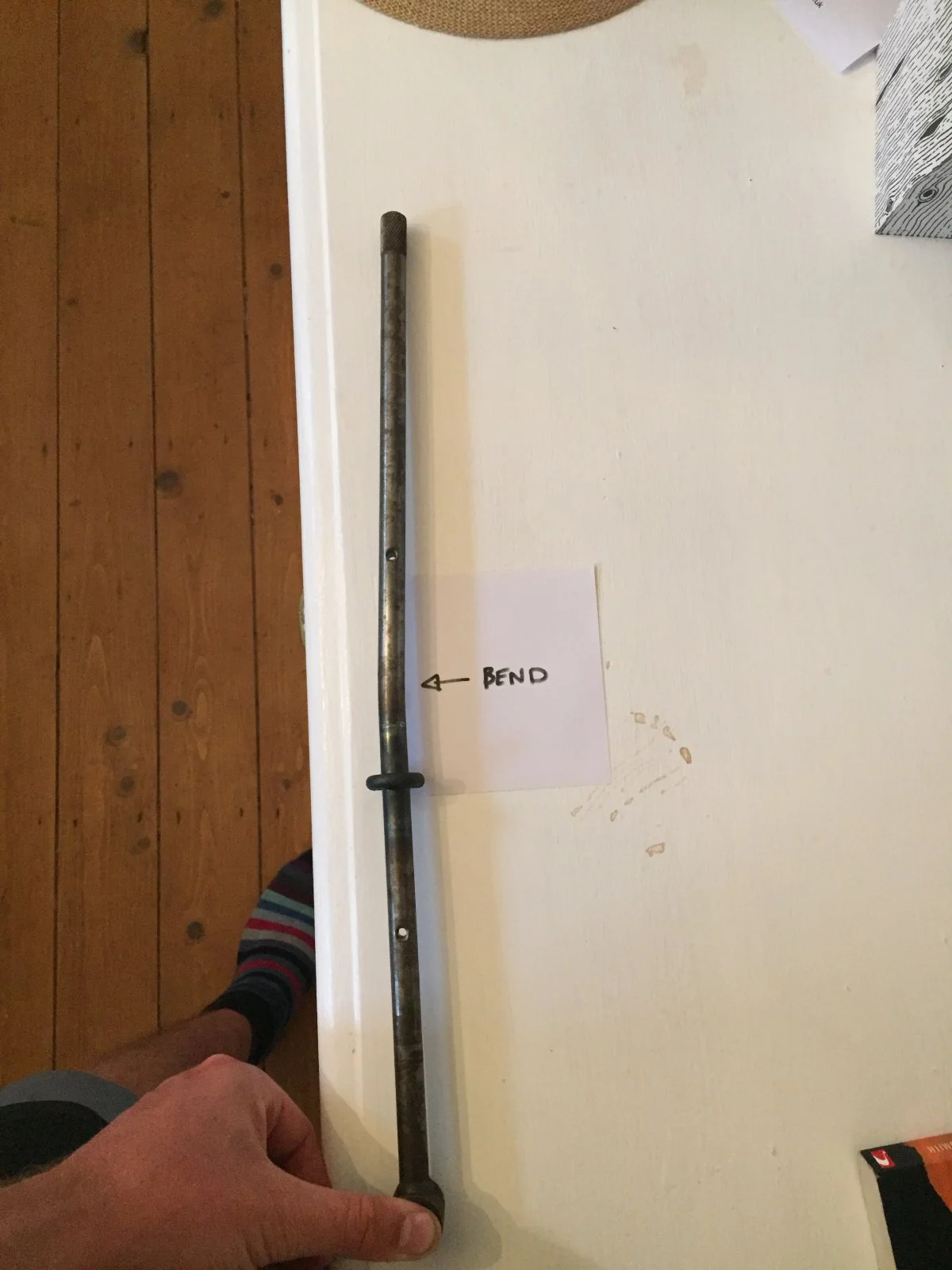

the shaft (ooo err) on my shifter already has a slight bend i reckon this will be a good bend point just below the top slider but how far???? Don't want to end up with It on top of the handbrake lol

I gave the shaft a little bend today (gear stick that is ), haven't fitted to the car yet but it was easy enough to bend. Stick the top half in a vice with a screw through the hole to keep straight. There was a slight bend in mine already roughly where the reverse lifter wire connects so I positioned this at the edge of the vice. Slide a piece of galv steel tube on the exposed side and give it a pull. Doesn't take much to bend.
I bent it so the top is roughly 1cm back from original position, will see if it works when I get it fitted

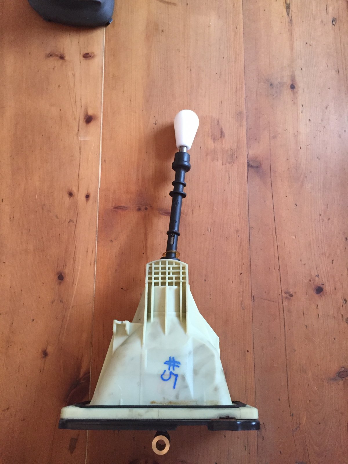

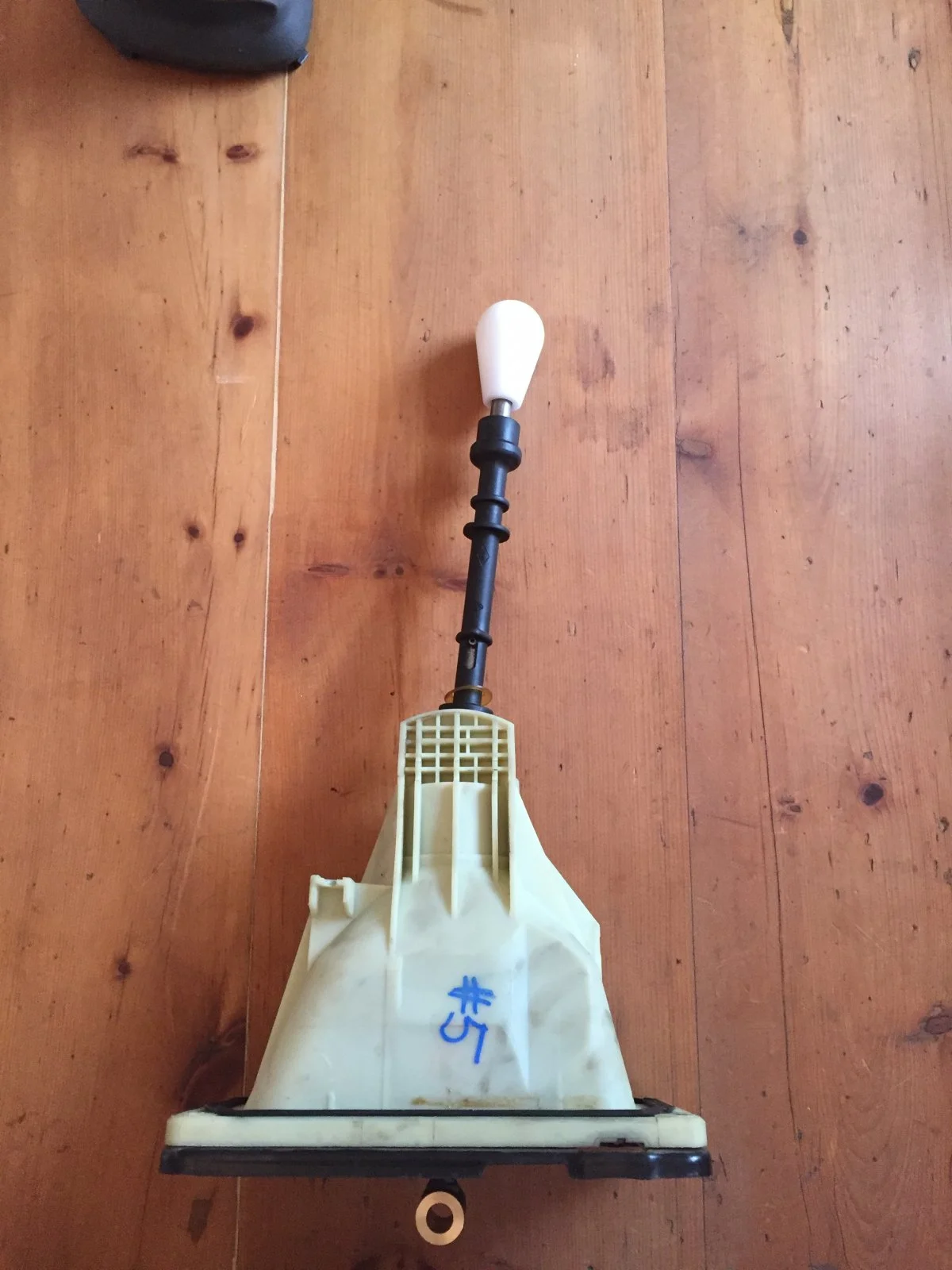

I thought a bit off both might work, so I the stick only a tad and hopefully can adjust the linkage if it needs some extra
It's ready to go in now, doesn't look much of a bend now so if the rain stays off I'll get it in tomorrow and see how it is.

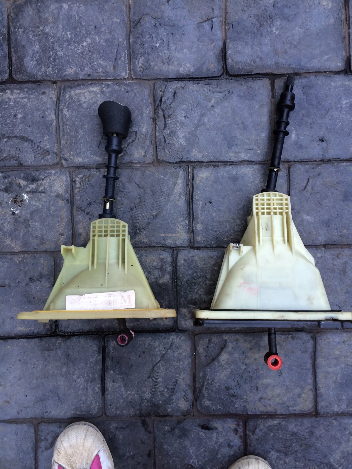

That doesn't look more bent at all! Have you bent it the wrong way?
Look at the one on the right, thats how you want it, check out those angles!

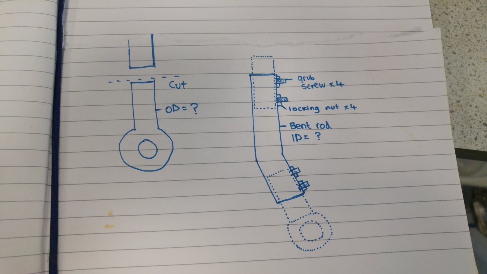

I'm currently awaiting on some parts so I can make this. It's going to consist of some metal tubing with some tapped threads.
You have to cut your linkage rod in half, then slide the two parts in this pre-bent metal tube which not only tilts it back to where you want it, but also extends the rod shortening the throw. Just need to do some calculations to determine how big this rod should be for how much reduction in throw.
The ID of the metal tube is 120mm and the OD of the original gearstick is 195mm so it will be a snug fit, coupled with the 4 grub screws holding it in, which also have nylock nuts on them to secure it.
Excited to try it out, even if it doesn't work it's fun to know why/where to improve it.
Look at the one on the right, thats how you want it, check out those angles!View attachment 156083
That's a massive different compared to mine also looks like the lower section has been extended. I Definitely went the right way but only by a little bit. Might be ok for me I have orangutan arms

It has mate yeah, by about 40mm I believe. If you extend that bit then it will shorten the throw because physics.

No sorry, I mean the bit that is extended on the pic you've just seen.
