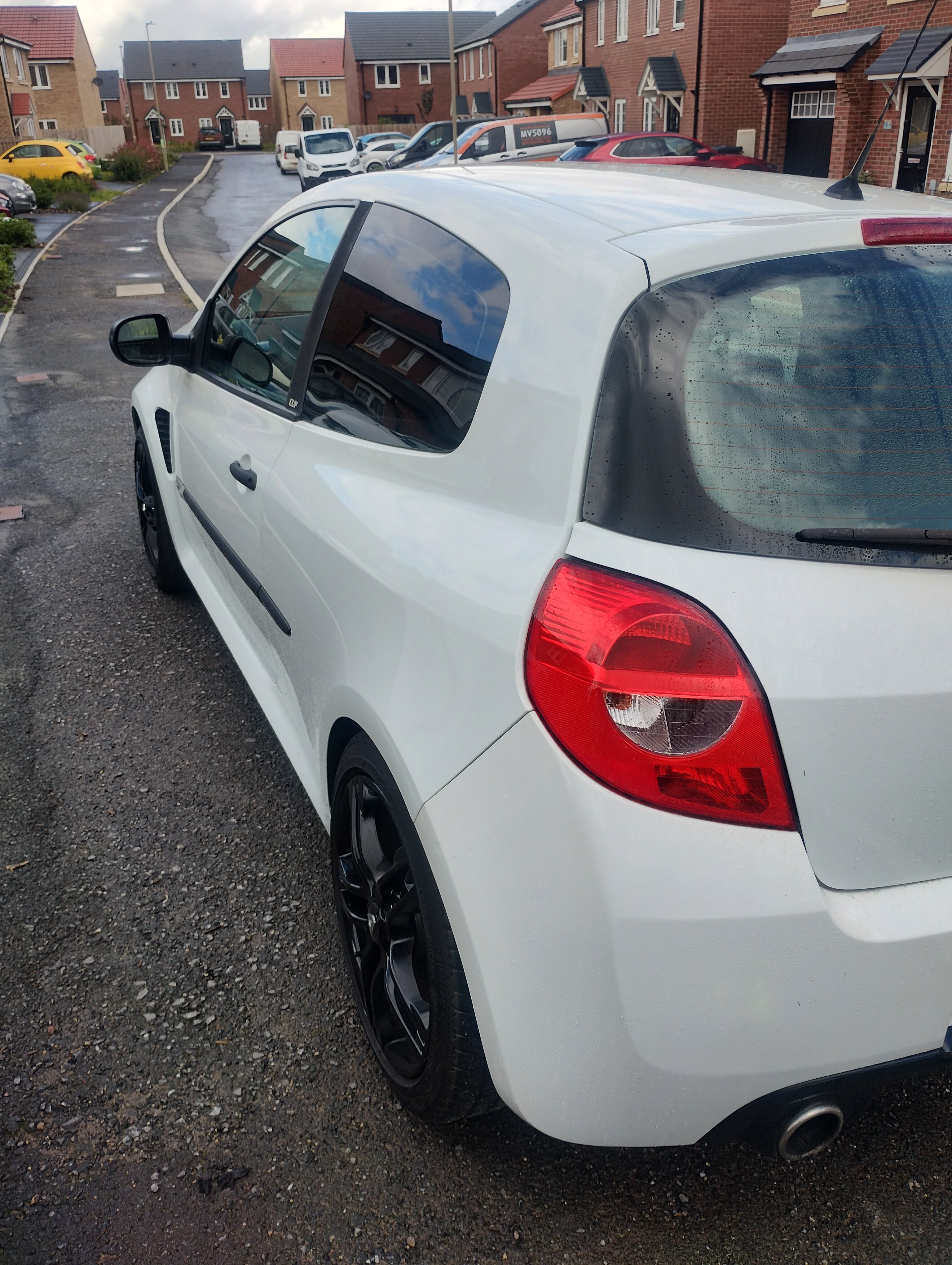

Hi, new to the forum, just need a bit of advice on a few things that are recommended for my Clio 2010 cup.
It's got a Miltek exhaust, Rs tuning map, standard OEM cup suspension, Zpo shifter. Currently on 97k miles, drives really well for the mileage. What front brake pads/discs are recommended for fast road use? I only really drive hard on the odd weekend over mixed A -B roads. Otherwise she's just steady away around the doors now and again, any advice will be appreciated.
