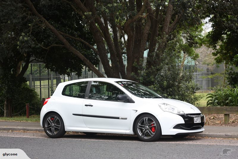

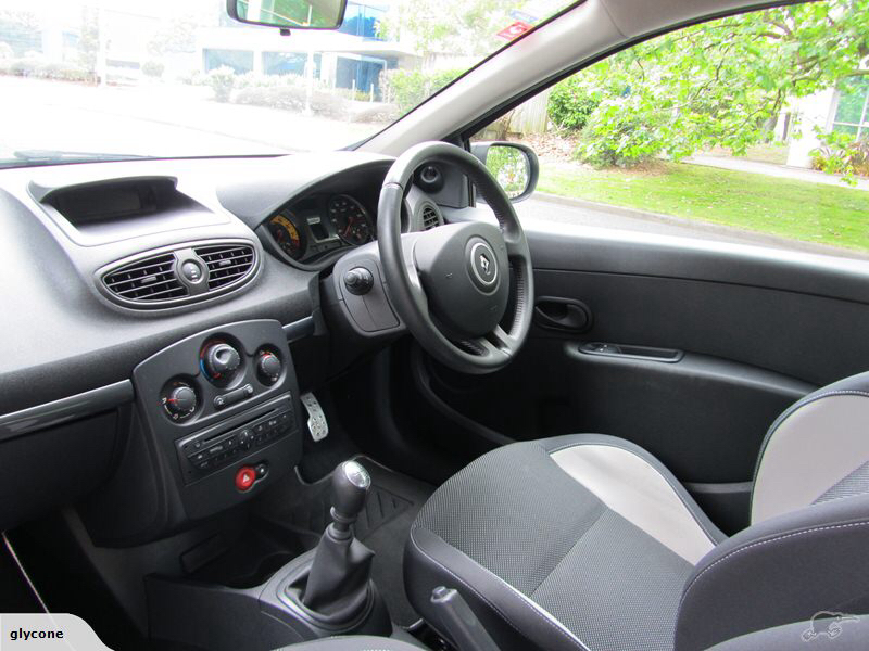

Can you please tell me the difference between these two Clio 200's?
Why does the white 200 have red calipers, black rub strips and door handles? Also it doesnt have climate aircon and a yellow stripe on the steering wheel. Is this Cup spec?

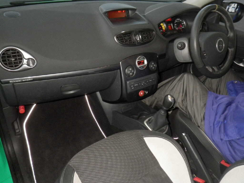

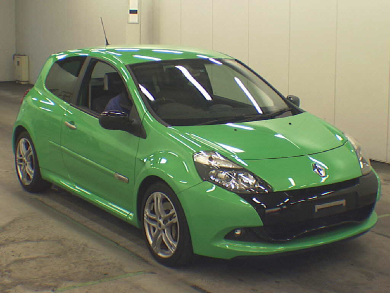

This Alien Green 200 has colour coded rub strips, sliver calipers (are they smaller brakes?), and the yellow stripe on the steering wheel.
BTW, both examples are meant to be 2009's.
First one is a Cup, second one isn't.
The Alien green one still has the same brakes, it's just they are painted red on the Cup pack specc'd cars. The cup has less creature comforts but has the cup chassis, so lower, stiffer suspension, quicker steering rack, thicker ARB and that's about it.
Out of the 2 i'd have the alien green personally, but it depends what you want the car for.
white one is a "cup"
green one is not.
too add some confusion, "cup suspension" can be had on non-cup cars too.
Unless you're actually Shane Van Gisbergen, you'll struggle to tell the difference from the wheel, but you'll notice the cheaper interior every time you open the door.

The green one also has cornering lights. Far better than the standard lights which are pretty poor.
