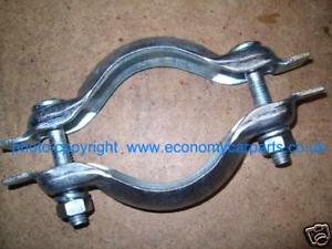

Could someone please point me in the right direction. I cant figure out how to fit the center section to the standard cat. What fitting kit do i need please. So confused.,.......

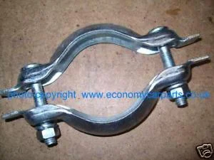

If its unmodified, the two olive joins should come together and you fit an exhaust clamp over the top:
However due to them likely to blow etc most people opt to cut the join off and sleeve it (search about)
