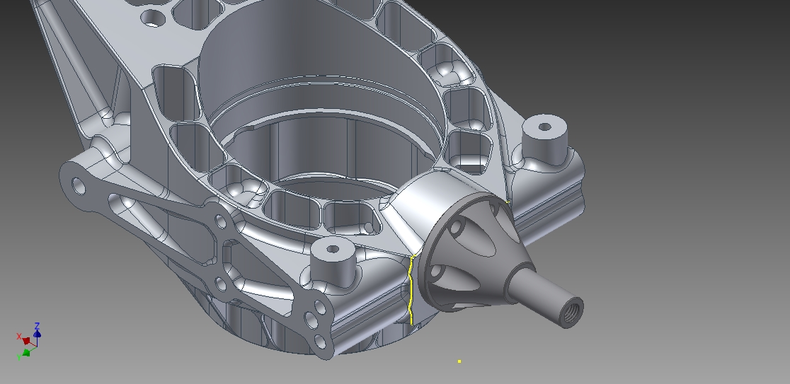

I don't have any drawings to hand, but I can sort something out for you! It will take me a little time to prepare, so bear with me.
I worked on a World Rallycross project up until a couple of years ago, many long days were spent measuring and fine tuning then drawing up and modelling.
Attached was a revised bottom pin that was brought in for roll centre correction. It was really interesting working among some talented designers and engineers including Reiger.
