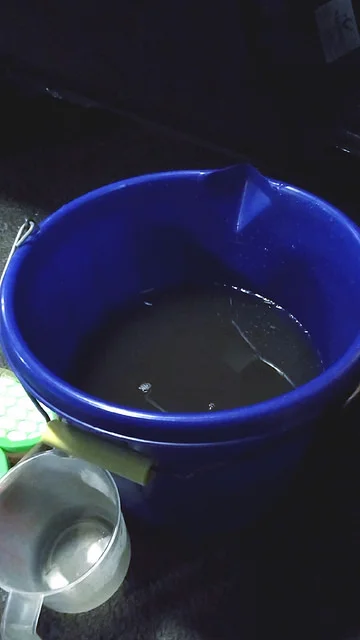

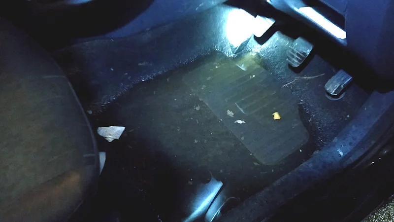

So my clio (DCi 80) filled up with an indoor swimming pool the other day, I managed to scoop out half a bucket from the drivers side front and back foot wells as with the under seat well.

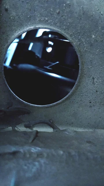

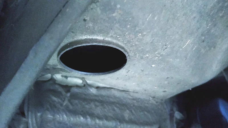

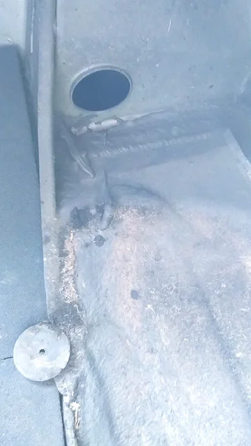

Today I took both wheels off to access the bottom of the scuttle drains fully expecting to see a pipe that is blocked, but all I got was an open hole, am I looking at the right place or should I be looking elsewhere? I only managed to look at the top of the drivers side scuttle without taking the wipers off (I have ordered a tool to do that later).
I removed a few handfuls of silt from behind the mudguard on each side.
I have seen a few guides on the net, all push at their being a drain pipe of some kind?

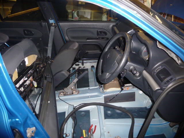

It was the centre drain that was blocked on mine, you'll need to remove the wiper arms and both parts of the scuttle panels to get in from above and it's still an arse to find the outlet in the engine bay side of the bulkhead, right down by the exhaust manifold. Be aware that the carpet and the foam underneath soak up a lot of water... i removed almost all of the interior and washed the carpet with a wet-vac and soaked the foam in a dettol solution in the bath before drying for 2 days in the shed with a heater and dehumidifier.
It was one single fekking leaf blocking the hole on mine :(

The dash does not need to be removed but the gear surround does.
Thought that, which is a piece of piss. Literally takes 30 seconds.
Seats out, rear seats out, gear surround, and the trim around the bottom of the door?

It was the drain in the middle that caused that problem ^ on mine. Open the bonnet, reach down behind the engine block. You'll feel a long tube that connects to nothing. That's your middle drain, I just gave mine a good wiggle and everything poured out.

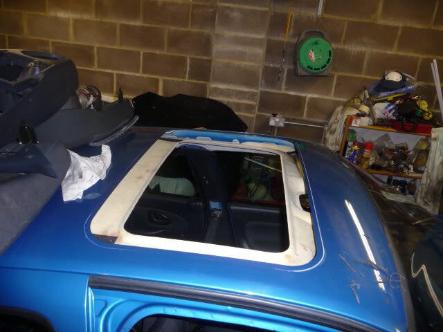

Does it come through the window? I would otherwise check the three skuttle drains? Do you have a sunroof? If so, has the seal been repaired?
