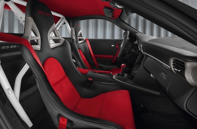

Fixed back bucked is possible with standard belts but not really advised (unless you go for a seriously shallow seat).
You would need the porsche style set up for the belt to still remain fully functional.
A la:
Other option is of course harnesses into rear seatbelt points, again, not completely ideal.
