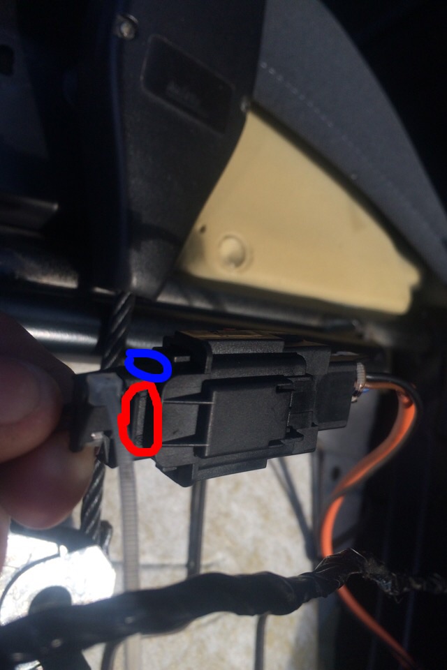

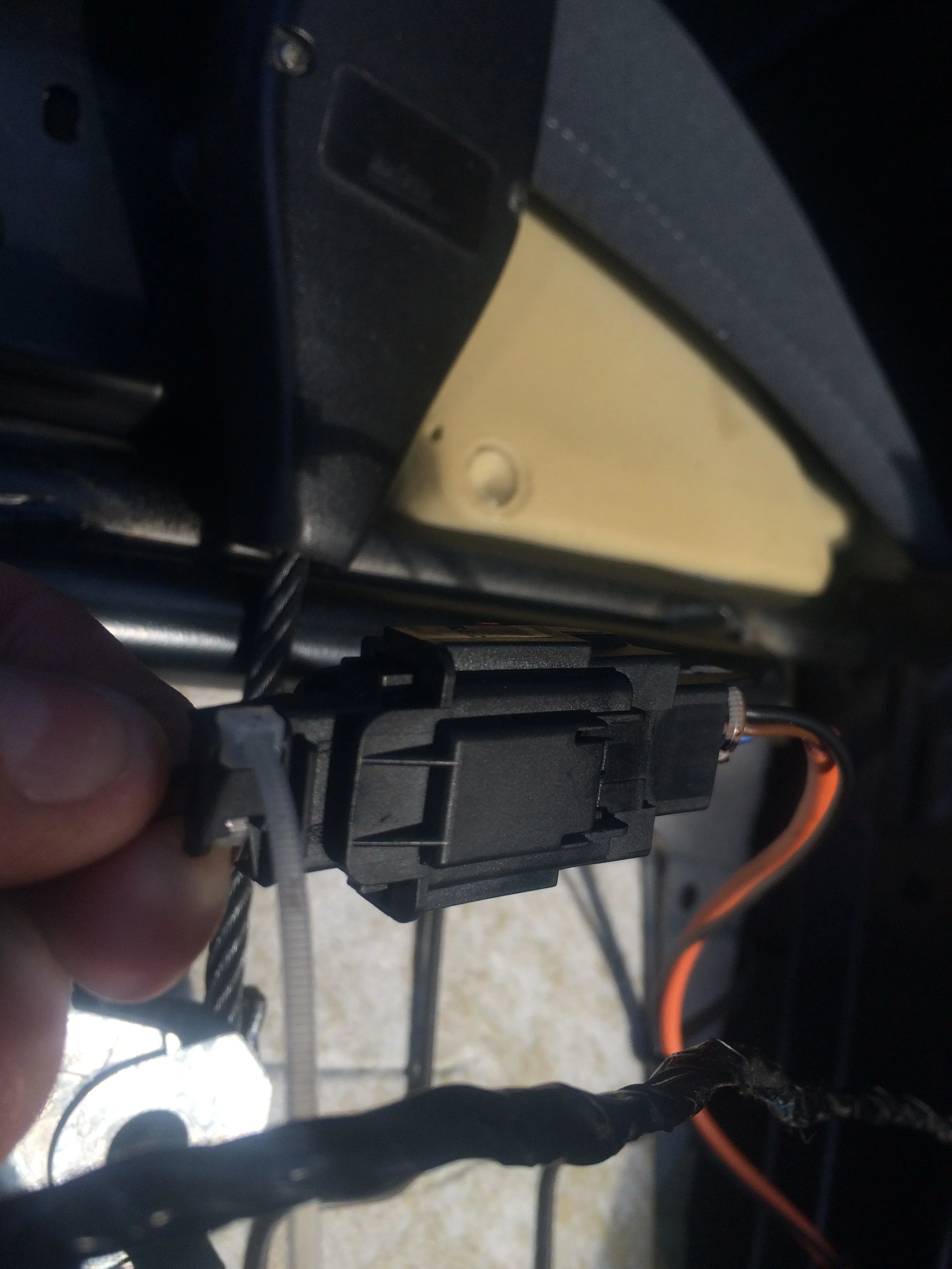

Can anyone help me with unplugging the air bag plug? My mates fitting sport interior seats, is this just a straight swap with the plugs?
In the bottom pic, slide a small flat blade into the bit just to the right of that cable tie.
Red mate.

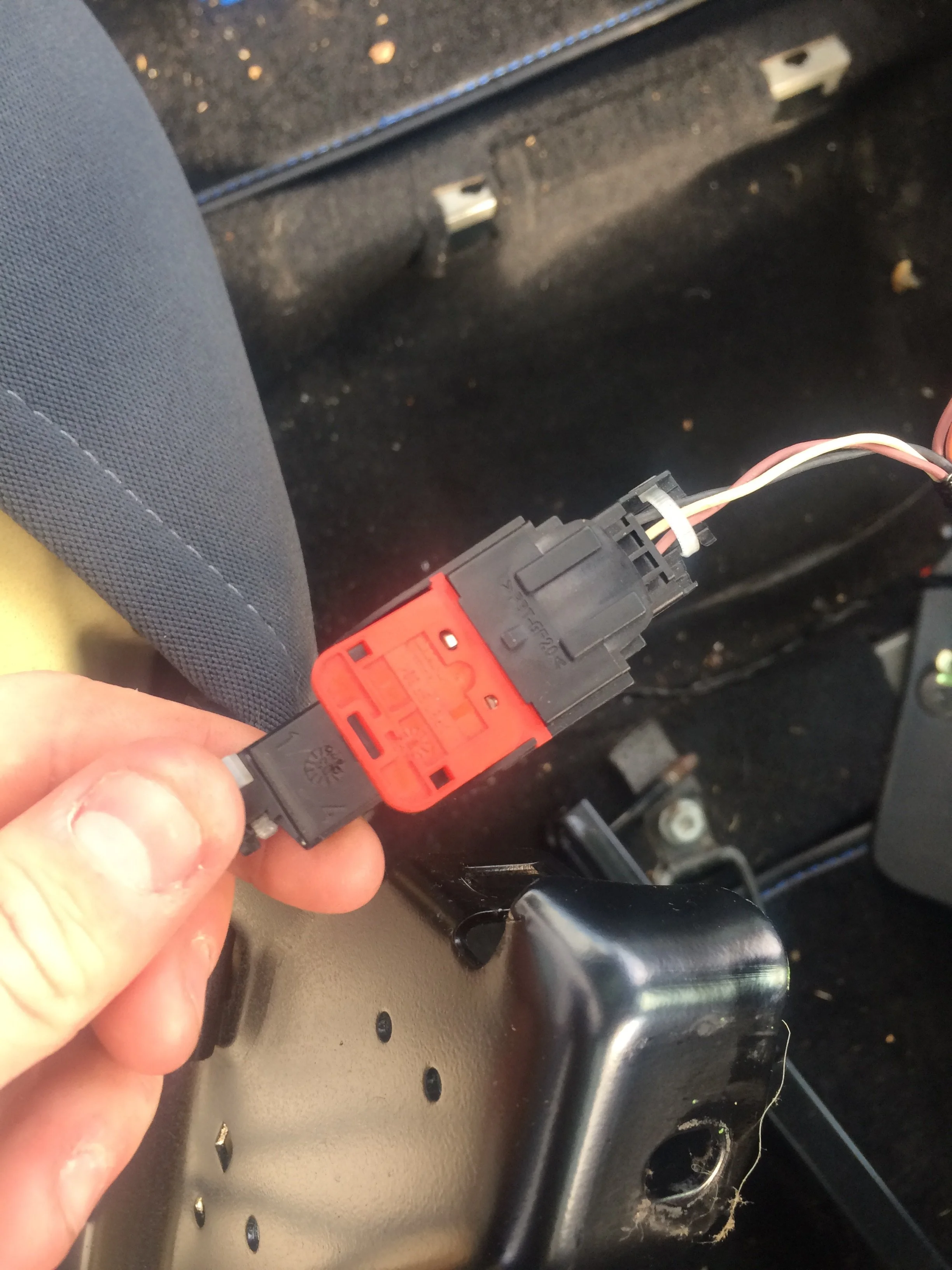

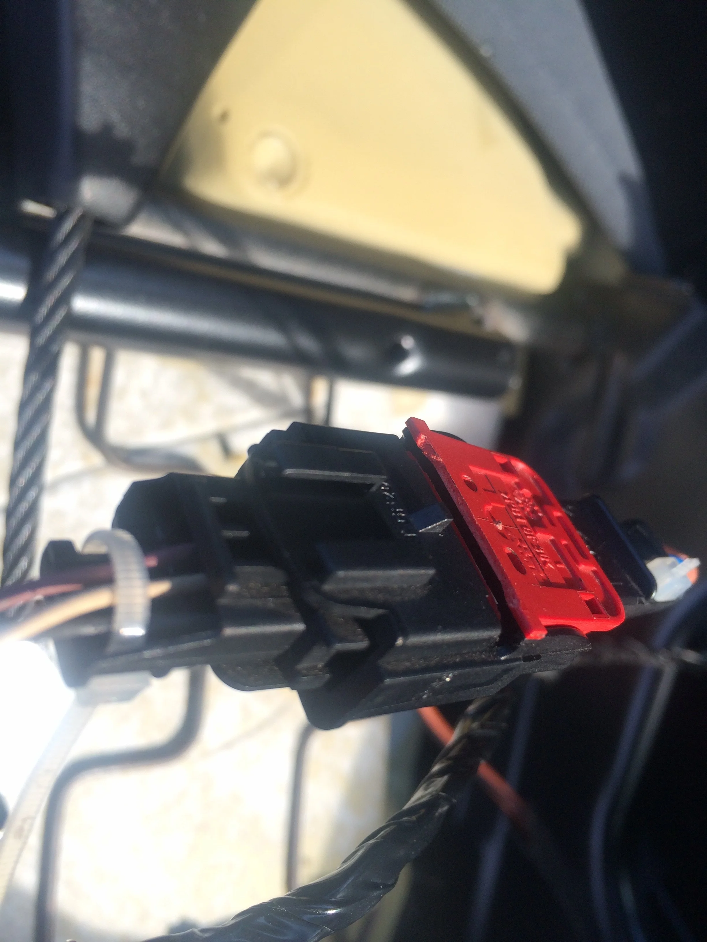

They are proper tight though so need pulling hard at the same time. You almost need 3 hands.
Just make sure you're tugging on the plastic and not the wires or you'll pull them out.
