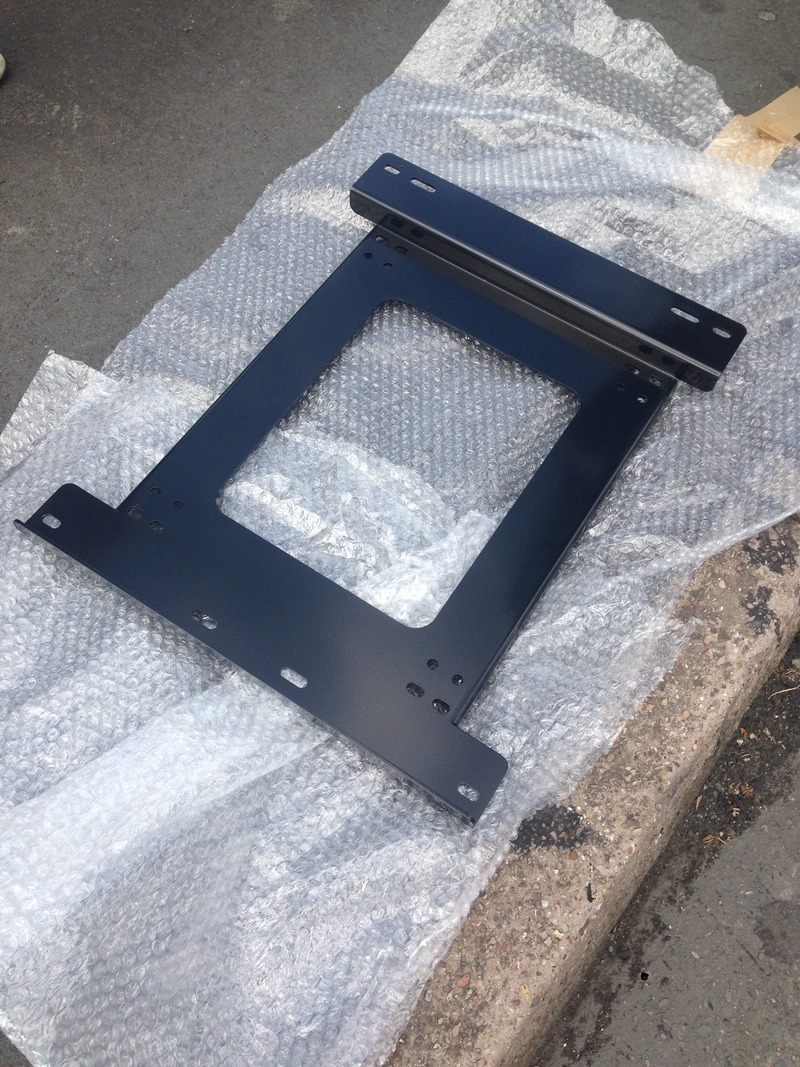

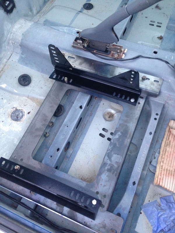

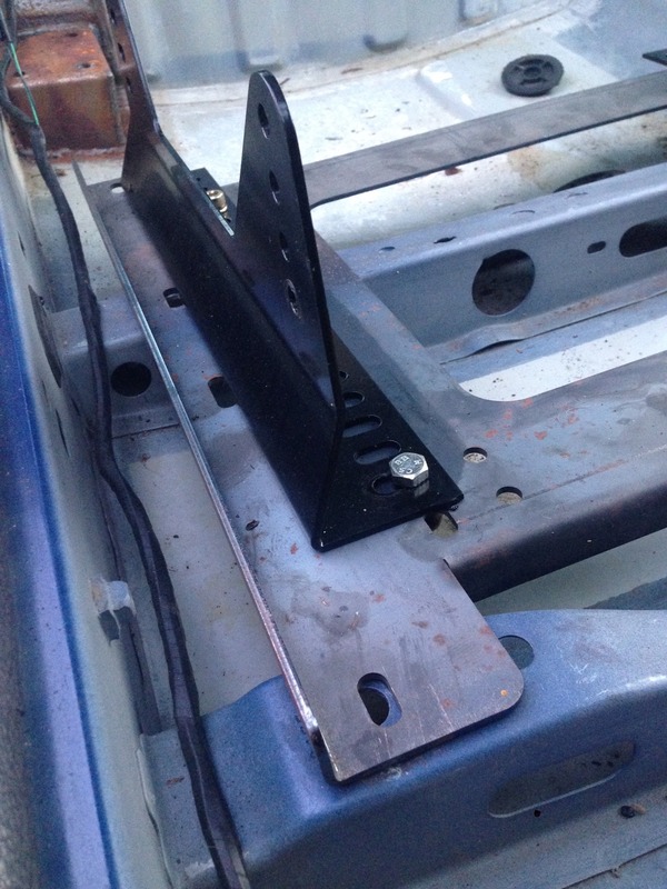

Here is a pic showing my subframe with a set of sidemounts attached.
At the widest setting these are 420mm wide.
I would say that would be fine as they can lean at out slightly to accommodate.
The other option is a 90 degree sidemount,these give extra width and are used on wider fitment seats.
I would recommend choosing a sidemount which is slotted on the bottom like the ones I've shown here.
They are a lot easier to set up and mesns you won't have to use spacers on your seat.
With 90 degree sidemounts( depending on make) I would imagine you could maybe go up to a 450mm width seat.
Hope this helps.
Jon
