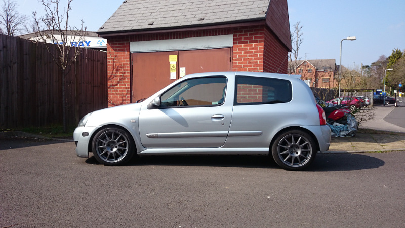

I had Cooksports, and with a stripped rear end, it sat as though there was no drop.
Took Bilsteins with no platform for it to look balanced.
