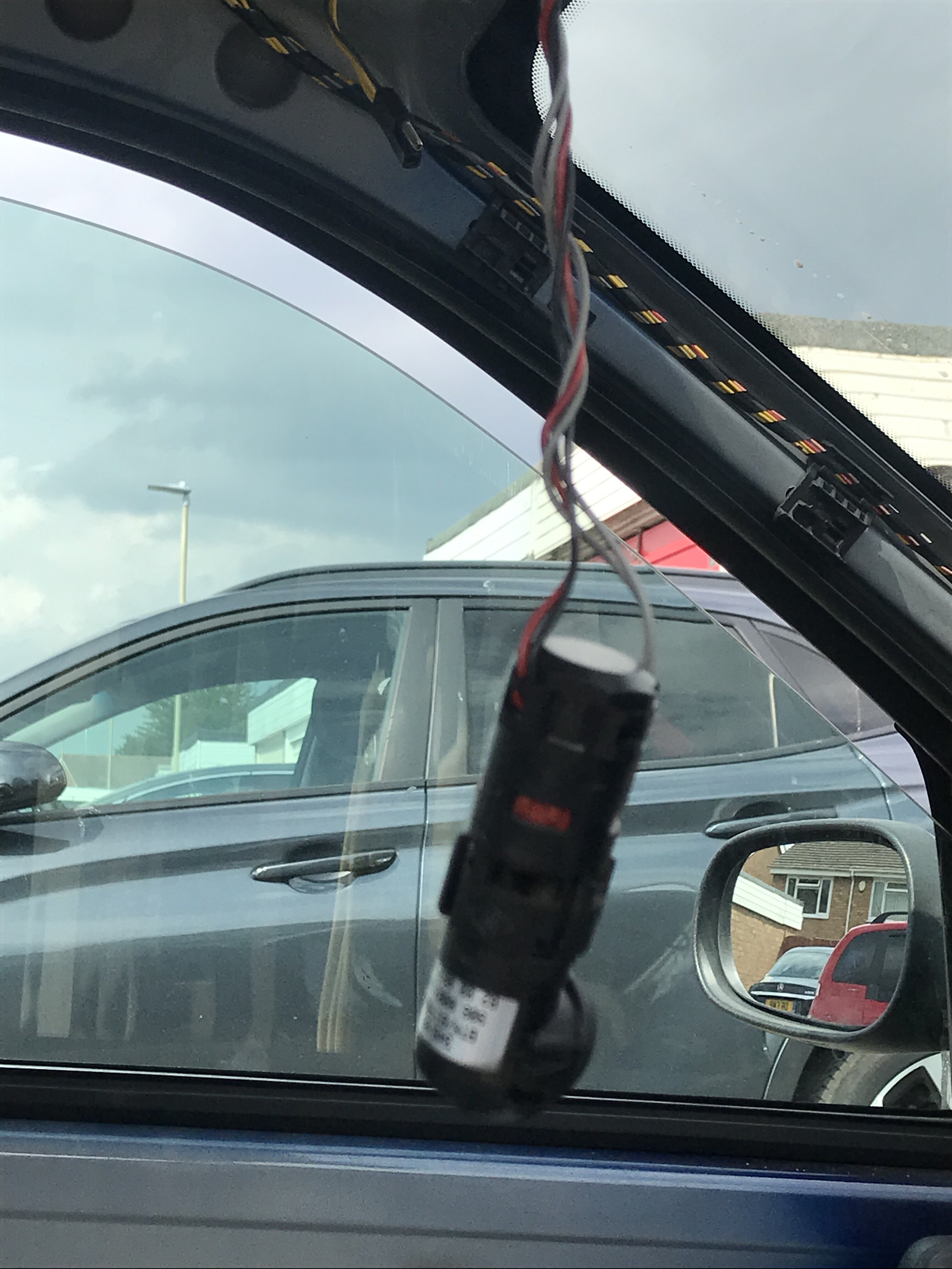

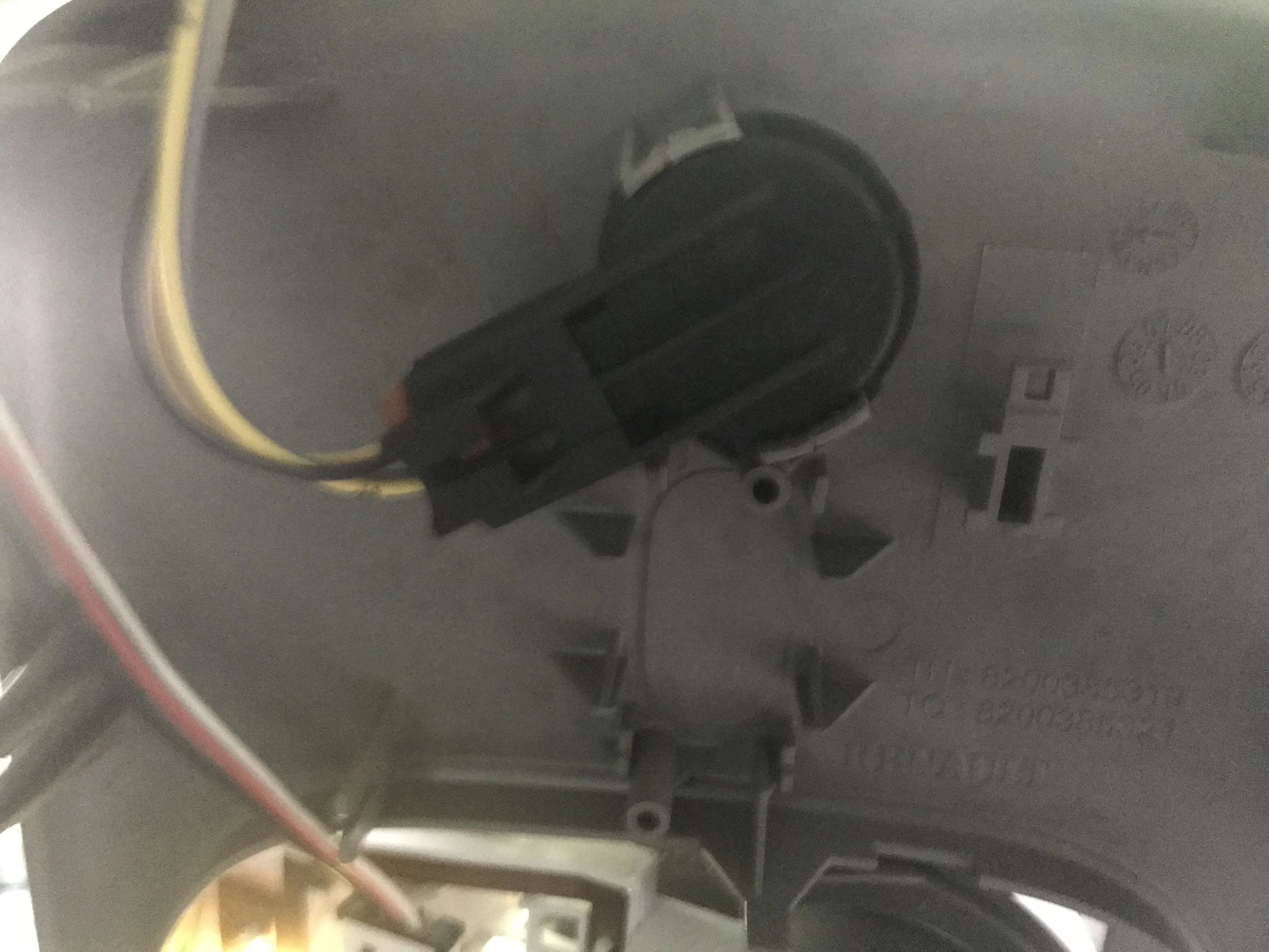

Although my climate control and aircon are working, it’s a bit slow to respond.
I took the roof console off and the sensor doesn’t look like the one in the parts listing.
Is this an alternative part that someone has fitted (as people seem to complain about a whining noise from the motor)
Here’s the one it says should be fitted?
https://rover.ebay.com/rover/0/0/0?mpre=https://www.ebay.co.uk/ulk/itm/262491908788
Can anybody give me any information about this.
Is my car fitted with a later part and could l fit the one with the motor which would almost certainly work better?

Anyone else got a pic of the inside of their console !?

if it's a blue dot on the outside it's the late climate sensor which doesn't have an integrated fan and is quieter. You can swap it out for one. If you get it plugged into CLIP you'll be able to see if one of the sensors isn't working because the temp listed on the parameters page will be -64. Realistically I would expect it to be the a/c gas.
