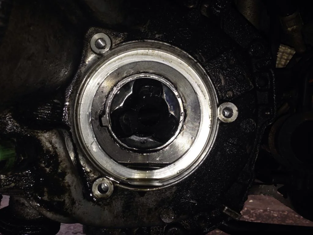

Thanks Chip, just been out and stripped it down so know what the propblem is now. Il update later with pic's as it may help others in future searches.
  Van

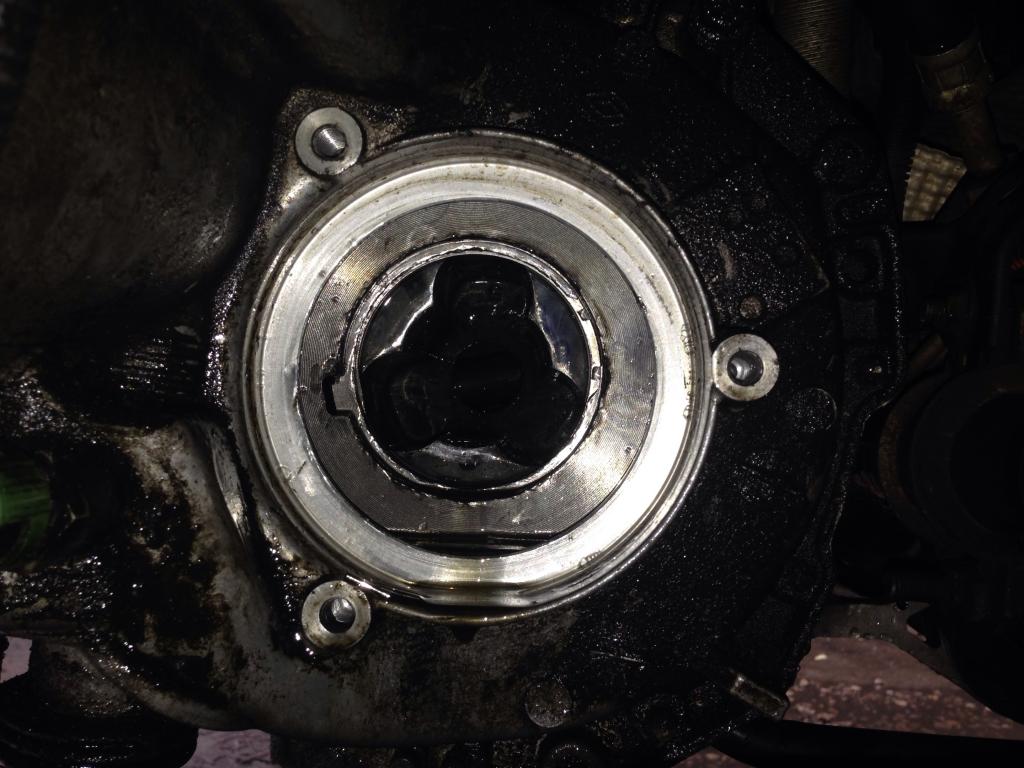

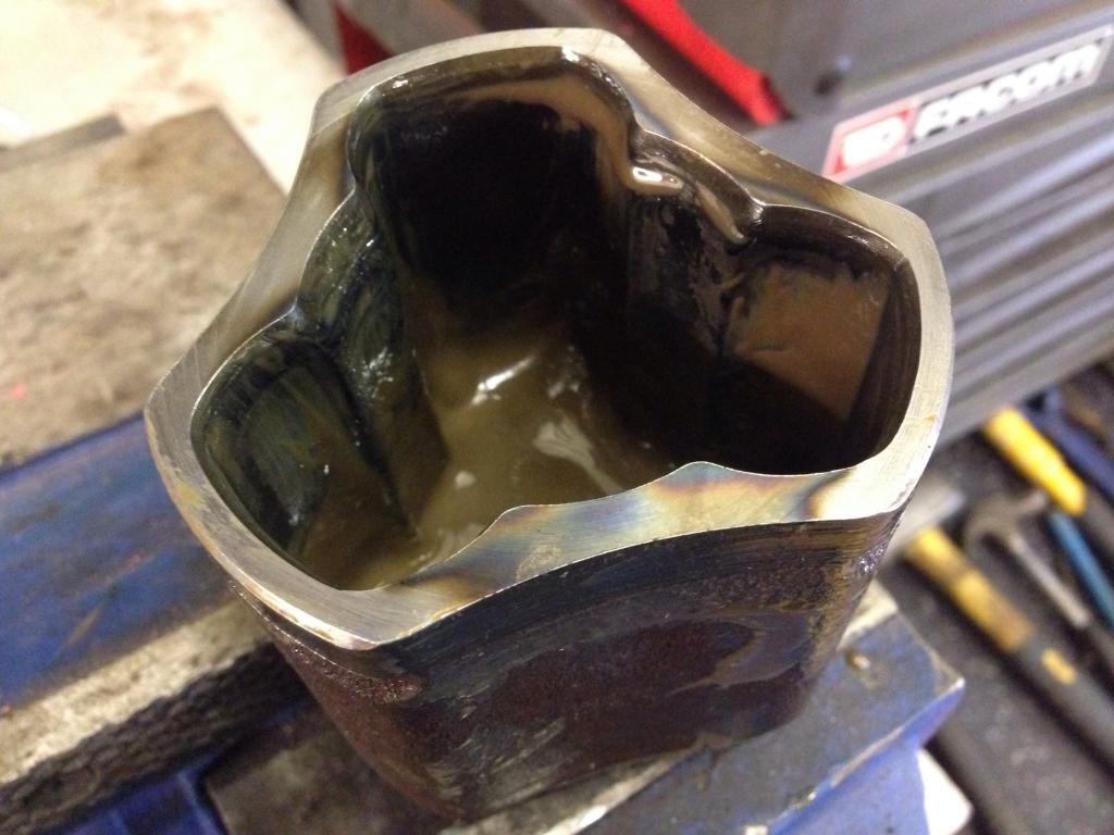

Started on the N/S, to see if the circlip was the culprit, and found the issue right away. As I think was mentioned above the worn mounts have allowed the N/S inner CV to pop out of the diff and back in again. Despite being intact there's quite a bit of damage to the circlip and gearbox housing, but that should hopefully clean up and a new circlip can still go in.

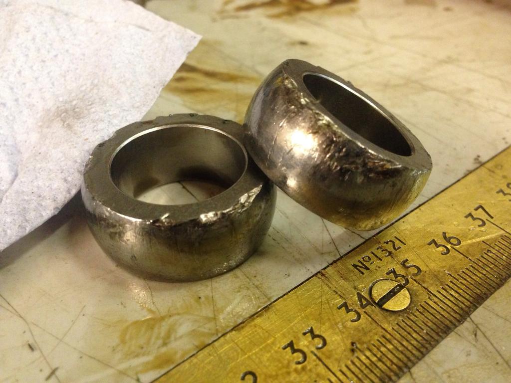

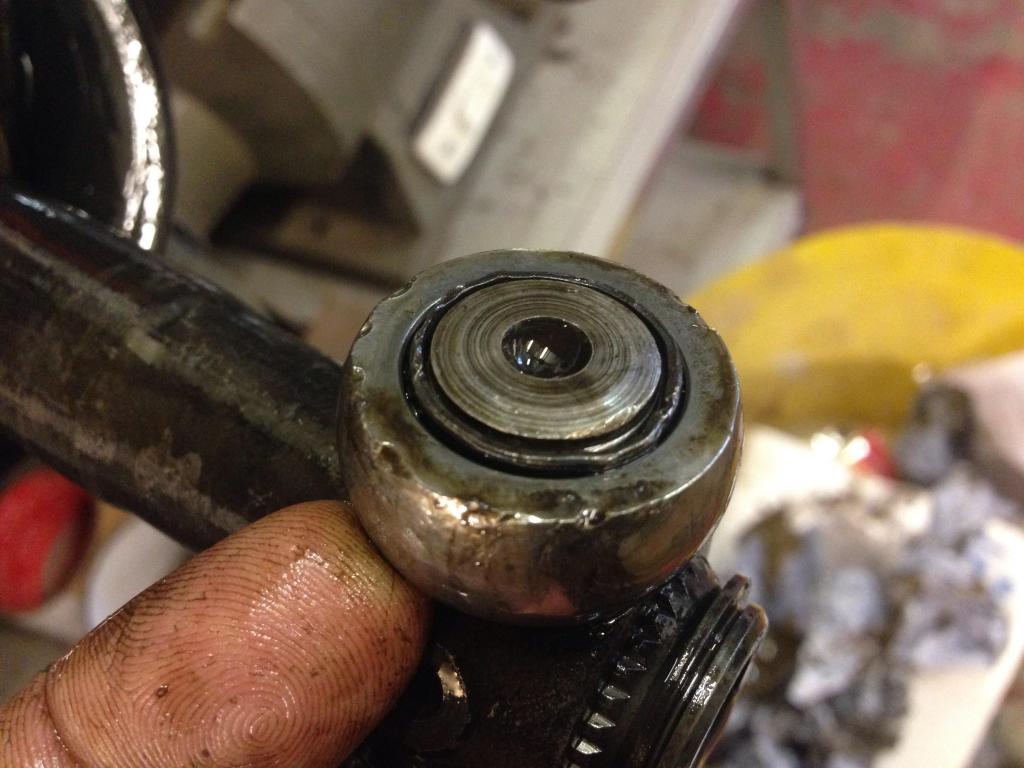

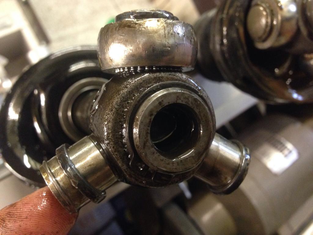

The knuckle joint has had it, and although it was still intact it fell apart once removed. Luckily all needles were retrieved.

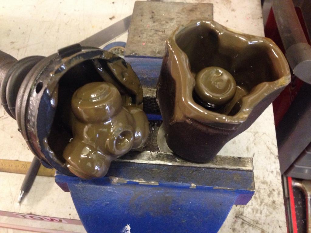

So, hopefully a new shaft and a bit of emery paper will sort that side out, but out of curiosity I removed the O/S too, just to confirm its condition.
The grease was a little watery and it does look to have got very hot, but with no signs of damage I shall just re-pack this one.

I've got one of the circlip replacement plates if your interested? It's a significantly stronger way of holding the drive cup in place rather than the circlip that's for sure.
Thanks, Il look into that if this Circlip does fail, but for now I'm happy to clean it up and re-fit.

Just catching up on this.... We had a similar problem when we modified our race car, driveshafts popping out! If you've chewed the cv cup....You need to open that gearbox up and get it cleaned, there is guaranteed swarf in there even if you have found all the needles.
