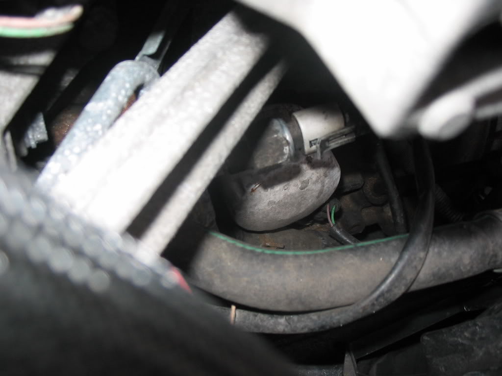

Problem solved guys! Thew! Mate of mine came to me rescue :)
It was the connection from the alternator to something just under the fuel rail guard (i have no idea what is it), whilst wiggling all the wires and checking all elecy connections, fiddled with this and the rev's instantly dropped. Switched off the engine and give it a good clean, cos it was really covered in crap, fired here up and all is good. Thank god.
I was really cacking my self i tell ya.
Here it is....not a very clear photo, but its just under the fuel rail guard on the left hand side, shown in white above the oil filter.
