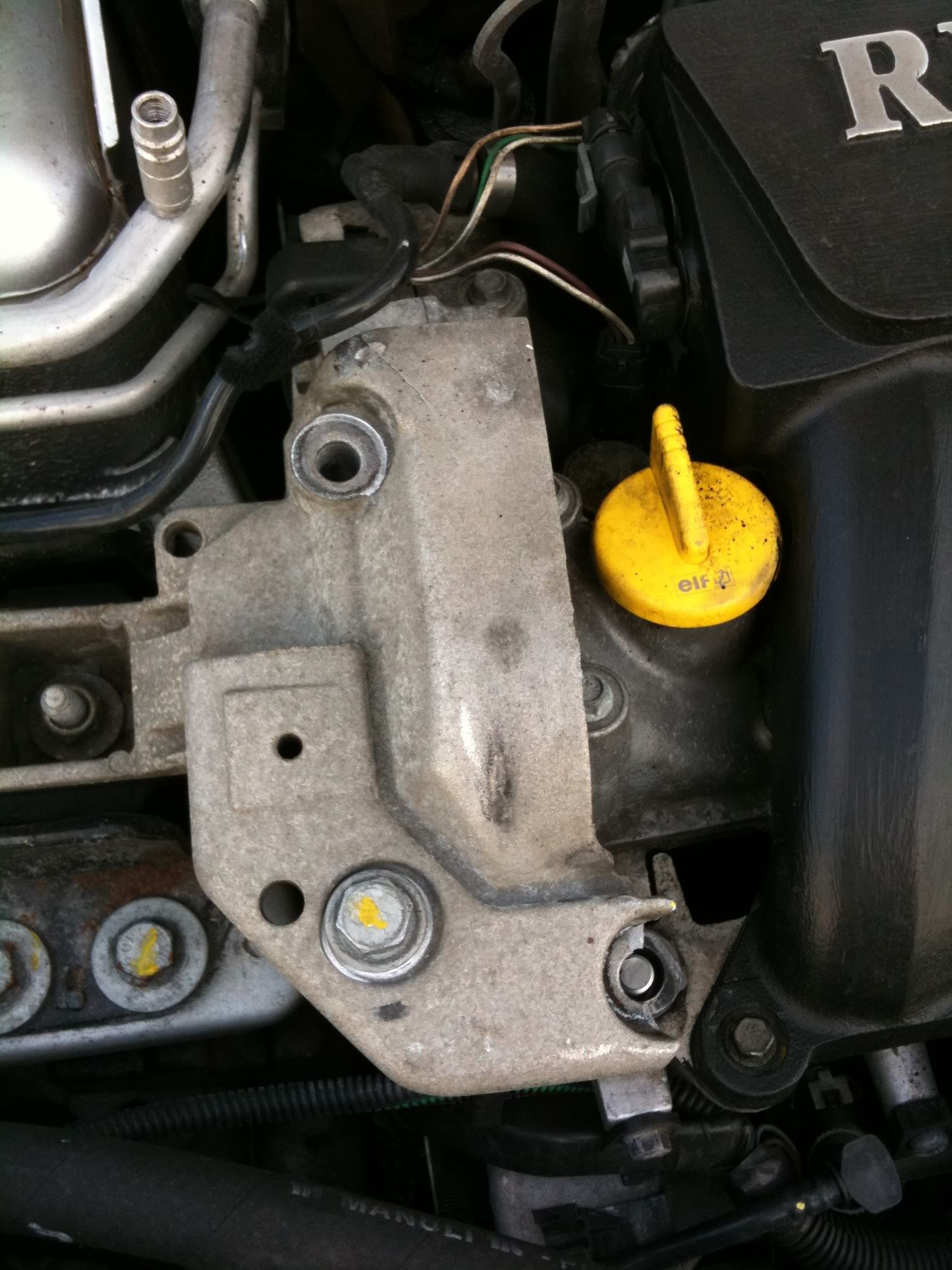

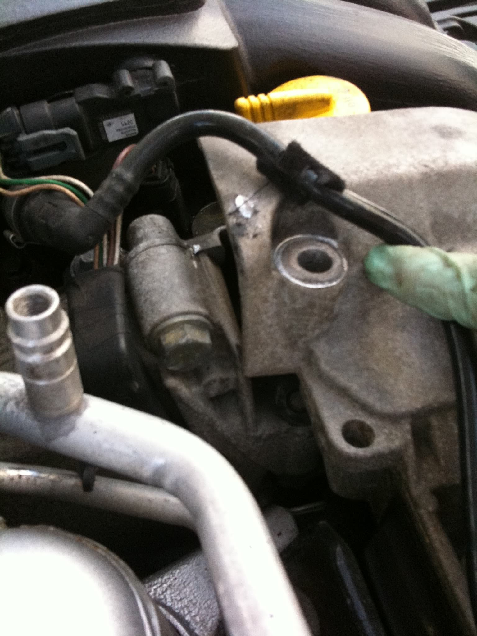

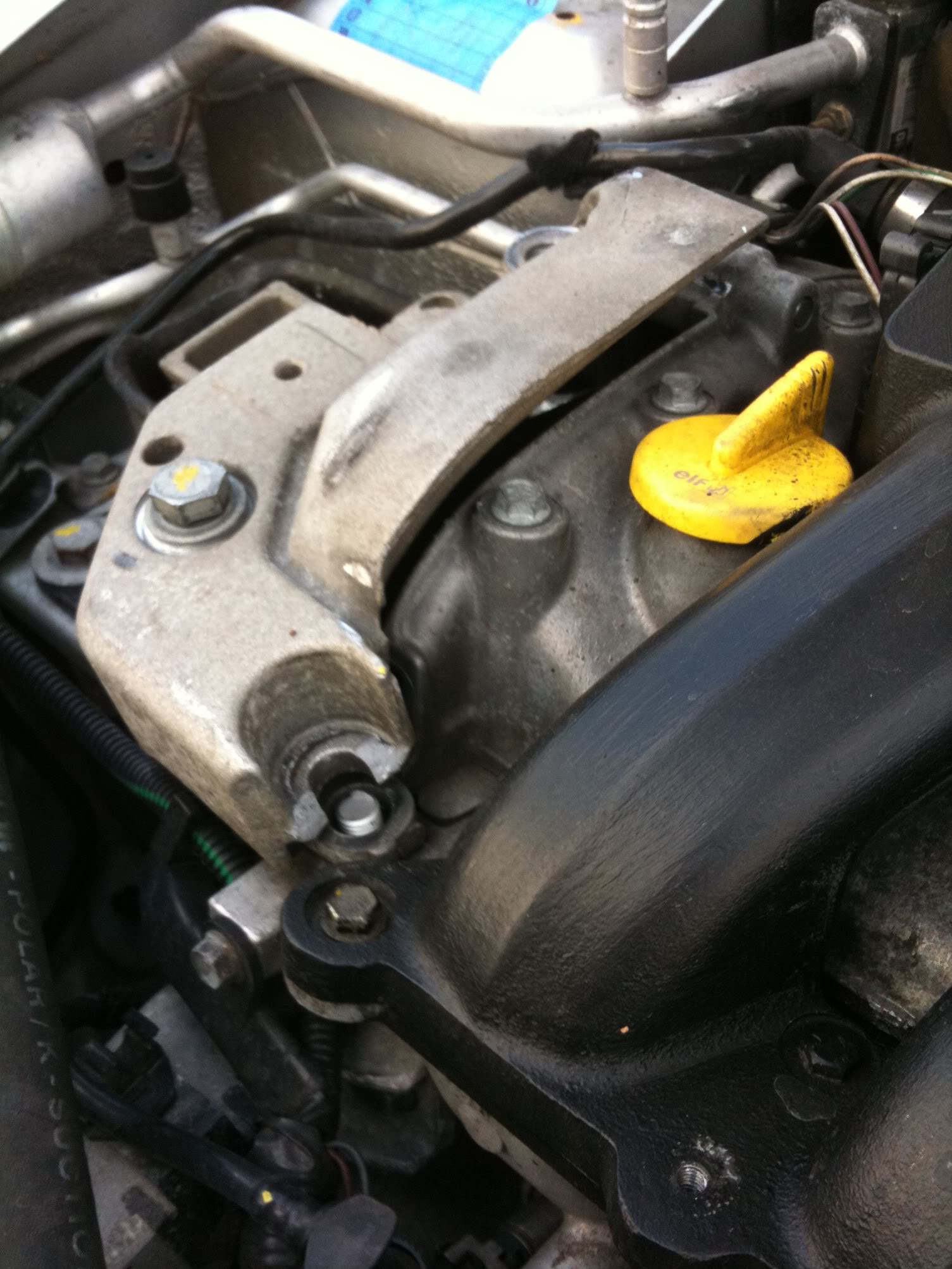

Ok, so driving along last night, went over a small bump, and bang, whole car shakes on idle like a nutter, stops a bit when pulling away.
Couldn't see what was up in the dark, but upon closer inspection I've snapped something big, the bit that connects to the engine mount.
Two bolts have snapped right off in the engine, no idea what to do about this. Only one bolt left:
Pics:
First snapped bolt:
Second snapped bolt (can't really see it, but you can see where its missing from)
Both:
Ok, so seriously, WTF am I gonna do about getting these out???

Weld a nut to the top and undo them.
I take it the engine mount was fubar'd and when you hit a bump it shook the engine?
(You're having fcuk all luck with that car!!)
That's the cambelt cover as far as I'm aware? Wouldn't be driving that incase any bits have got down there and tangled up in the pulleys etc!

Daniel, my son, as far as I could tell the other day, the mount was ok? Had a shake of the engine etc and all seemed solid.
I also just tried to replace the top GB mount and the thread on the big centre bolt was spinning with the bolt? WTF!?
I'll have to get someone to weld a couple of bolts on top then, nice idea, hopefully it won't cost me and arm and a leg.
As for having no luck, you're f**king telling me!
EDIT: Cambelt cover, SRS? I've already drive it about 4 miles, all be it very gently....
Need to drive to mechanics ideally... :S
So what have I snapped?? i.e what are Renault going to bum rape me for now?

as above, weld a nut if you can , if not you may have to drill and tap it out,
3rd bolt looks loose to me , if they were not done up properly last time was out this could cause that , seen it before , or a mount as daniel said.
s**t luck that.
The spindle being loose on the GB mount is common apparently, need to go in through the passenger side wheel arch and tighten it up from underneath.

What id do is give them both a good few hits with a hammer and punch, just to shock them (Helps Loosen Things..) Then get a Drill, drill in the centre of the bolt, a good bit down, then scew a stud extractor into it and just take them out that way.
Or as above weld a nut on if u can.
  RB 182 cup
surely the bolts will come out with just some mole grips as there is no no tension on them as the head of the bolt is not there??

I may be wrong but do you now only have one bolt holding that side of the engine up?

Looks like the cambelt cover, a local garage might help with the snapped bolts, then it's just replacing it and reattaching onto the top engine mount.
Cro
  Meg'd r27
As long as the other mounts are ok, it should be grand to just replace the cambelt cover. But i wouldnt be driving it much if theres only one bolt holding the engine up.
If that one goes there'd be a sh*t load of pressure on the driveshaft

Its only a cambelt cover, its not part of the engine mount don't panic!!
The cambelt cover IS the engine mount. It's not just a f*cking cover!
The offside of your engine is being held up by one bolt.
Extremely risky to drive.
Seriously??
Then i've got problems too! I'll get a pic of mine tomorrow, mine is DEFFINATELY in two bits.
Christopher
  Z4M
Three mounts.
Offside: "engine cover" mount.
Nearside: Gearbox spider mount
Nearside: Dogbone mount
Now that chap's driven his car with one 17mm bolt holding the weight of his entire engine. And it's the belt side too. If the mount goes, the AC compressor and Acc. belt doesn't have a fun time either.

I wouldn't even start it!
You have one bolt doing the job of three, AND it's doing it at a weird angle. Not ideal.
