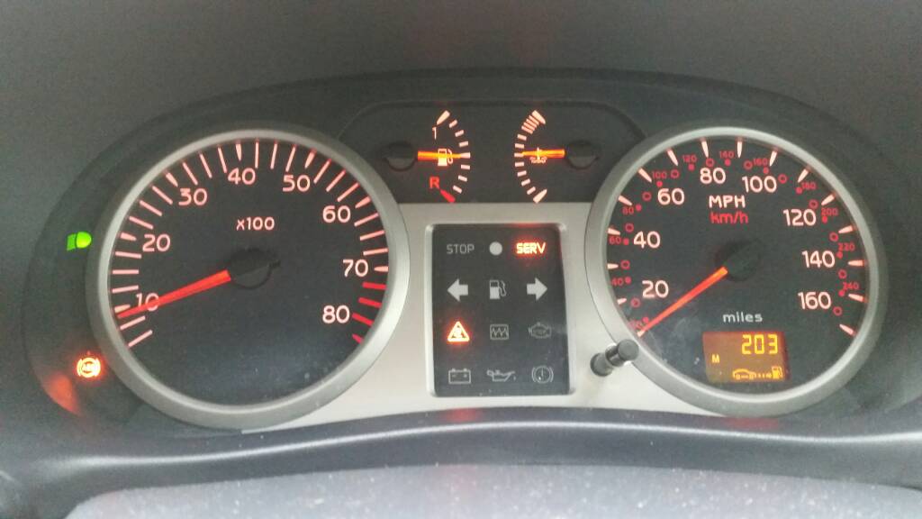

Serv, esp and abs light when braking
  BG182 FF
When I brake slow or hard, when the pedal reaches the bottom I am greeted with the abs lights and this lot? What could it be? :/
Sent from my SM-G900F using Tapatalk
MicKPM
ClioSport Trader
  Clio16v/Zoe Z.E.50
How does the pedal feel and more importantly, how far does the brake pedal travel when you press it (rest to "it won't go any F'n further")?
Mick
  renault clio 1.4 16v
check your brake fluid level, you will need to bleed the system if it has run low and sucked in some air..
