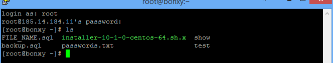

Im in need of some help from some of you brains on here.
I have an online VPS which decided to spit its dummy out and f**k up.
It was only running a wordpress blog which im not bothered about. What i am bothered about is some of the data i had in a database that the scanners where collecting.
Before it totally went tits up i managed to get it to dump an .sql backup in the root.
What i need to do is download this file.
My server has no httpd or apache working as i cant redo it without dropping the whole VPS and starting again.
Anyone know how i can get this backup.sql or FILE_NAME.sql off there ???
I appreciate all input. Im not totally clued up on this VPS stuff. Its just a hobby so im trying.
Thats the file there.

(Unix command line from your local machine) scp root@bonxy:/backup.sql /localdirectory
or
Use something like WinSCP or Filezilla to login and move your files back across
The first command worked. Thanks for your help mate.
