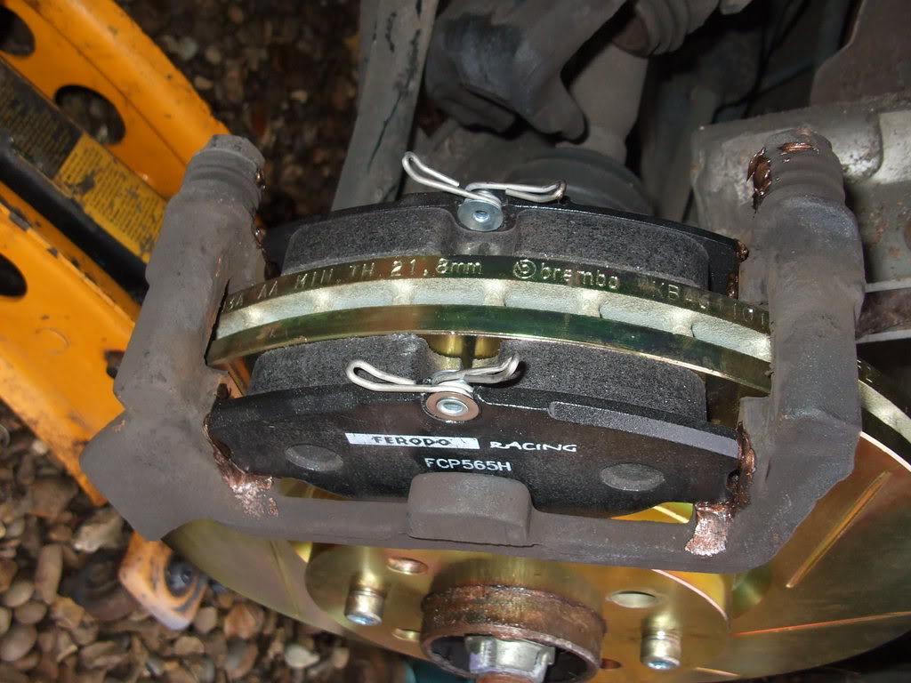

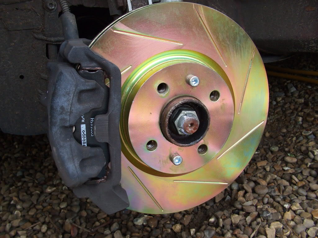

forgive me if i'm wrong but aren't the grooves supposed to go from inside to out in the main rotational direction? This is to aid heat dissipation into the wheel and thus tyre, providing maintainable temps and decent grip. Also clears any crud to the outside of disc instead of trapping on the inside near hub centre.

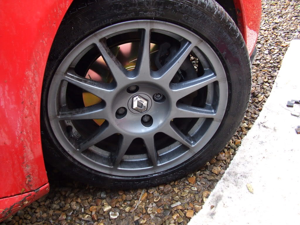

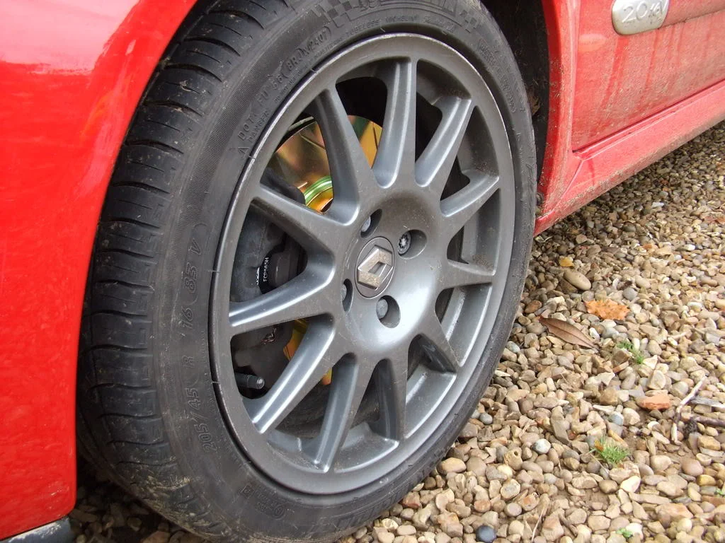

they look great but shouldn;t your wheel sit flush where those allen bolts are sticking out, they are normally countersunk!
If you have them facing the other way you get more bite but go through more pads at the same time.
ooooo i like, they're brembo......? where did you get them from and how much? if you dont mind me asking. Car looks amazing. :)

AstoN - That's how i had 4 pots on my old car:
But reading the brembo instructions(shock horror) it says to have them how i've fitted them on the clio! Can't argue with them i don't think lol

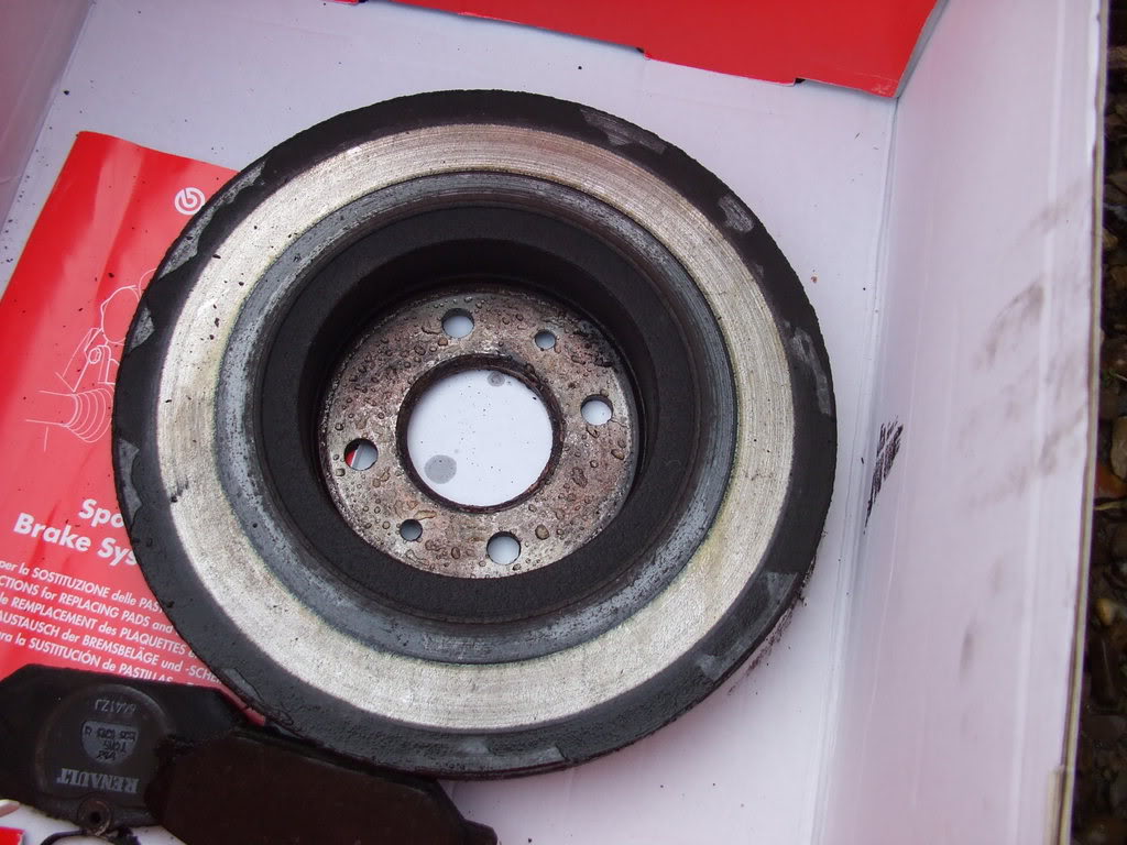

And i don't really thrash my trophy, i use it as a company car at the moment, averaging 42mpg over the past 300 miles! As you can see the old discs were shafted(think they were factory ones) and i happened to get a rather tasty deal on the brembo sport discs so i thought i may as well upgrade my downgrade for a regrade! :cool:
Dan - The trophy wheels don't sit flush, i checked it all fitted, there are gaps between the wheel bolts on wheel so the wheels fit over the bolts fine!
Yes they're brembo sport grooved discs, got them off a mate for £65 - meant to be around £140-150 delivered i think?!
driving properly and thrashing are two different things. but seems impractical from a performance point of view with the discs like that.
