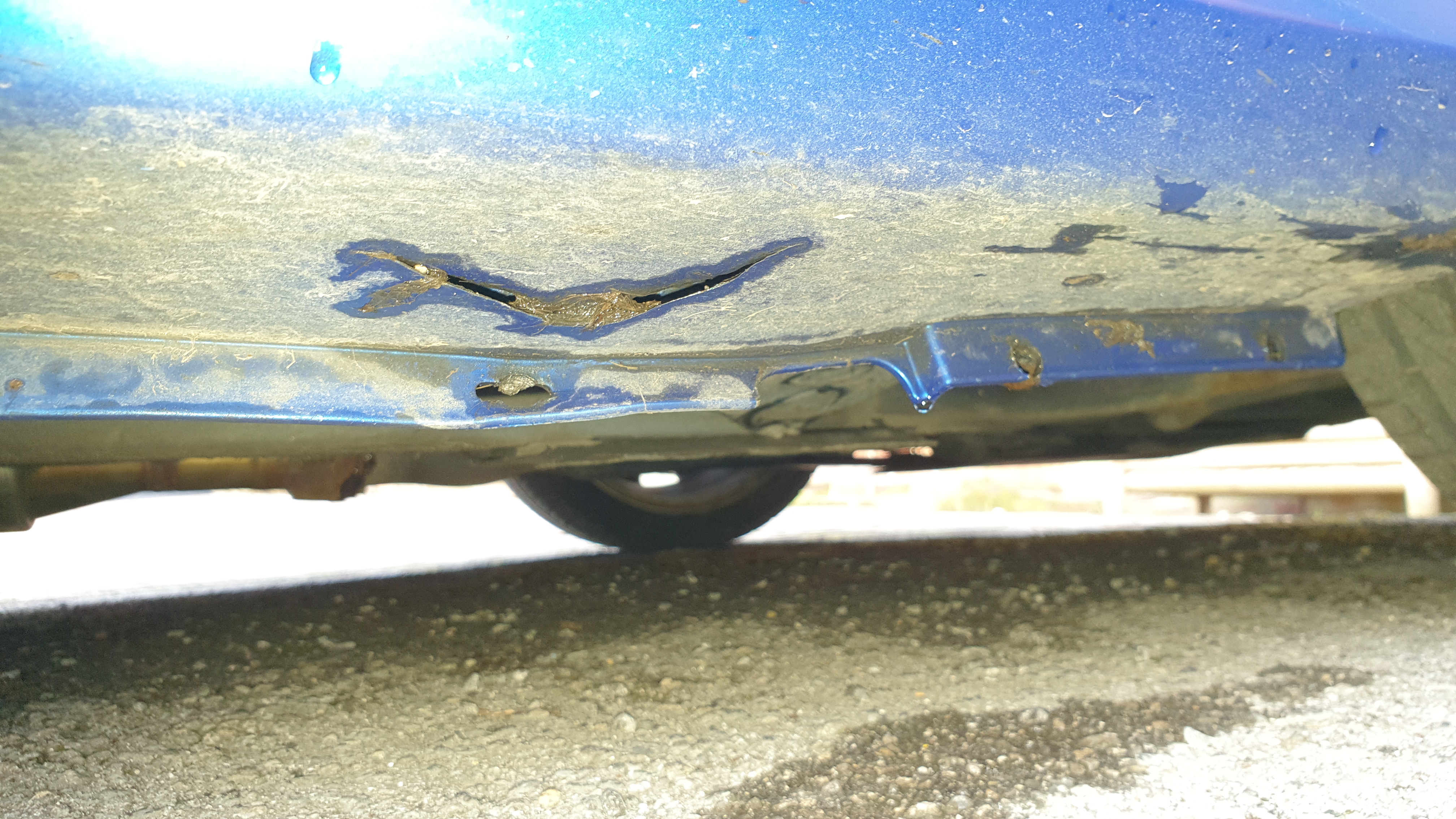

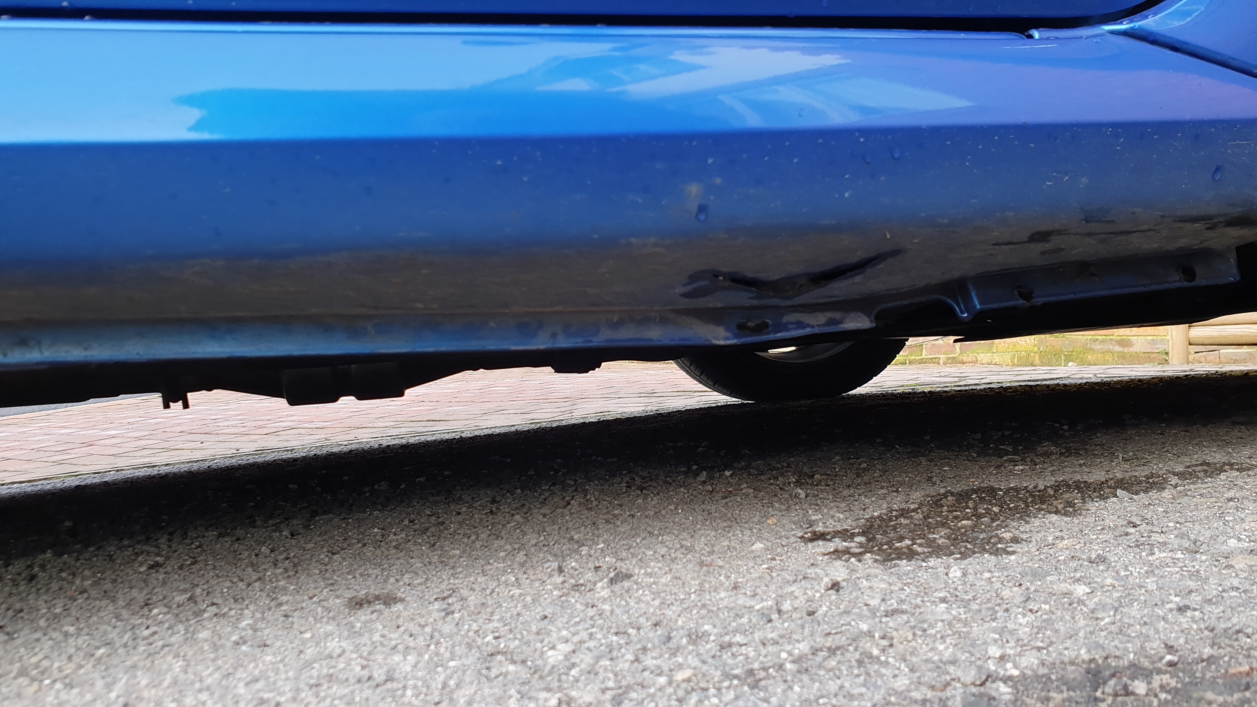

Hi guys and girls, new Clio 182 owner here. Recently picked up what appeared to be a pretty good RS182, however I just discovered a hole in the sill. Does this look like accident damage, or just someone being a numpty and jacking it up on the chassis rails with a trolley jack, which then slipped and went through the sill?
Many thanks in advance

Looks like the Jack has slipped .
Easily replaced .
I would pull off that skirt and look underneath it for any further damage.
Only damage appears to be to the plastic sill cover. Easily picked up second hand for about £20 and you just drill the heads off the rivets and refit either using rivets or rivnuts/bolts.

For the price to replace them I'd get some new ones! Use it as an opportunity to clean up your sills as it's just an ingress point at the moment
Oh I will, I just meant that I don't want to go searching for hidden rust just yet. I'm still in the honeymoon period and don't want to search too hard for things wrong with it 🤣
