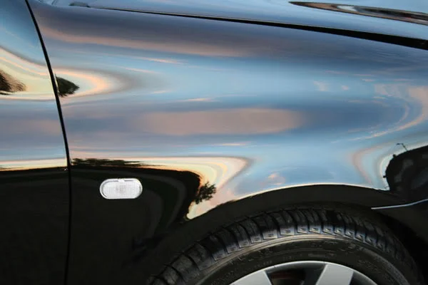

As Rich says a high oil glaze and carnuba wax will work a treat. This is acar I prepared, not for a show but its 'pretty show car' in its looks!!
