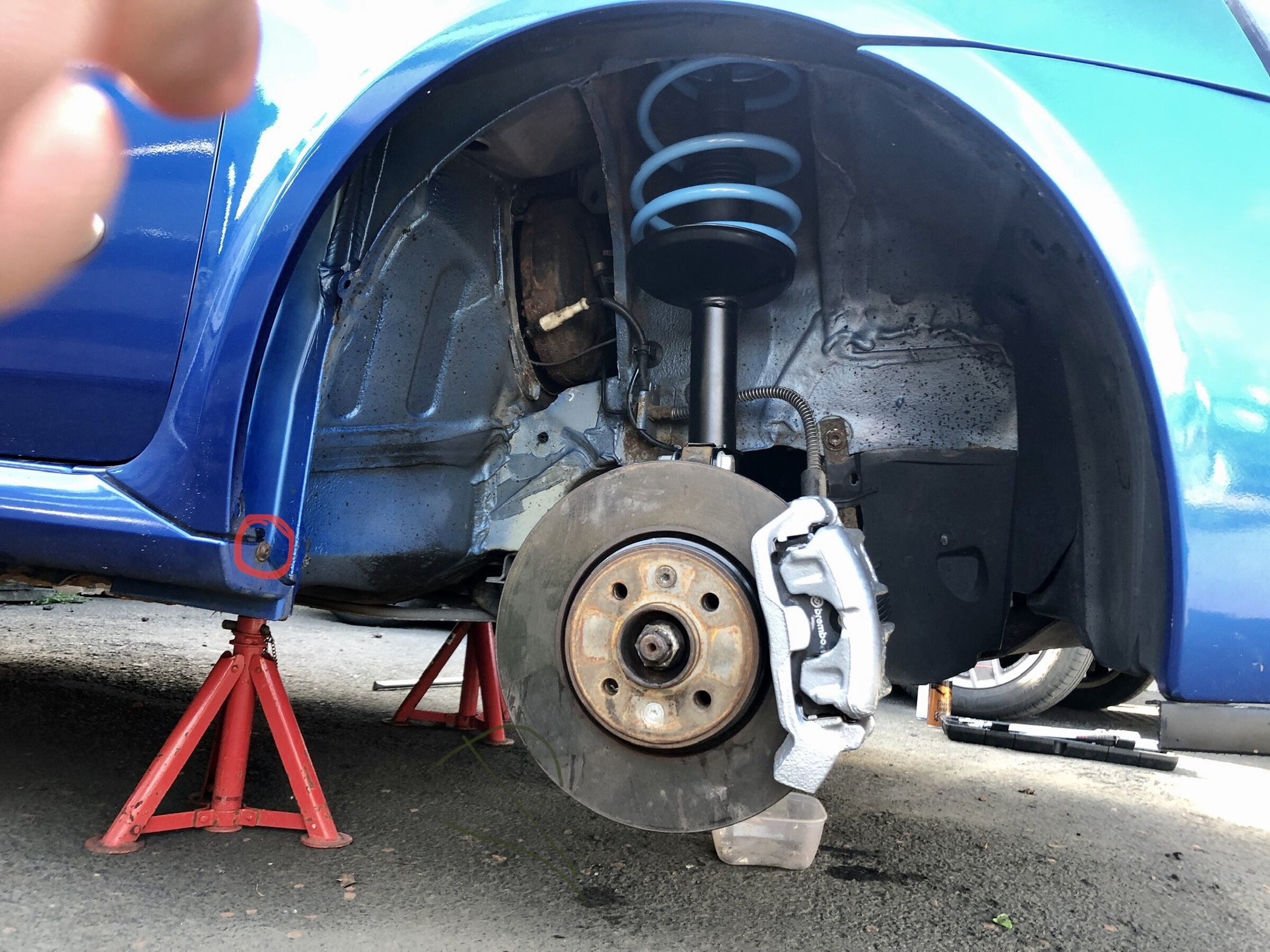

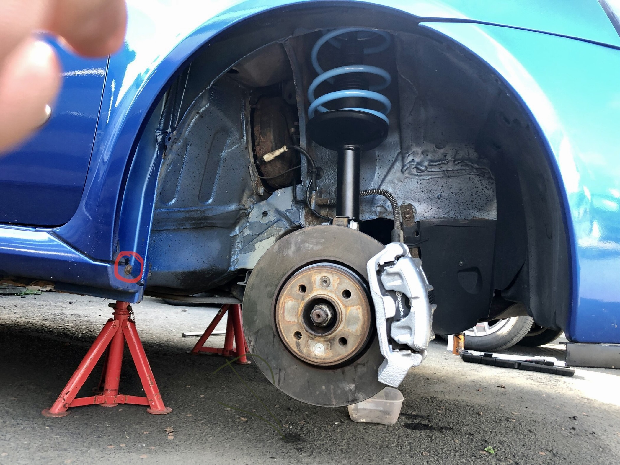

The side skirt are pretty easy to remove, you’ll need to drill out the rivets though.
At the front of the skirt, by the front wheel, you’ll see a hex head self tapper that goes into the skirt. Unscrew this. Mine was a right git to remove so I drilled it out.
I’ve tried to show it here, circled in red.
Once that’s out, get a drill and a decent sized drill bit. If you look at the bottom of the side skirts, you’ll see a few rivets holding them to the body of the car. I think there’s 5 or 6 off the top of my head. Drill these out and you should be able to pull the thing off (y)
