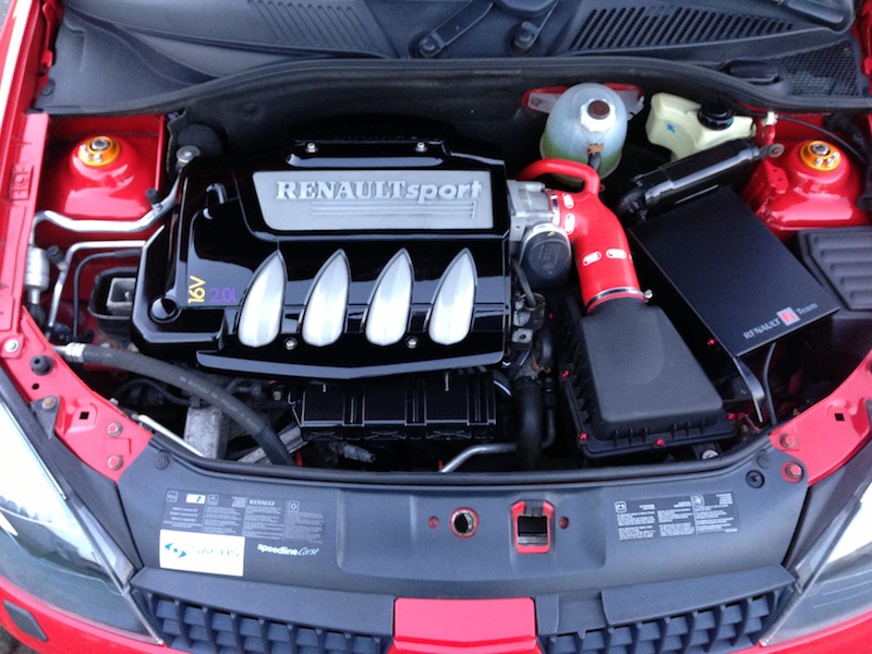

I have this very Forge Induction Hose on my 182:

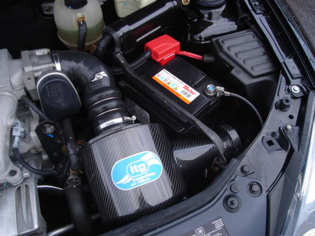

Will this fit an ITG Maxogen? I've had a look at it and I am not convinced it is long enough after browsing images of peoples Maxogen fitted.

I know that brand new it comes with its own elbow, what im asking is will it fit onto this forge Elbow. The Diameter looks the same I am just unsure on it's length. The photo was for reference, my Forge hose is Black.
I am asking because I have bought one secondhand that does not have the original elbow.

Oh my Bad sorry, I personally do not think it will if the forge one is a replica of the original renault part, mainly because I think the ITG Filter Sits a bit closer to the front of the car which would make it need a slightly longer hose, still no harm in trying the shape is the same but I definitely think the ITG uses a longer hose, I no longer have the Ren part so cannot tell.
measure your forge hose in terms of Width and length from TB end to bend and from Bend to filter and i'll check if my ITG is the same? if that makes any sort of sense?

Should fit diameter but as already mentioned length could be a issue.
Just custom make one. There's a decent company on ebay who sells all the Ash silicone products.
From the bend to the end of the hose it is approximately 11.5 cm. The End of the hose finishes inline with the Engine lifting hangar.

Too Short dude, also it has two bends in it, the cone itself faces into the wing, what parts are you being supplied with? just the cone or are you getting some pipes? it's bit of a pain to fit complete.
No it does not, this is an ITG Maxogen:
I've no idea what kit you are talking about!
