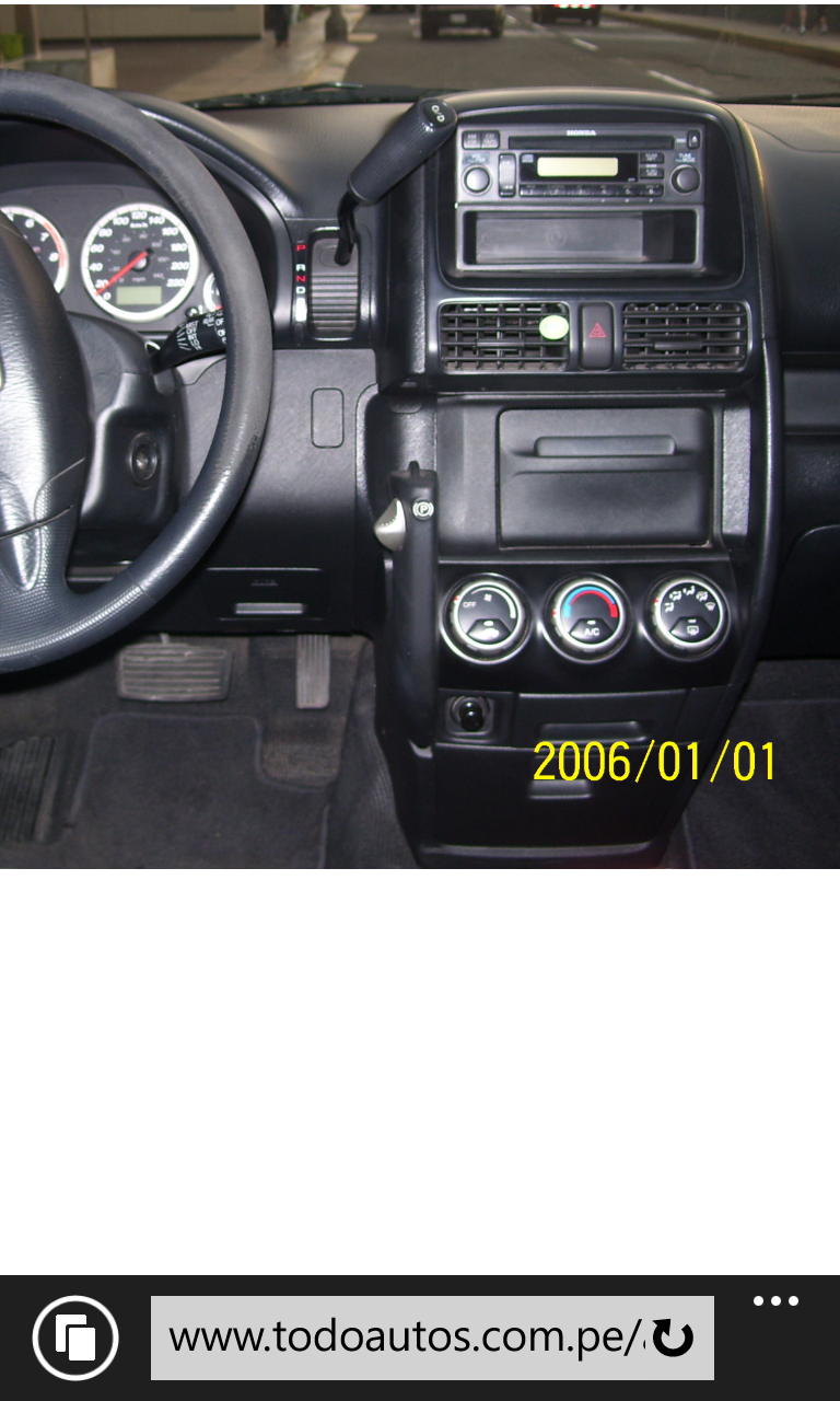

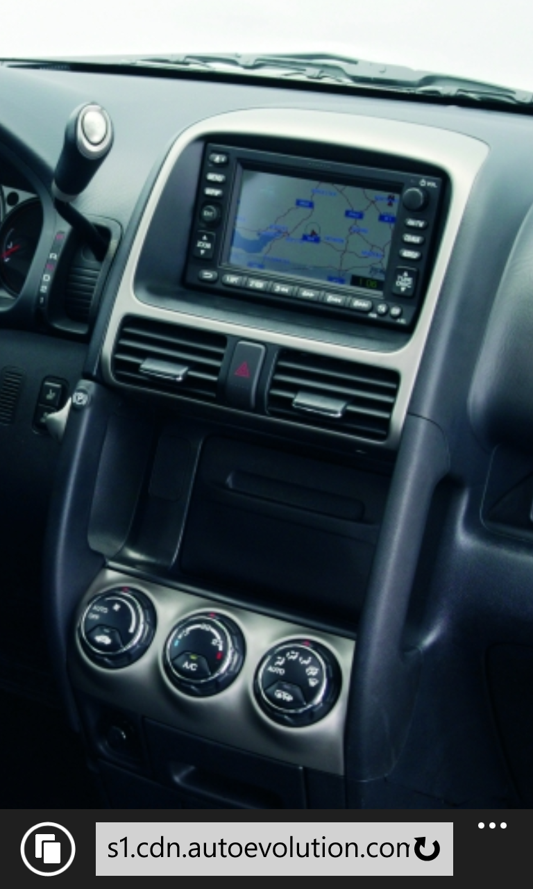

These pics aren't of mine, but you get the idea.
This is what mine is like:
This is what I want it to be like:

  Clio 182
Itll be a direct fit - if the cage doesnt fit in the slot, then you will have to use brackets frm factory hu, the gap might not be too bad - but you could try a universal trim if not happy, all youll need it harness or stalk adapter and your good to go [emoji106]
