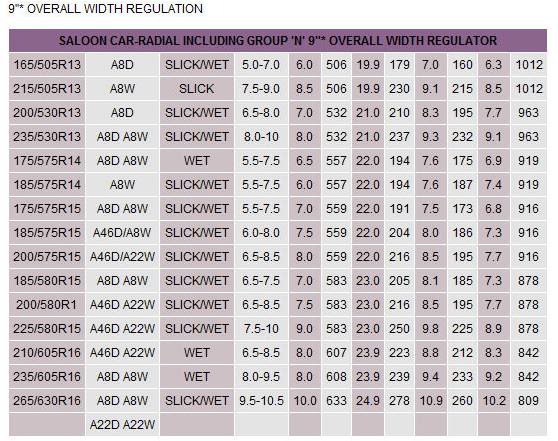

can get a set of Dunlop slicks for a very cheap price, i have been sent this and been told to pick which i want. I have no idea what they mean, which should i go for? lol! using 15" speedline corse alloys

non of those sizes look corect for your clio m8

would a 185/575 be too skinny? and 200/575 be too wide?

i ran 205/50/15 R888 on the front of mine for a bit which would be the same as 205/580/15 so 200/575/15 would be fine mate
if you are looking for a pure slick then go with what i said, if you want road legal then you would properly have to use 195/55/15 D01J

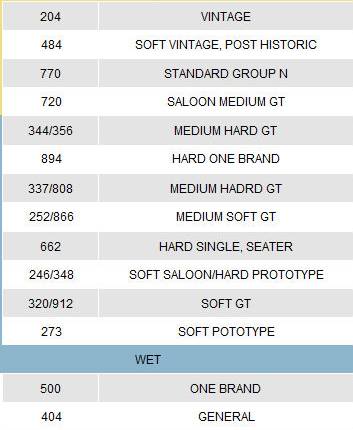

what compound should i be going for?

Hi i use 200/580r15 slick A46D 720 . They are the hard compound but once warmed up you can carry so much more speed round corners you'll think why did'nt i get them ages ago.
When the set i have wear out i'd go for the mediums so it doesn't take so many laps to warm up.
the 185/575 is the old clio cup size if i remember rightly

Me personally i'd go for the 185/580/15, the footprint of this tyre is 205mm the 200's have a 216mm footprint

I just got a set of 200/580/R15 off ebay, not sure on the compound. Seemed the closest match to 205/50/15 when looking at the dimensions. Can't wait to see what difference they make :)
