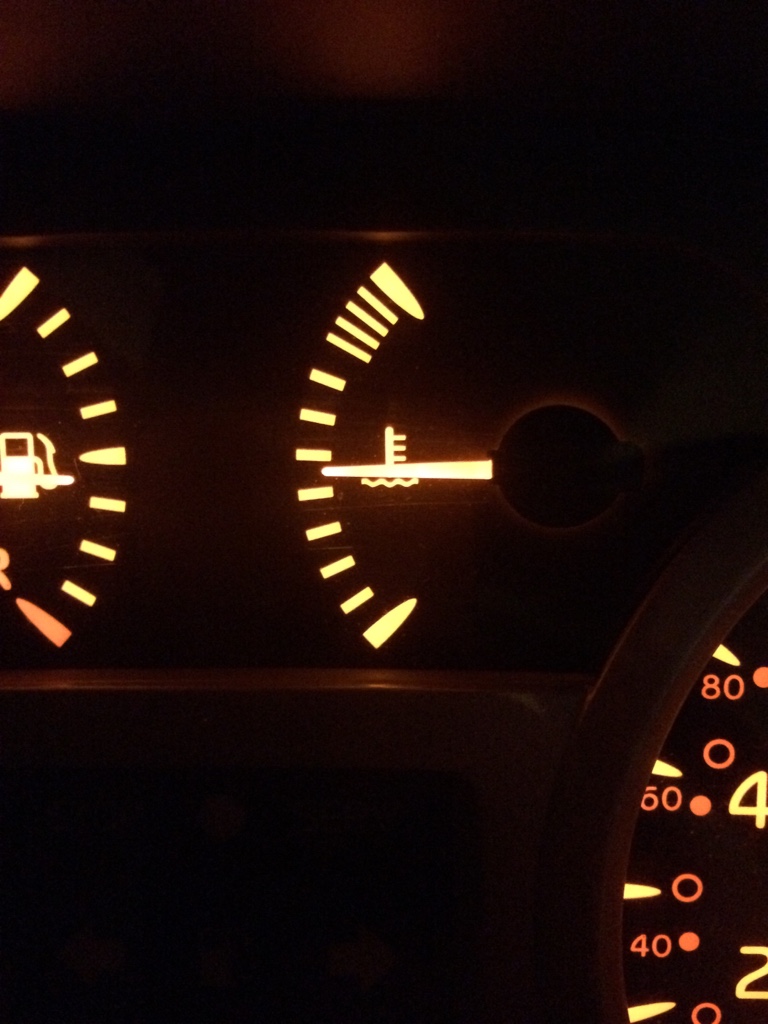

Cheers folks. Did the same again this morning - seemed to warm up a little slower than usual (it was -3 here though), then warmed up fully to temperature. Then, at the traffic lights, it dropped to this (see photo) for a while and then went up to full temp and stayed there.
On the way home it was completely fine.

Definitely Thermostat.... I've just replaced mine, it was doing exactly what yours is, now mine runs dead middle as it used to... :up:

a sign of thermostat is then temp drops when driving but car warms up when stationary as radiator isn't cooling.

Your thermostat has a little rubber ring for sealing it when closed, over time it will perish a bit allowing coolant to circulate even when thermostat is closed. I had exactly the same. I replaced the thermostat and now all is well.
