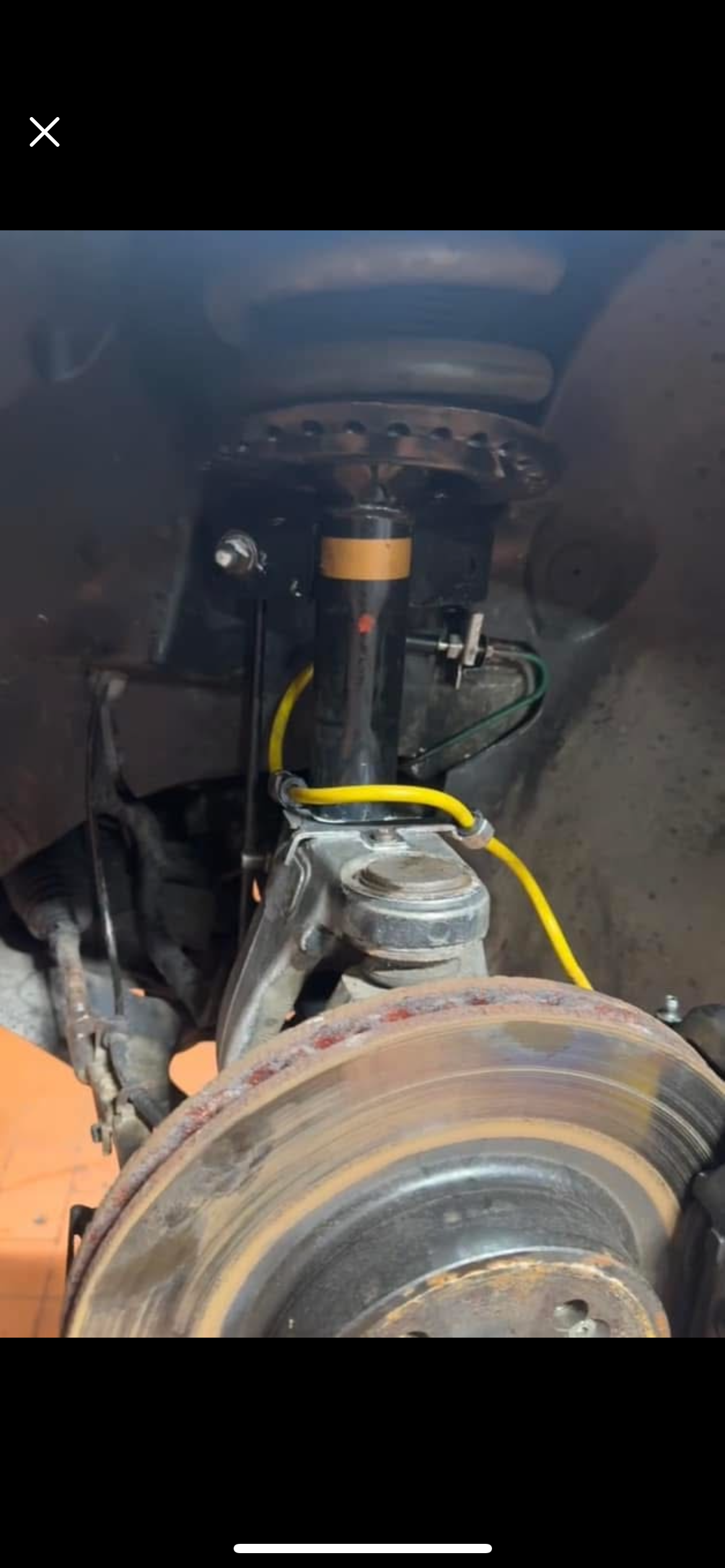

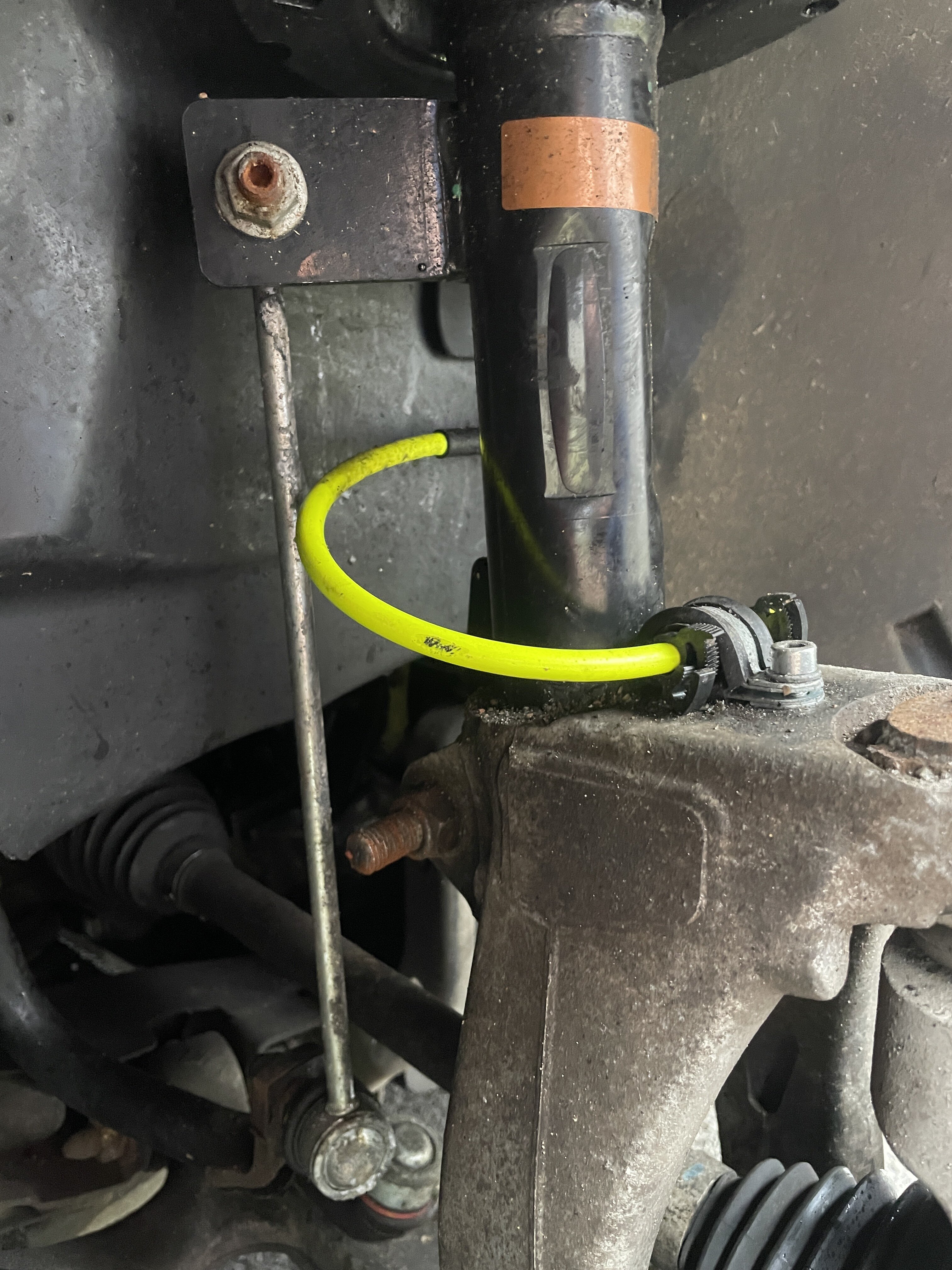

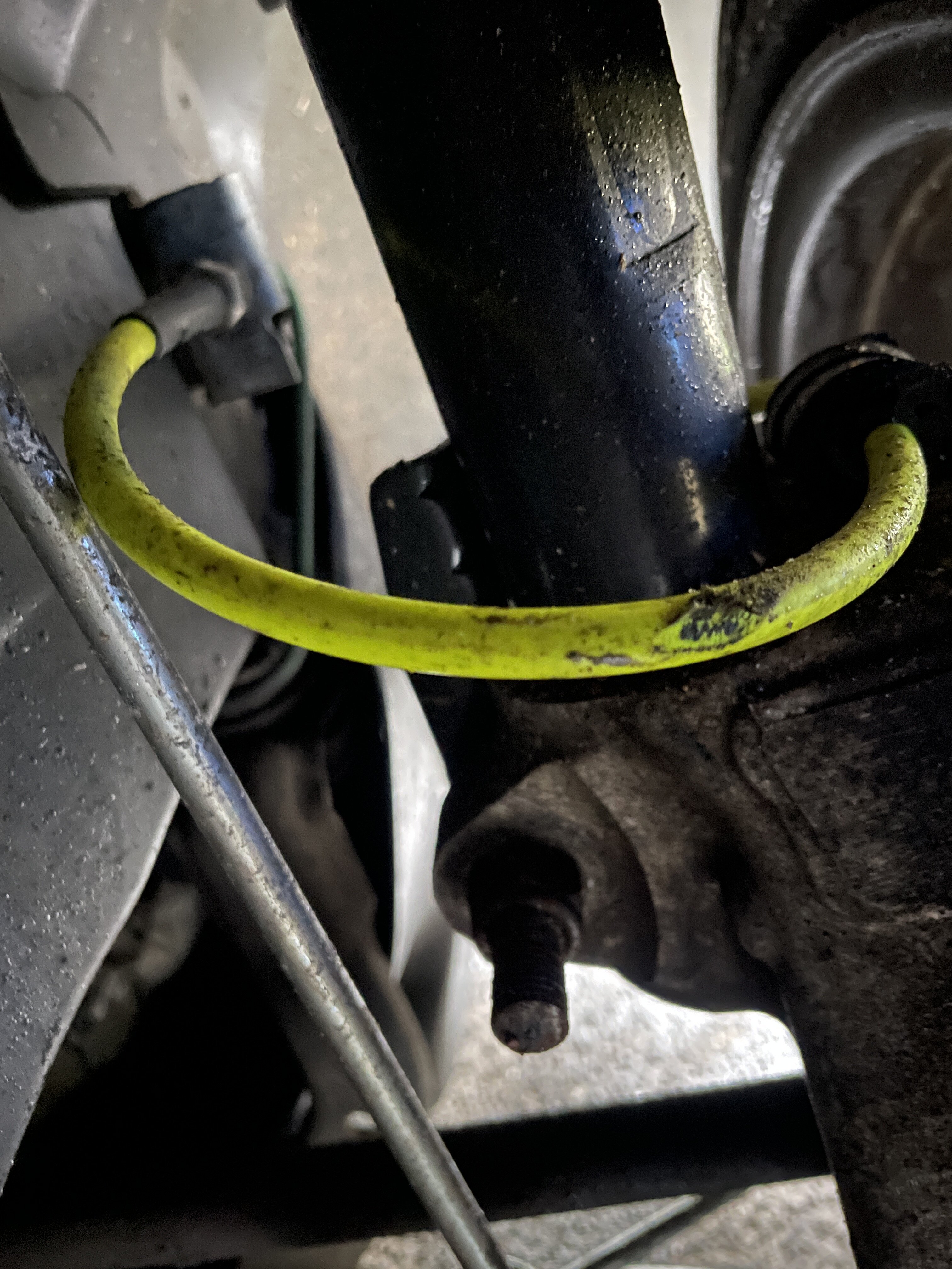

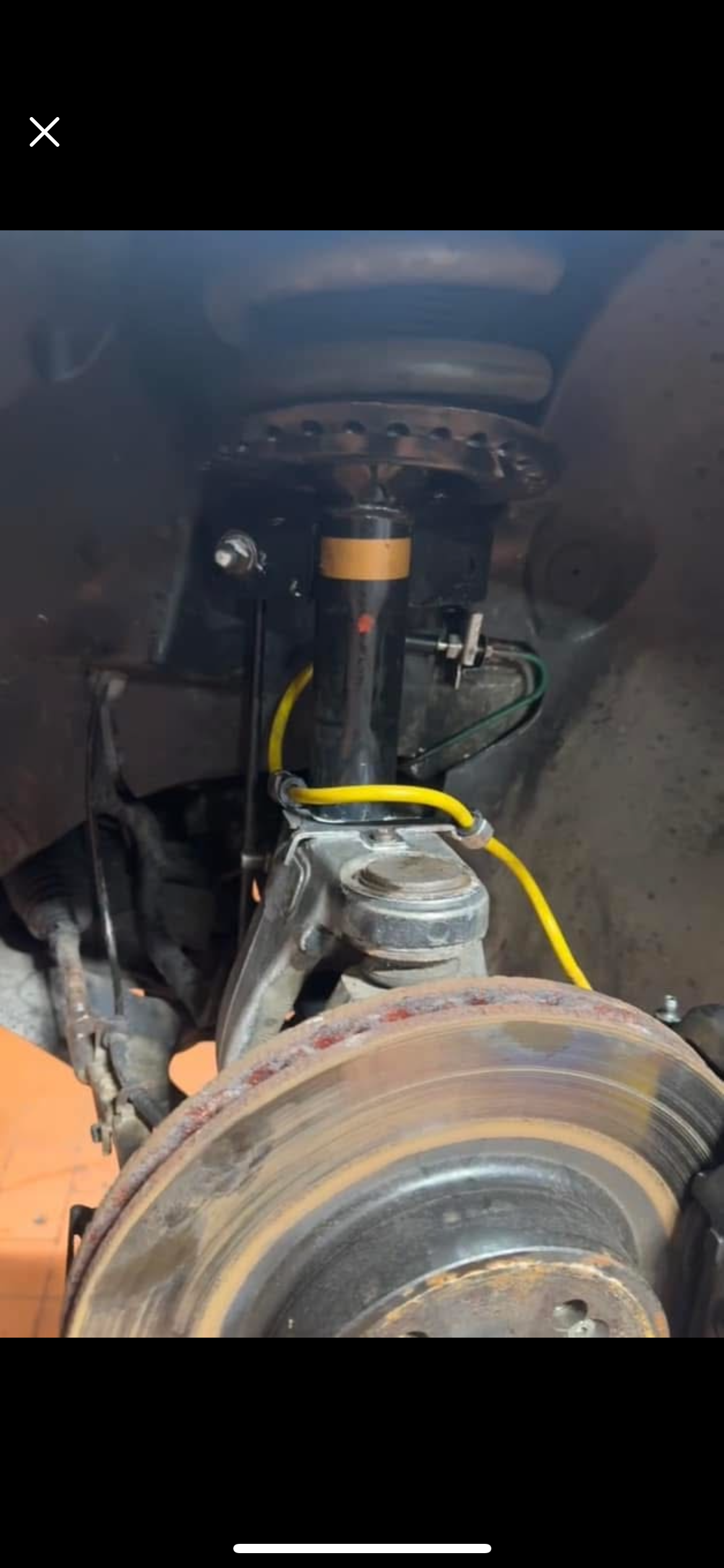

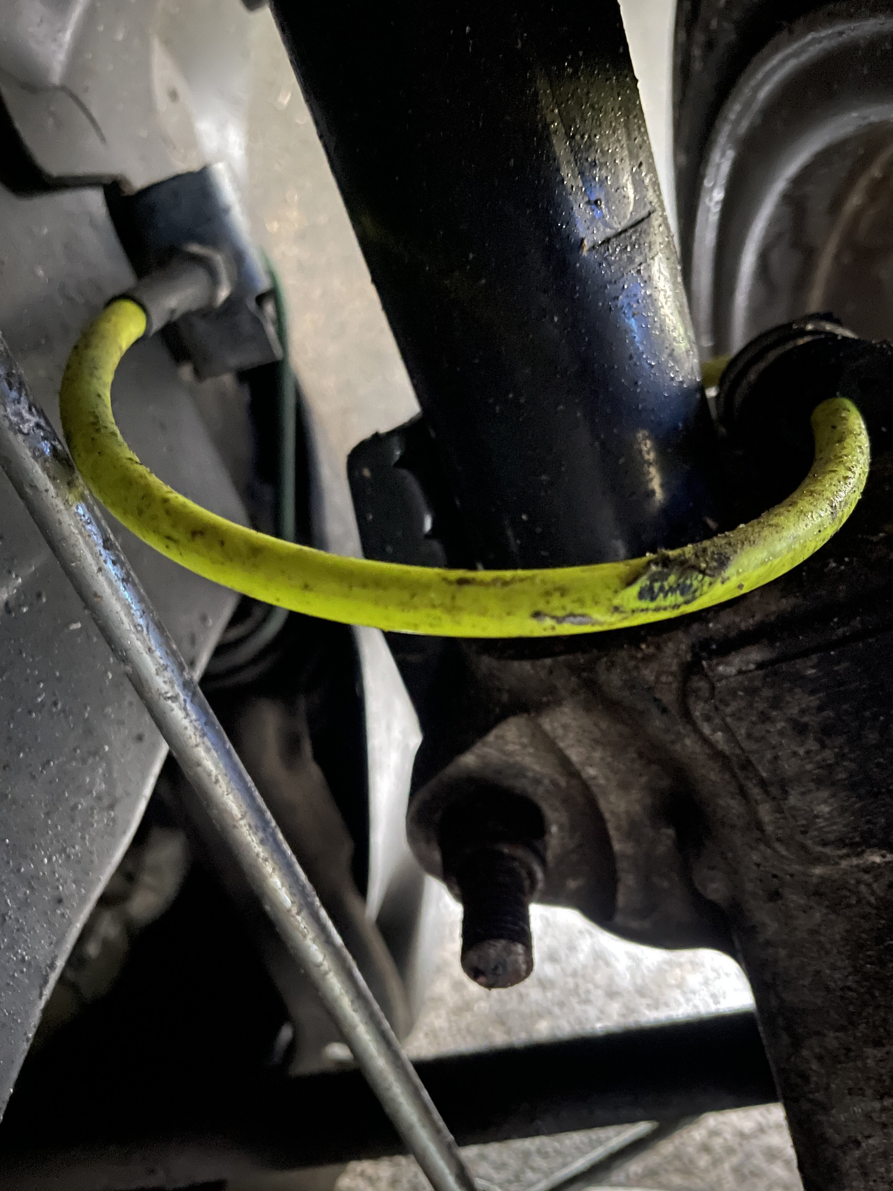

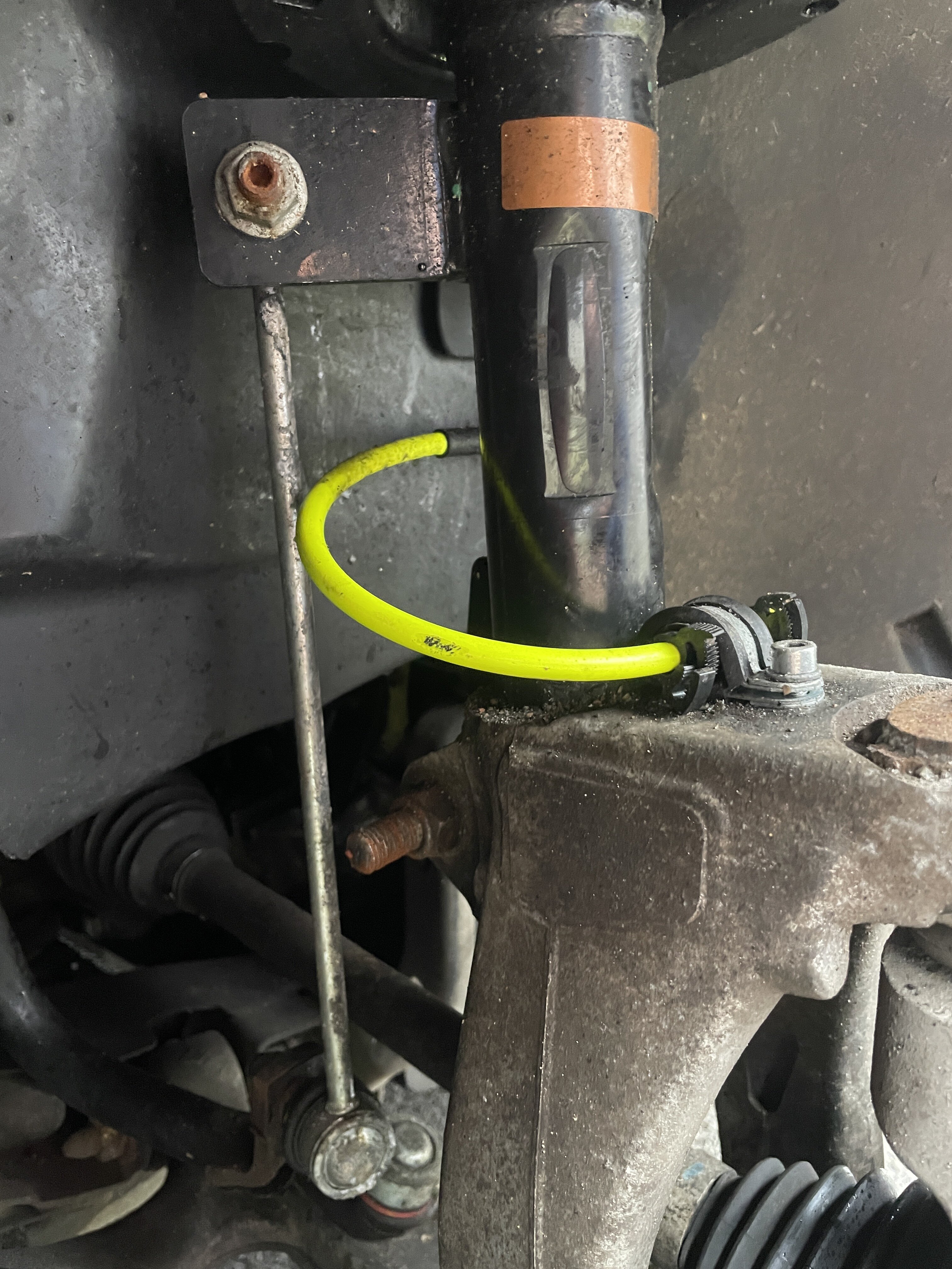

Talk about the brake lines they also fitted that turned out were rubbing on the tyres...
Brake lines should be fitted with the bracket:
where mine was fitted, the photo was taken on the second day collecting the car with new line and rear brake calipers fitted. Luckily the rim didn't rub through the line
