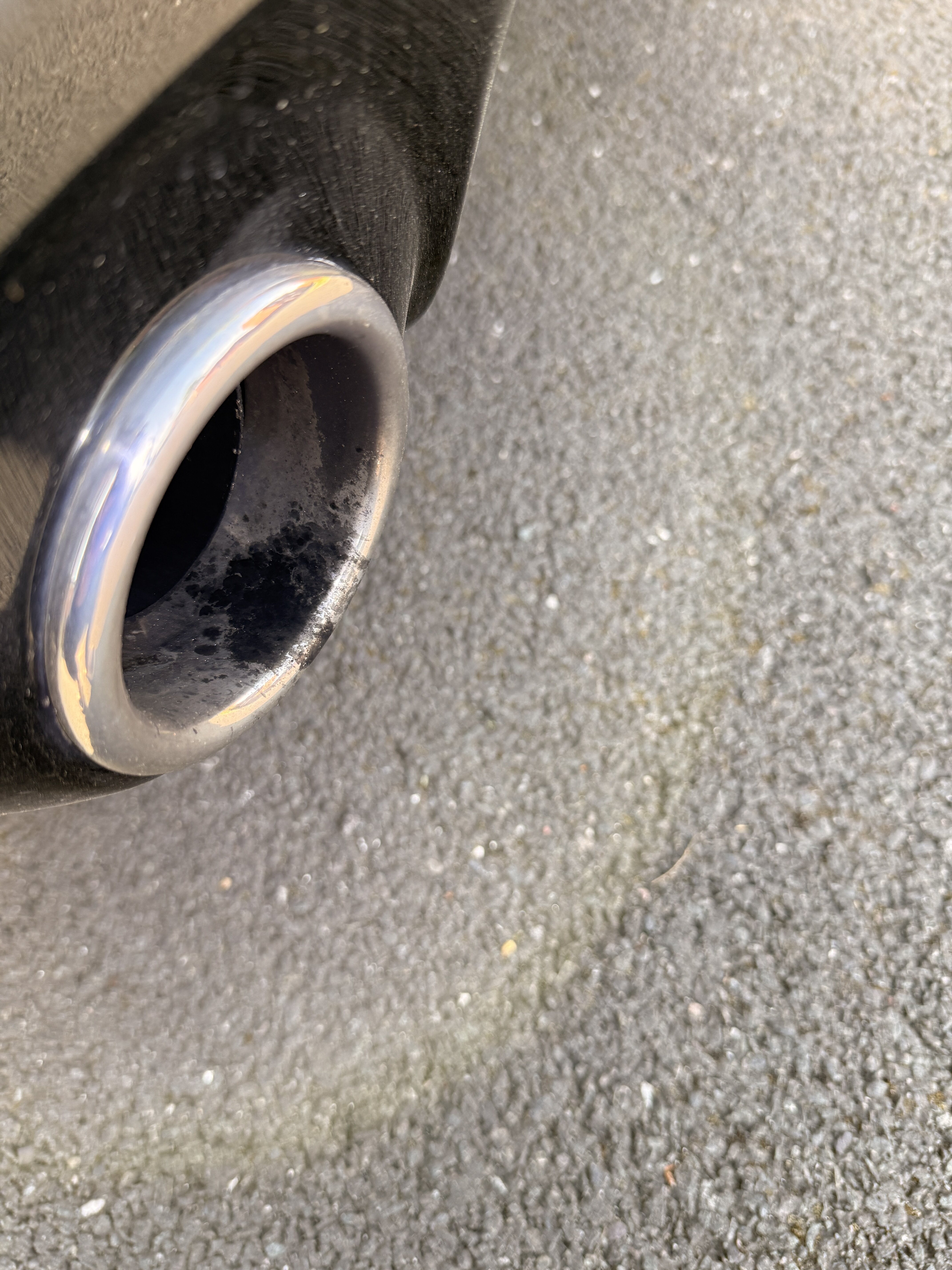

Back of the van had loads of little black flecks over it. Yours got the same?? How sooty is the tailpipe?
Personally I’d be contacting the person/s you paid £3,800 to and put the ball in their court. But my spidey senses tell me they’ll fob you off.
Tony_HH
My 182’d van was burning oil at a rate of 1L per 1500 miles and that’s excessive.
Is that the black flecks as mentioned?
Daniel
  Whichever has fuel
Wipe the back of the car down with some QD and a cloth.
Get it up to temp and do a few laps of the local dual carriageways, make sure you hit the limiter a few times. At least 30 mins of spirited driving.
When you get home, wipe a clean cloth along the back window (don’t want to damage the paint!) and I bet it will be covered in black dots.
But your exhaust looks very similar to my van.
Doesn’t look good. 😢

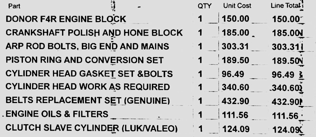

Does the itemised bill mention machine work?
Tony_HH
Could be the block needed boring and they didn't bother/bother to check and rebuilt it anyway. Maybe they thought they'd get away with just a quick hone.
Maybe they didn't even bother with that and re-assembled the thing.
Yes, it mentioned machine work

I don't understand how, from the itemised bill - that it's missing an oil pump, water pump and more that you'd expect to be on there, nor does it add up that it's £1620 more than a rebuilt lump from Engine Dynamics.
If it's chugging 1L of oil post rebuild in just 1200 miles, I'd be going back and insisting they fund a proper rebuild elsewhere.
No freshly built engine should be using that much oil. Ever.
For what you paid, I'd be kicking off.
