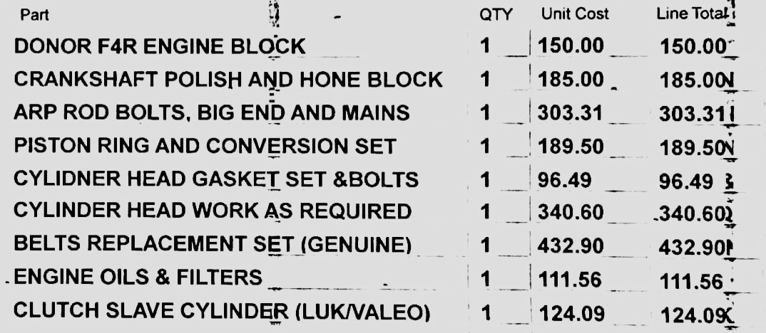

I don't understand how, from the itemised bill - that it's missing an oil pump, water pump and more that you'd expect to be on there, nor does it add up that it's £1620 more than a rebuilt lump from Engine Dynamics.

If it's set you back £3800 all in my dude, a rebuild from ED is £2182 for a standard engine refresh - £2500 for a "level 1" build - £3200 for a "level 2" build.
So I'd be marching back and demanding answers as things aren't adding up.
Did you buy them the oil pump and water pump?

You'd hope so considering they're pretty vital parts. However they're not part of the belt kit hence my suspicions that they've not been replaced as they're not on the itemised bill. You wouldn't want old units going in to a fresh build.
They're replaced on ED's basic build/refresh.

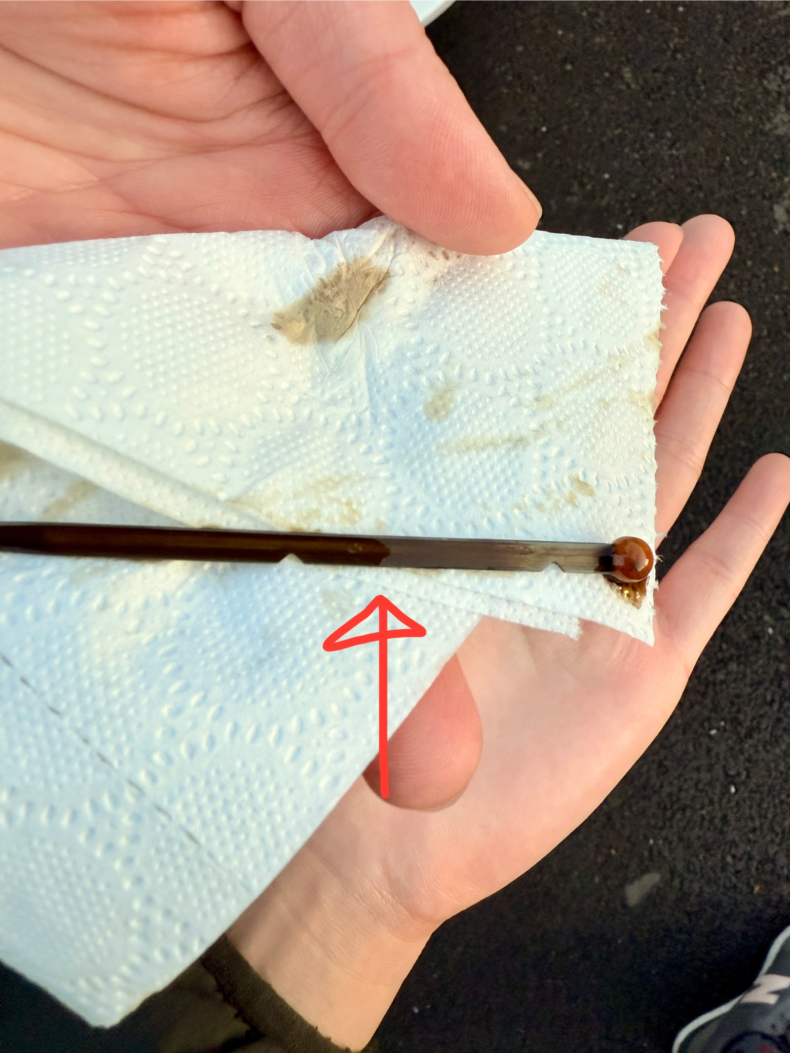

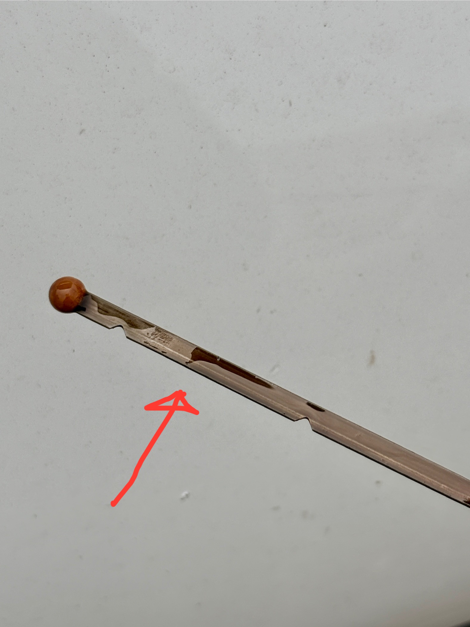

Last week oil level after filling 1.5L:
Today's level after doing around 320miles, sensor shows half is gone
