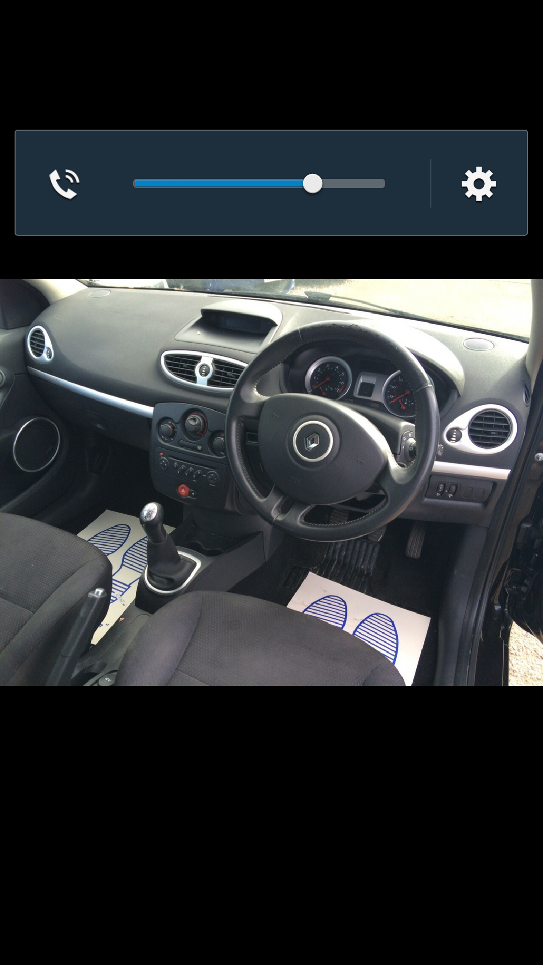

ye basically what the title says.. I was driving and behind my steering wheel smoke started to come from it!.
My stereo stopped working and the information on the dashboard were my clock and temperature are stopped working aswell.
I then noticed I couldnt turn my wind wipers down, it was sticking and couldny move it.
I was lefted with a nasty smoking smell in my car.
has this happened to anyone else on here?
how do I fix this lol

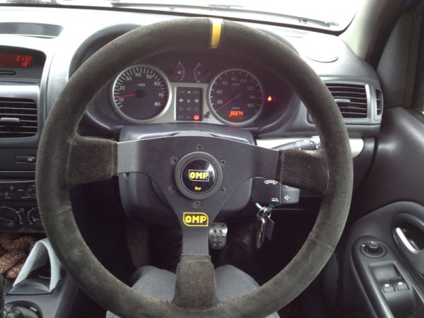

Do you have an aftermarket steering wheel fitted? If so, the horn wiring may have shorted.
Does it look like this?
Or this?
Unsure then, looks like you will need to get the steering wheel and shroud off and check the wiring for faults. If you have that much smoke you will probably need new wiring any way.
