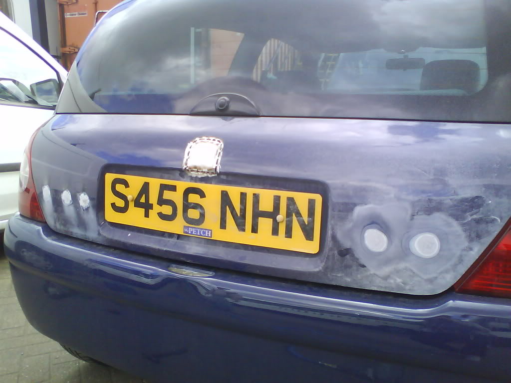

took my badges off today....there are 3 pinholes in need to fill and the actual holes are sticking out
any of you done this before could advise me how to do it??

i smoothe mine mate, mig welded the holes, you can use filler, but may crack mate

first you wanna hammer the holes down so they are slightly dented as they sit proud from factory.
if you aint got a welder then stick something on the inside of the tailgate to cover the holes, old credit card etc then fibreglass, filler, prime, paint as normal
