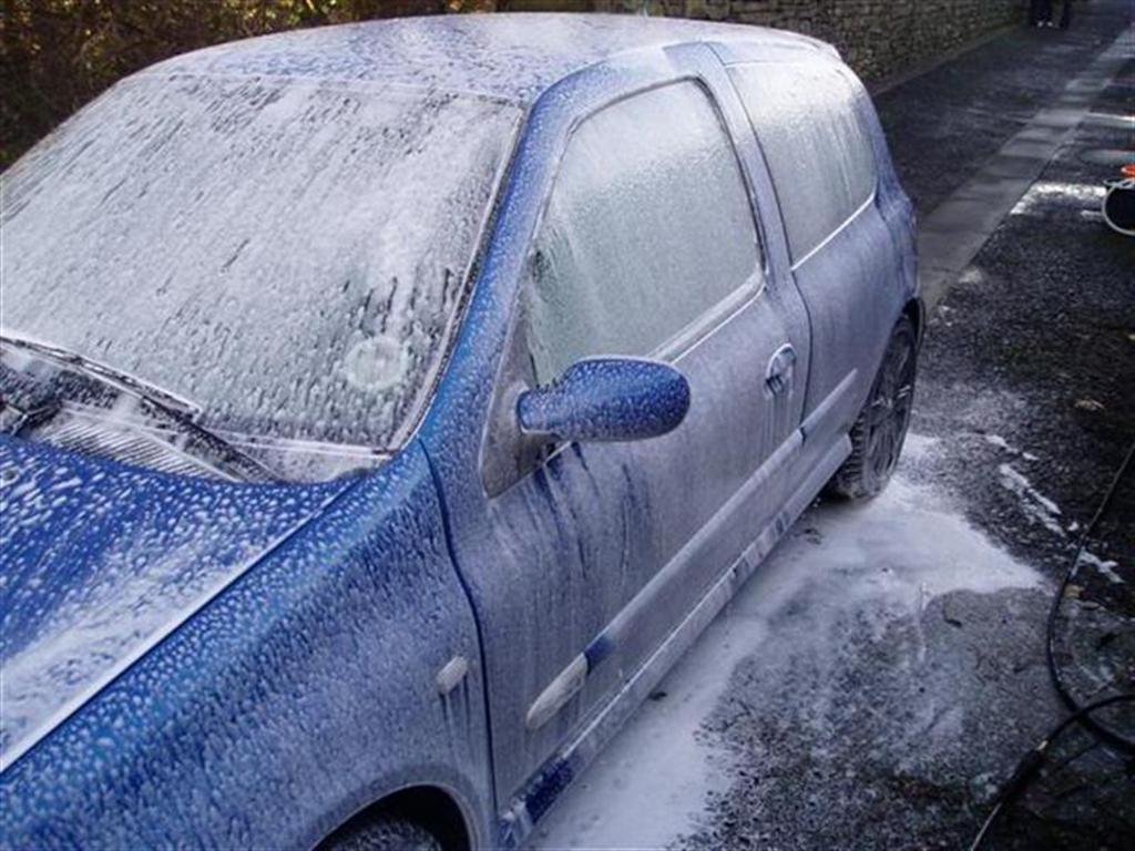

Sprayed it earlier and this was the result:

The thing you're using is just a shampoo spreader. It's not a foam lance.
Buy a proper lance if you want proper foam.
You won't find them in the shops.

Pretty sure you'd have to order one unless you live near a detailing place that happens to be open.
Doesn't look a bad effort from the pic.

That's not the best foam in the world, but it's a hell of a lot better than the foam you get from the standard attachment! Good work!
